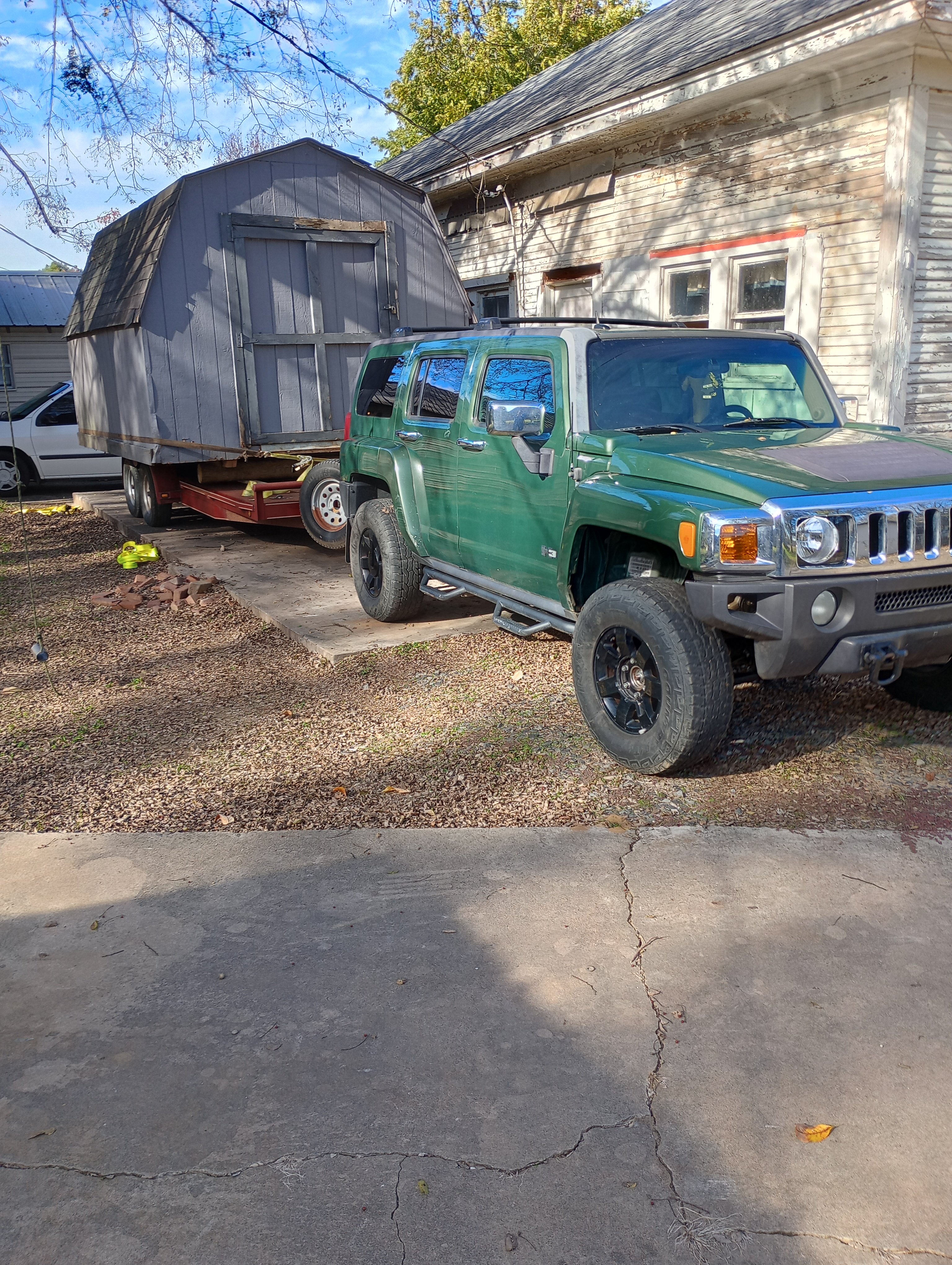

Number 12 fuse blowing, lights not working on the buttons on the dashboard for the four-wheel drive stuck in front wheel drive only 06 h3 change the four-wheel drive transfer case motor

Start chasing wires, I’d start by unplugging the tcase motor plug, put new fuse in, check if it blows, if it doesn’t, it’s past the plug, if it does then keep chasing it up the harness

Okay thank you very much for your help seems I've got the number 12 fuse problem fixed it's not blowing now with a 30 amp fuse but I'm still getting a traction failed service stabilizing system indication on the instrument clusterwith no indication of what gear I'm in on the four wheel drive system on the dash any help would be appreciated thank you
