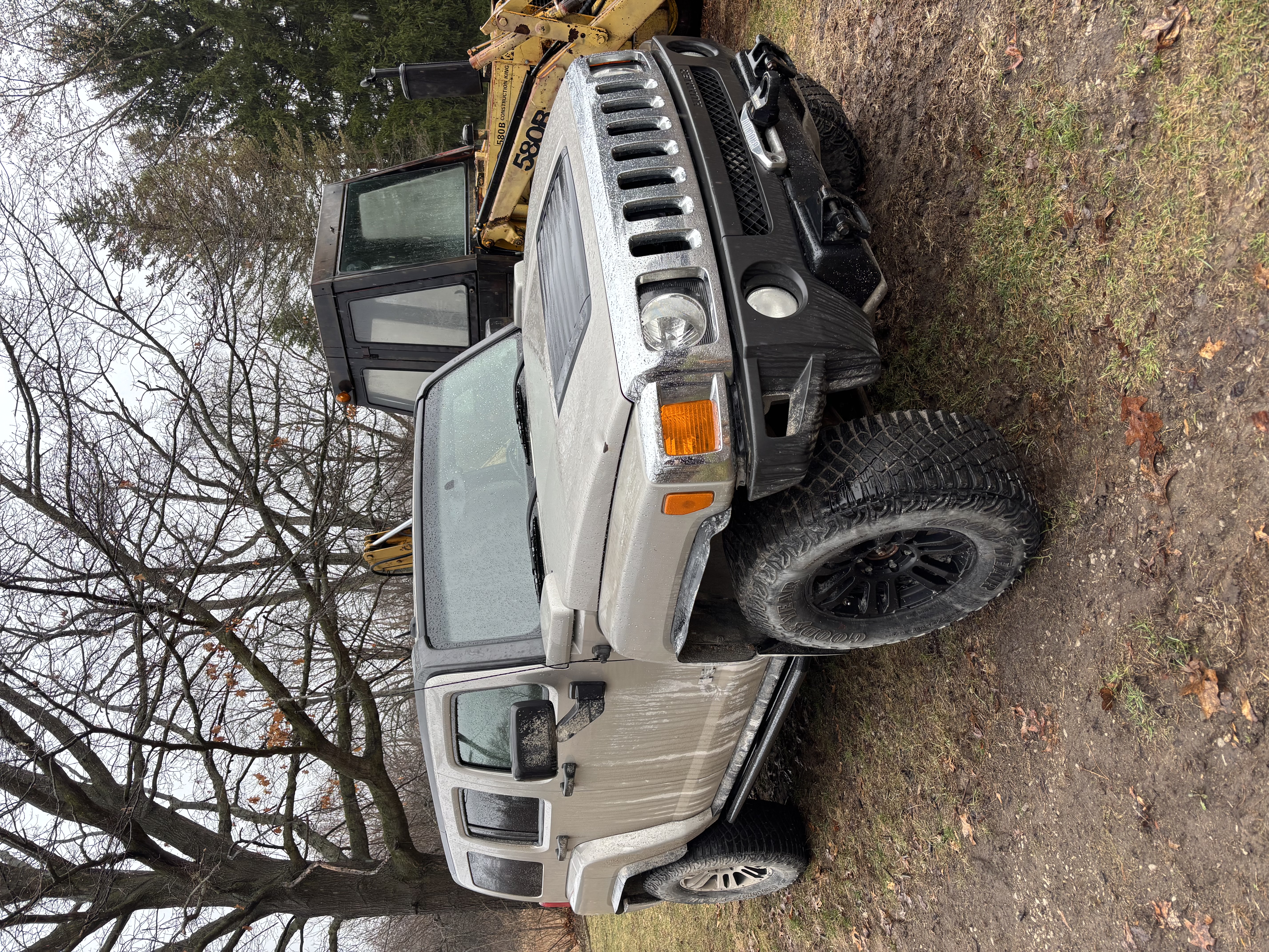

I have 17x8.5 25mm offset running 315/75R17 tires. The picture you posted shows wheels that will probably work, but make sure the hub diameter is at lease 4”. The H3 and first generation Colorado/Canyon had bigger hub diameters than any other GM product, even though they shared the same 6x139.7 lug pattern. This is an awesome resource for wheel/tire fitment questions -> https://www.wheel-size.com/calc/

jdyonker. The pic you posted looks like +25mm. Not -25mm. That might just be the angle of the photo fooling me though. Agree on the hub-diameter. I recently discovered hub-centric rings that make Nissan-sized wheels fit safely, More options opening up.
