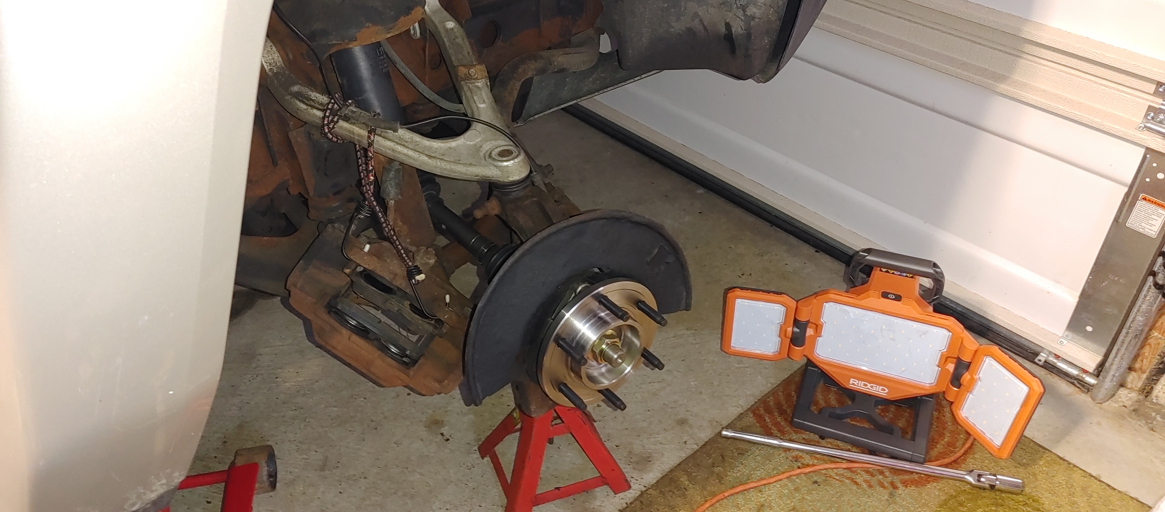

Thanks for your reply! I have changed both front CV shafts along with wheel hubs. I did drain the Front diff fluid and found it clean, I am now taking off the drive shaft to inspect. In the video it is very visible the "movement" of the bolt holding the diff to the cross member so I ordered new polyurethane bushing.
