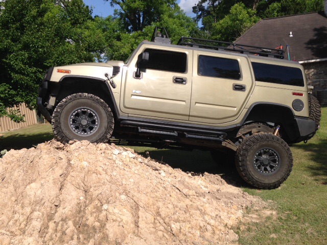

Okay I need some help. Should I go with a 4" or 6" lift. I plan to put 38" tires on her, but don't know whether I should go bigger or not. Sometimes bigger isn't always better.

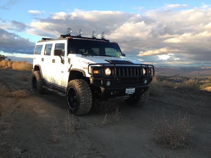

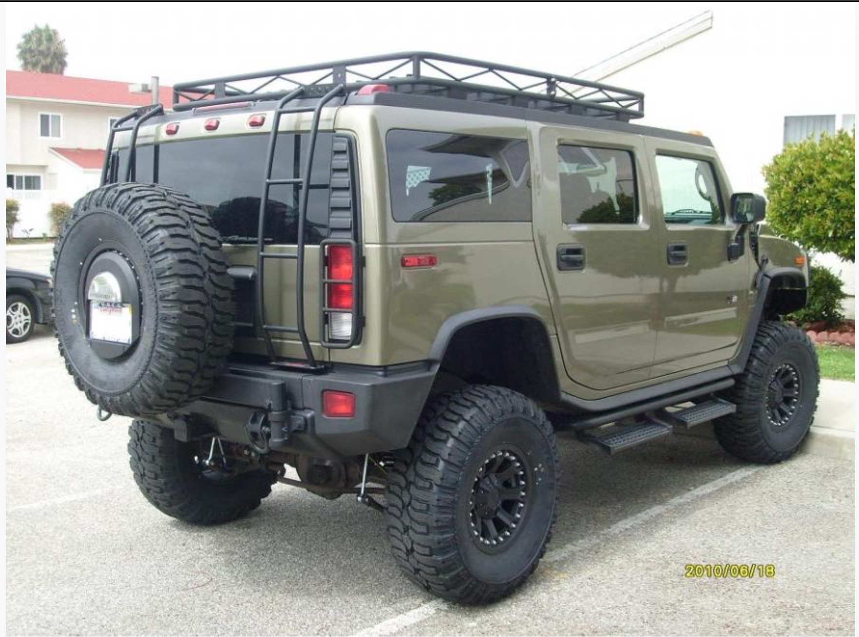

I run a fabtech lift on my rig with 37s and I would like to upgrade to 39s in the future so I am glad I put the lift on my rig.
