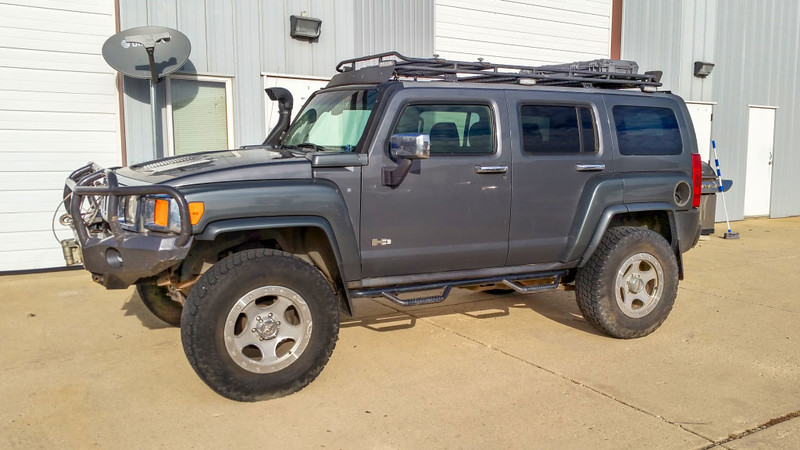

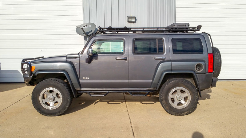

After searching for 6 solid months this is the one I chose:
2008 Hummer H3 Alpha 5.3L w/ 250K Miles - Techno Gray Metallic
OEM Features
· Lux Package
· Adventure Package
· Tow Package
· Backup Camera
· Navigation system
· Sunroof
· Monsoon
I think it has every option except the OEM Rooflights/Marker lights and OEM fog lights accessory.
A Bit of Background On The Truck:
Previous owner travels the country for work and tows this vehicle everywhere he goes. That explains the miles. He is the second owner. Bought it at 11k miles at auction. About 3 years ago he got a new truck and this one has just been sitting at his house only being driven short distances. The guy said he hasn’t had the time to fix it so he is selling it stands. Plenty of things that need to be fixed but this were definitely the best H3 Alpha I found after months of searching that was loaded and had tons of aftermarket features (For a reasonable price).
All aftermarket accessories:
· Road Armor Front Bumper
 (Painted gun metal gray, will be painted black)
· MileMarker 8k lb winch
(Broken)
· PIAA 510 Fog lights (36w)
· ARB Snorkel
· Chrome Runcool hoodlouvers
· Electric cooling fan
(OEM fan has been removed, this thing is loud)
· Rancho 4in lift w/ rancho shocks
· GEAR 18in wheels &34.5in (295s) Nitto Terra Grapplers - 70% tread
· Gobi roof rack w/ ladder& sunroof insert
· Low profile lockable Pelican case bolted to Gobi roof for extra storage
· N-FAB side steps
· Color matched fender flares
· LED lights on all sides(None are connected)
· Aftermarket tow braking system
· Aftermarket Third External Brake light (Doesn’t Work)
New in last 50k miles:
· Front differential - AAM8.6 (Even though this is an early model 2008!!)
· CV axles
· Hubs
· Transfer case
· Front & rear drivelines
Even though this truck is fully loaded, I must admit that the overall condition isn’t great. Not complaining but these things will take time to fix. I did know going into this purchase that it had 250kmiles so it wasn’t going to be perfect, but there are just a bunch of little things that you don’t think about that are out of whack.

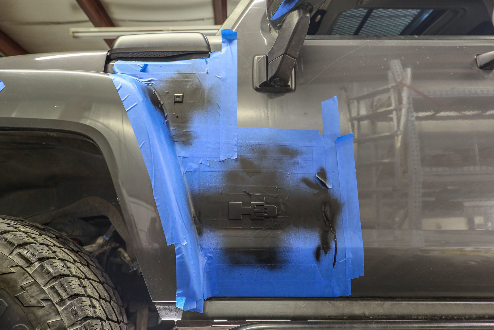

After that was finished I removed the E&G Classics fender flares. I know some people like them, but personally I don’t like the look. I figure that would they would be a great place for mud to get trapped in.
Taking Off E&G Classics Fender Flares

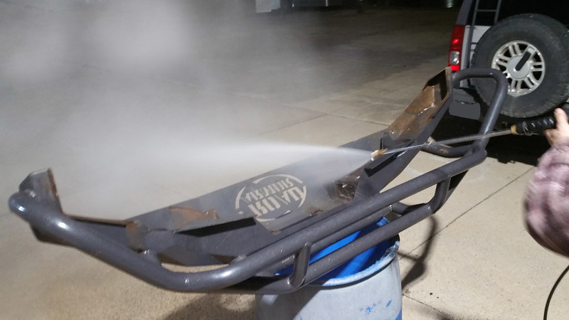

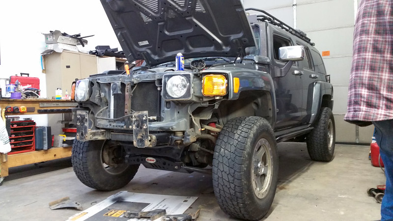

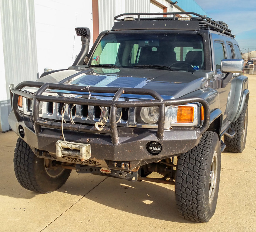

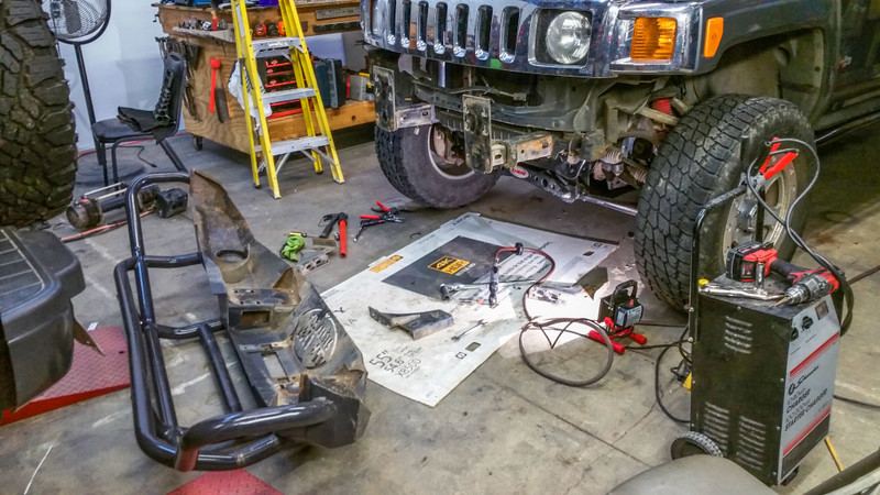

Taking Off The Road Amor Bumper For Paint
The paint on the Road Armor bumper was in poor condition.There were scratches, rust spots, and paint chips. On top of that, the color did not match the color of the truck. If you look closely at the pictures, you will begin to notice the difference. The RA bumper had a gun metal gray look while the H3 had a gray color with some blue mixed in it, so it need to be painted.
I figured I would just do flat black because it would be too hard to color match. While doing this I could also put on my smittybilt winch. Doing this was far worse than I ever imagined. Unless you have a ton of patience and a good chunk of time, don’t even bother if you can get your hands on one. I love how sturdy this bumper is but absolutely hate the way it was engineered. To take it off you have to unscrew somewhere around 20 bolts. It wouldn’t be that bad if the bolts were easy to get at, but they were far from it.
Tags: Hummer H3 Dakar Road Armor Bumper, Hummer H4O, Road Armor, Install, Hummer H3 Rocky Road Sliders
Acer4LO
Illinois
Hummer H3 Road Armor Bumper
Prep + Painting Road Armor Bumper & Reinstalling
On top of that when you go put it back on, it is a puzzle.Took me three different tries to figure out what bolts need to be tightened first. Also it is near impossible to line up the bolts. I was just about to finish by putting on the last D Ring mount, but it would not line up no matter what I did. In order to fix this I literally had to unscrew/loosen every bolt on there. In total it took about 10 hours to take off and put back on. (This excludes washing, sanding, and painting.) Lining up the winch wasn’t fun a tall. A lot of trial and error went into getting it properly mounted.

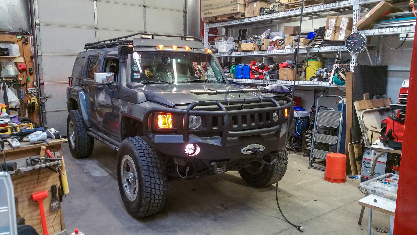

Adding 12k Winch
All that being said, this bumper is incredible. It is truly an extension of the frame. I needed to move the truck a little bit in the garage, so I put it in neutral and pulled it by the bumper and felt like I was pulling the frame. I know this bumper is typically apart of the high dollars how truck scene, but it definitely feels like this would be at home in the 4x4world.

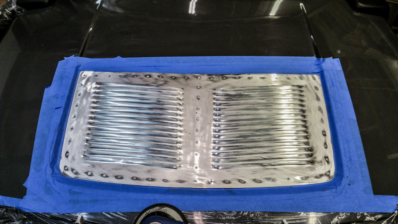

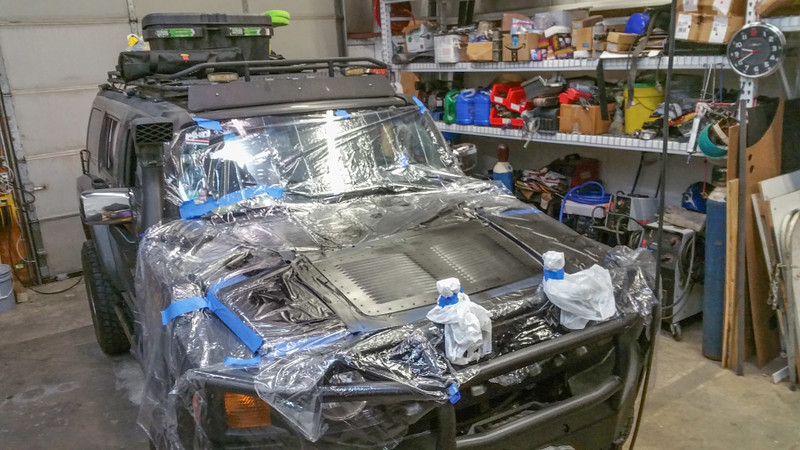

Painting Runcool Hoodlouvers Black
Once that whole bumper fiasco was over I wanted to take it easy, so started to de-chrome the truck. Took off the handles and painted.
Following that, the hood louver. Again, not too hard but tedious. Obviously you can’t remove the louver since it is riveted down, so had to do a careful taping job and then sand each individual vent/blind thing. Very happy with the final result though!

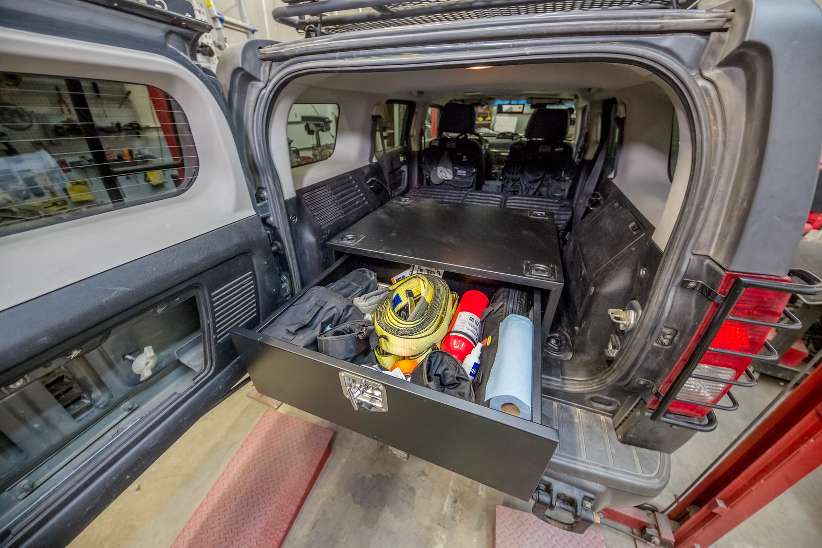

Adding A Rear Storage Drawer
Found a rear cargo drawer solution! Ever since I saw the AMSTAR prototype drawer that never came to the market I have been looking to do something similar for a reasonable price. Only problem is that almost every automotive drawer company wants over $1000 for some type of setup (Mostly police application). Looked on amazon and found this:
https://www.amazon.com/Smittybilt-2...d=1517818707&sr=8-1&keywords=smittybilt+cargo
It was a bit of a stretch, but I measured it before hand and in theory it should fit. When I got it, the drawer fit perfectly! Made same L brackets and bolted down using factory tie-downs.

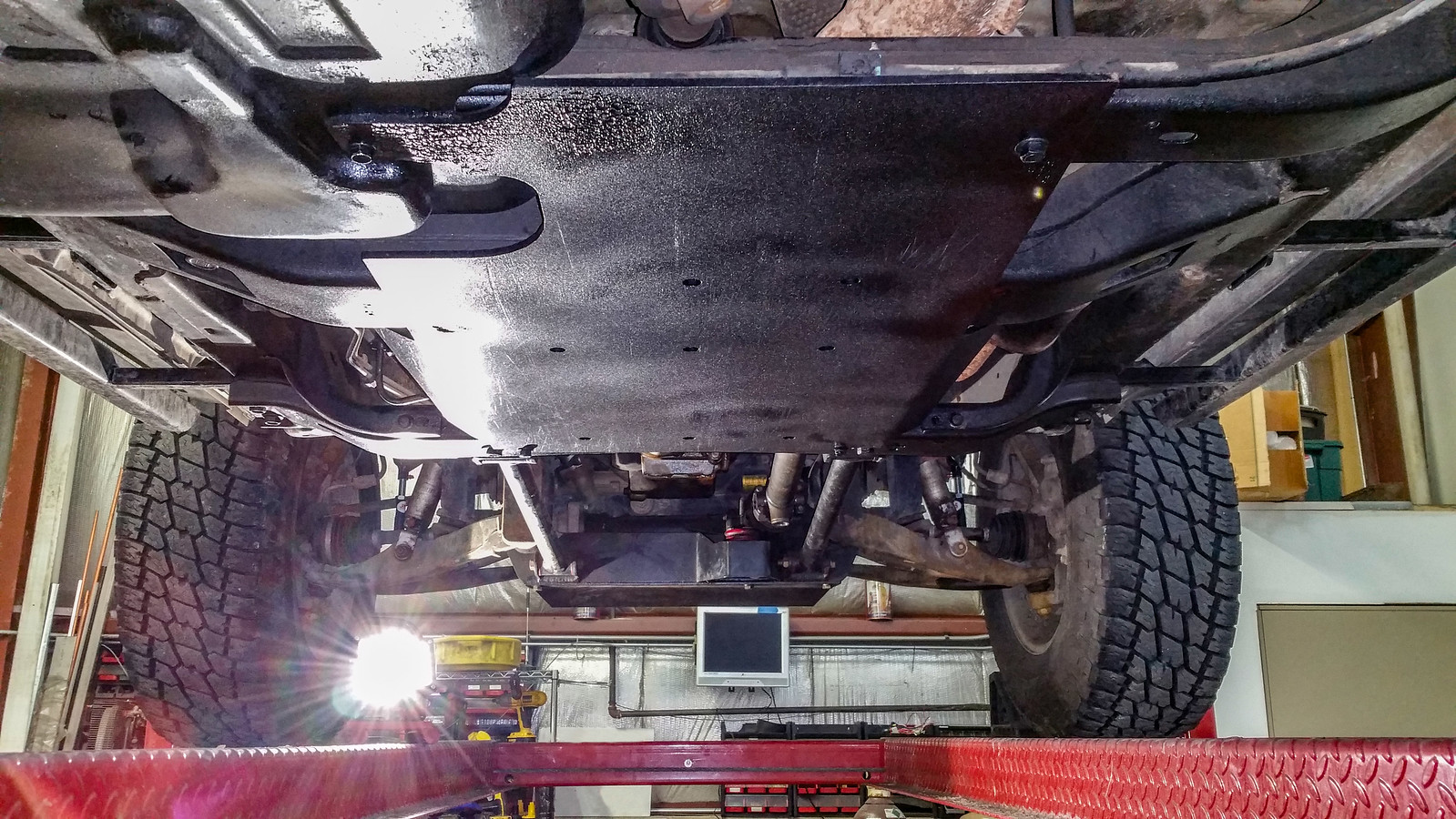

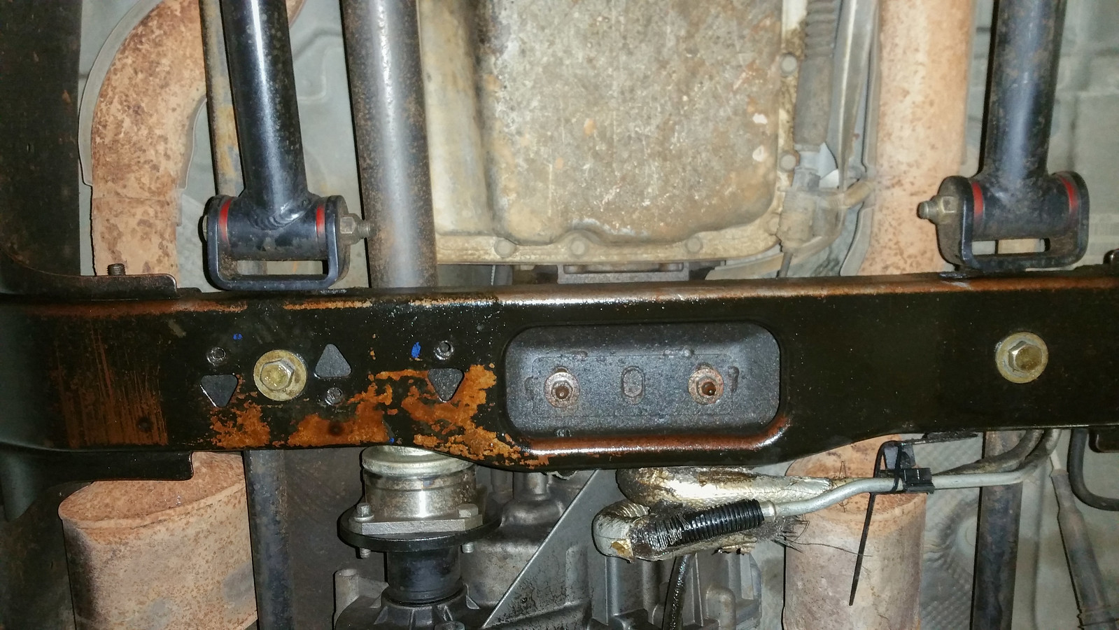

Rear Skid Plate Install
Was able to install Schwarttzy's rear skid plate to the crossmembers. Just required a bit of cutting and mounted it right up. (And re-sprayed) Alright this is weird on Waysub's alpha the links for the lift kit are connected to the bottom of the cross members, but mine are on the side, so I am able to add the rear skid plate, but he would not be able to. (Unless we did a lot of cutting) Any one know which is the correct way?

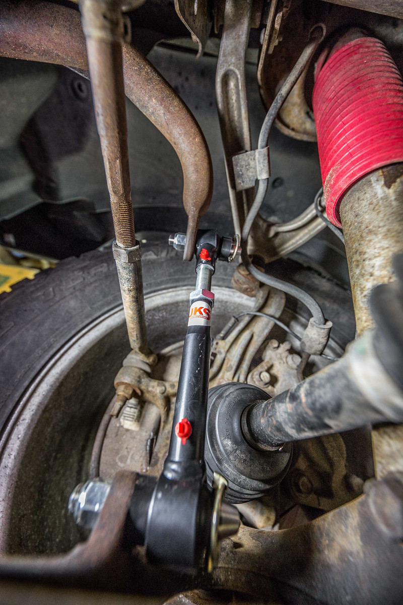

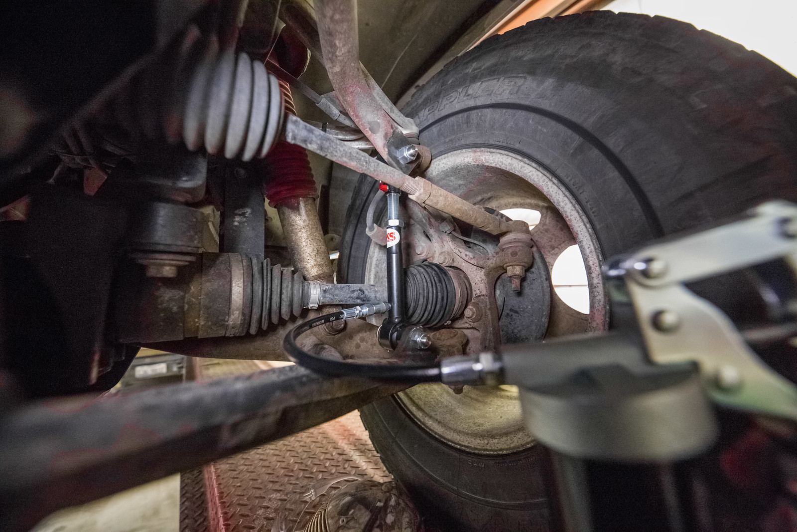

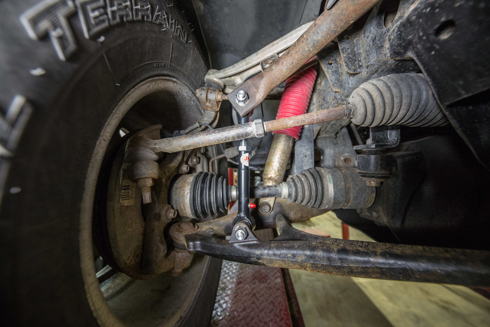

Front Quick Disco Sway Bar Links
Installed the JKS 2001 Front Disconnect Sway Bar Links. Super easy to install. Simple as lining up the new ones to the old ones
(Cherokee XJ & Comanche MJ, 1984-2001, Quicker Disconnect, Fits 4.0"-6.0" Lift)
http://jksmfg.com/i-13306724-cherok...001-quicker-disconnect-fits-4-0-6-0-lift.html
I needed to buy these extra parts for it to work:
[2x] Offset Polyurethane Spacer (M03212-BK-01)
[2x] 1/2" -20 Nylock Nut (37130)
[2x] Stainless Steel Post (A1046)
[6x] Click Pin (03005)
Had to grease them up!
Done

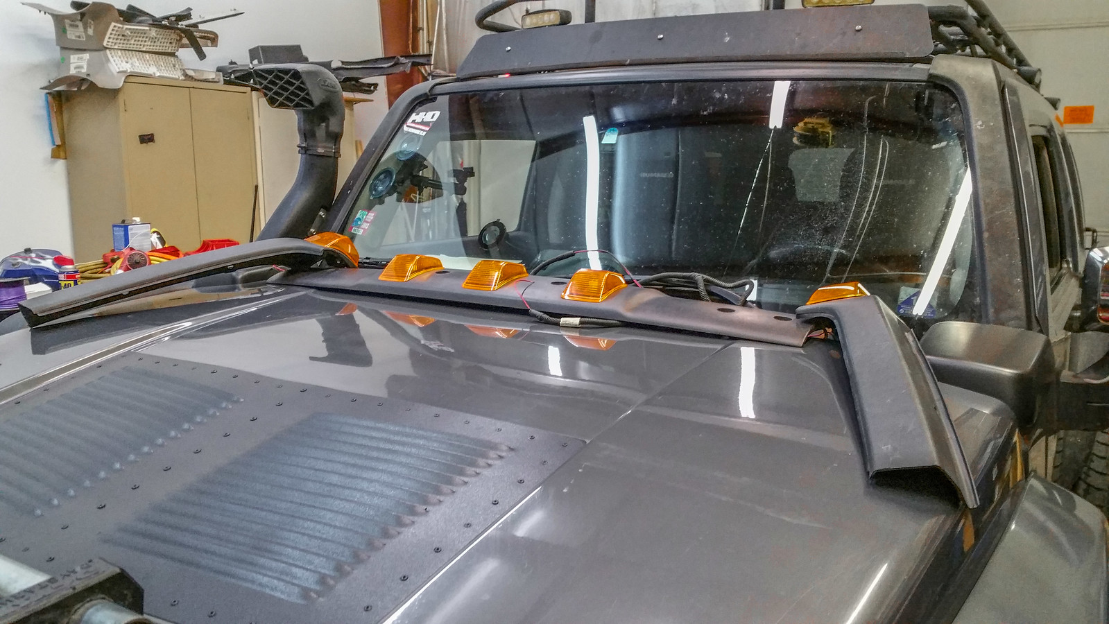

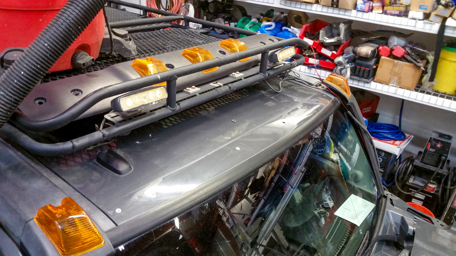

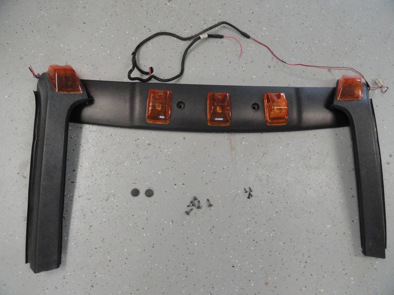

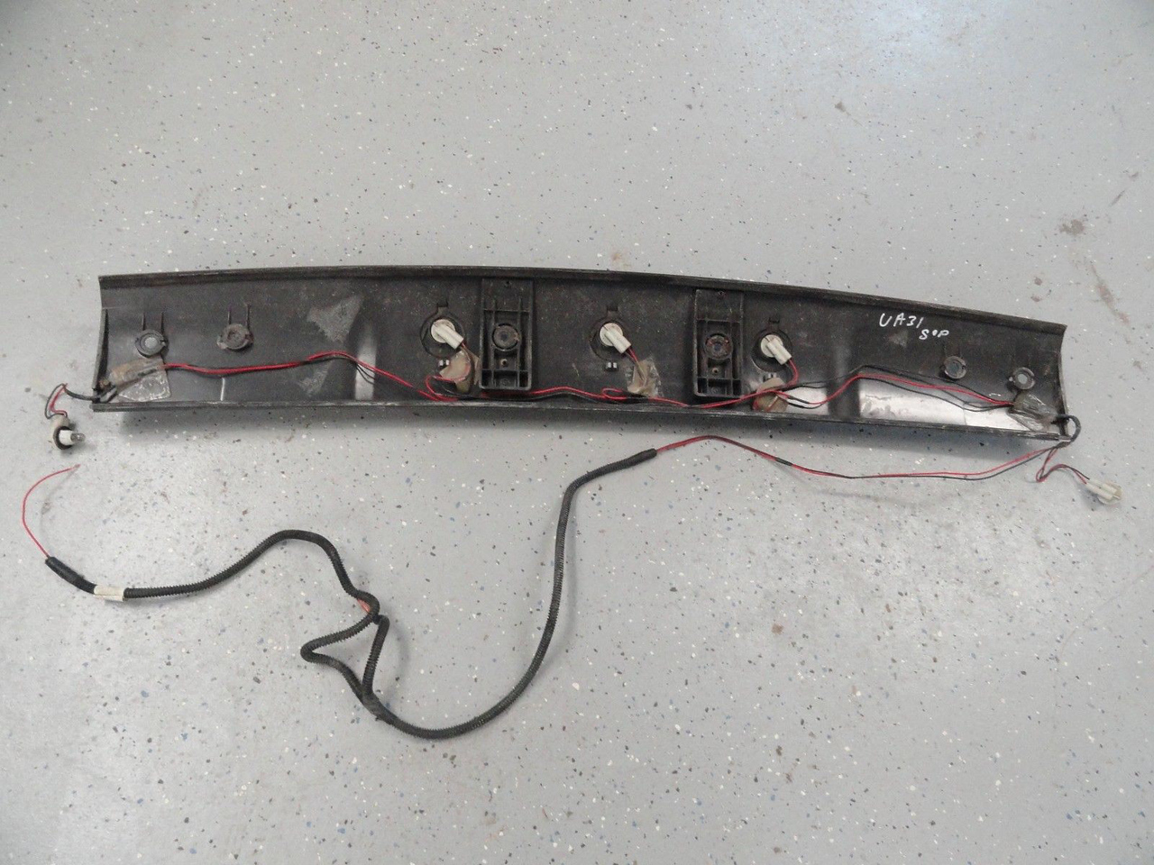

Installing OEM Roof Marker Lights
Well.... After an entire year... look what I found:
Yes... that is right. The super uber rare OEM roof marker lights. Swiped them up for only $200. Got them on ebay from a freshly parted out H3
Alright let's mount these things:
First thing I did was to test them with a battery. 2 of the 5 lights were dead. Replaced all of them. They require 194 Marker Light Bulbs

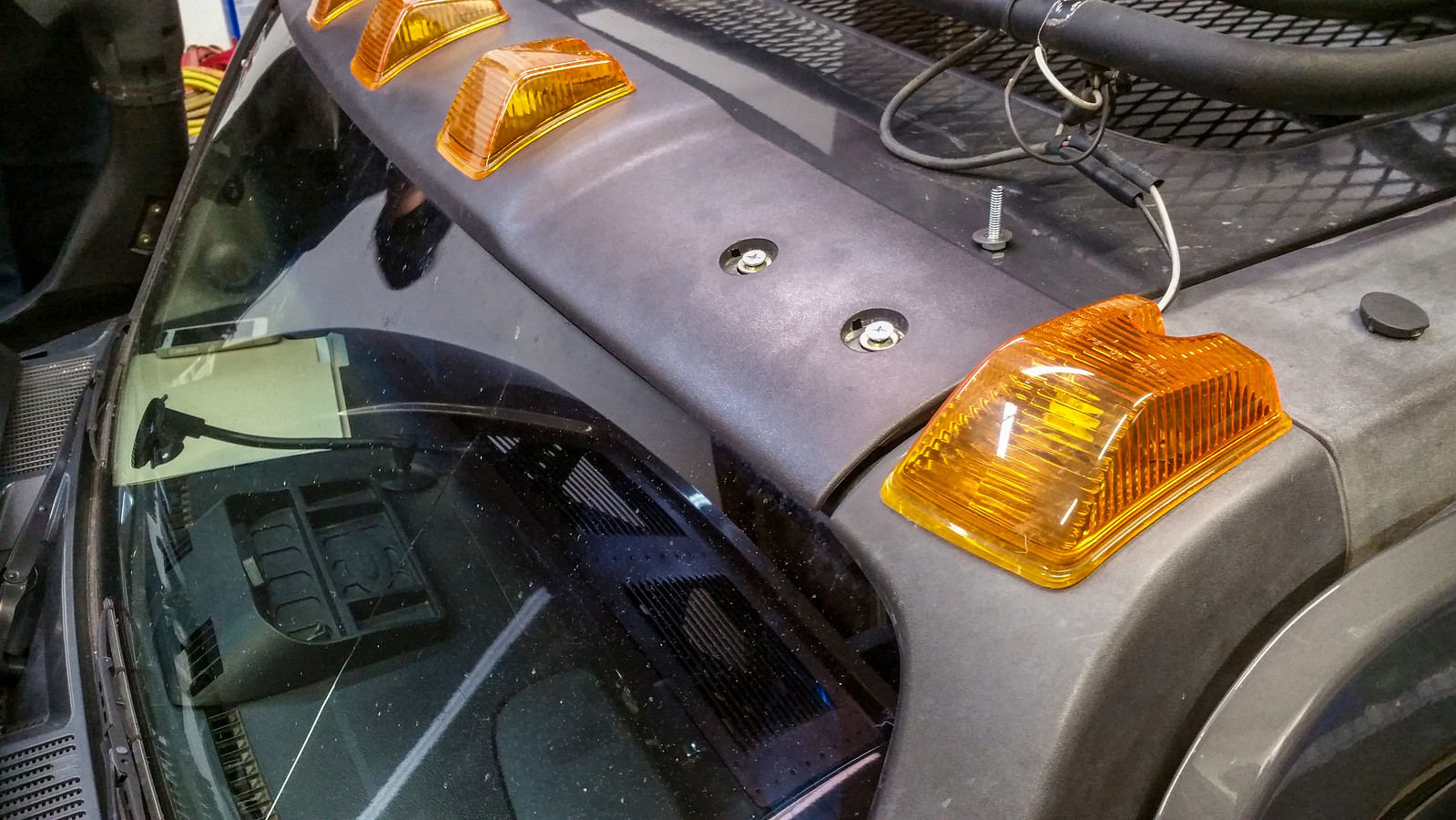

Mounted the A pillars. Then put the middle plastic trim up in the correct position and mark the holes with a sharpie.
Drilling into your roof isn't that fun. Was super careful that I didn't drill into the headliner.
Close up of drilled hole. I put a thread in hole with a special prototype and aviation thread tool. After that used a q-tip to put some black paint around the edges to prevent rusting
Surrounded each hole with 3M Strip Caulk to prevent water leaking.
Acer4LO
Illinois

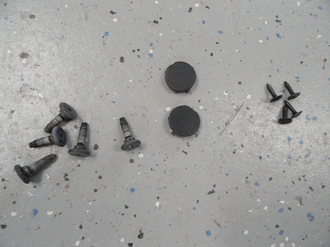

Time to mount
Used my own screws and washers since I didn't have the right thread size to use the OEM ones included with my buy
Sadly this was all I was given for the covers
Had to make do by using the 3M Strip caulk to cover the holes. Turned out nice.

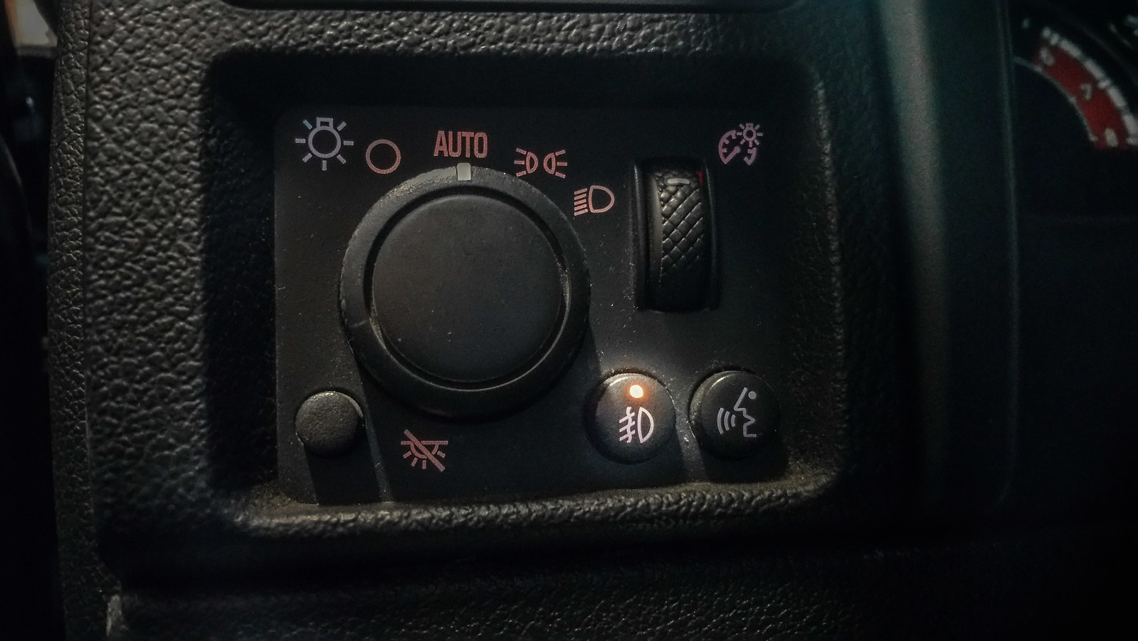

Wired them to the fog light switch. This way when I orange light is on I know that the roof lights are on. Also really didn't really want to run them during the day. Just a personal preference.
Tags: Hummer H3 OEM Roof Marker Lights Install, Orange Lights, H3 Marker Lights, Hummer H3 Running Lights, Hummer H3 Roof Lights
Acer4LO
Illinois

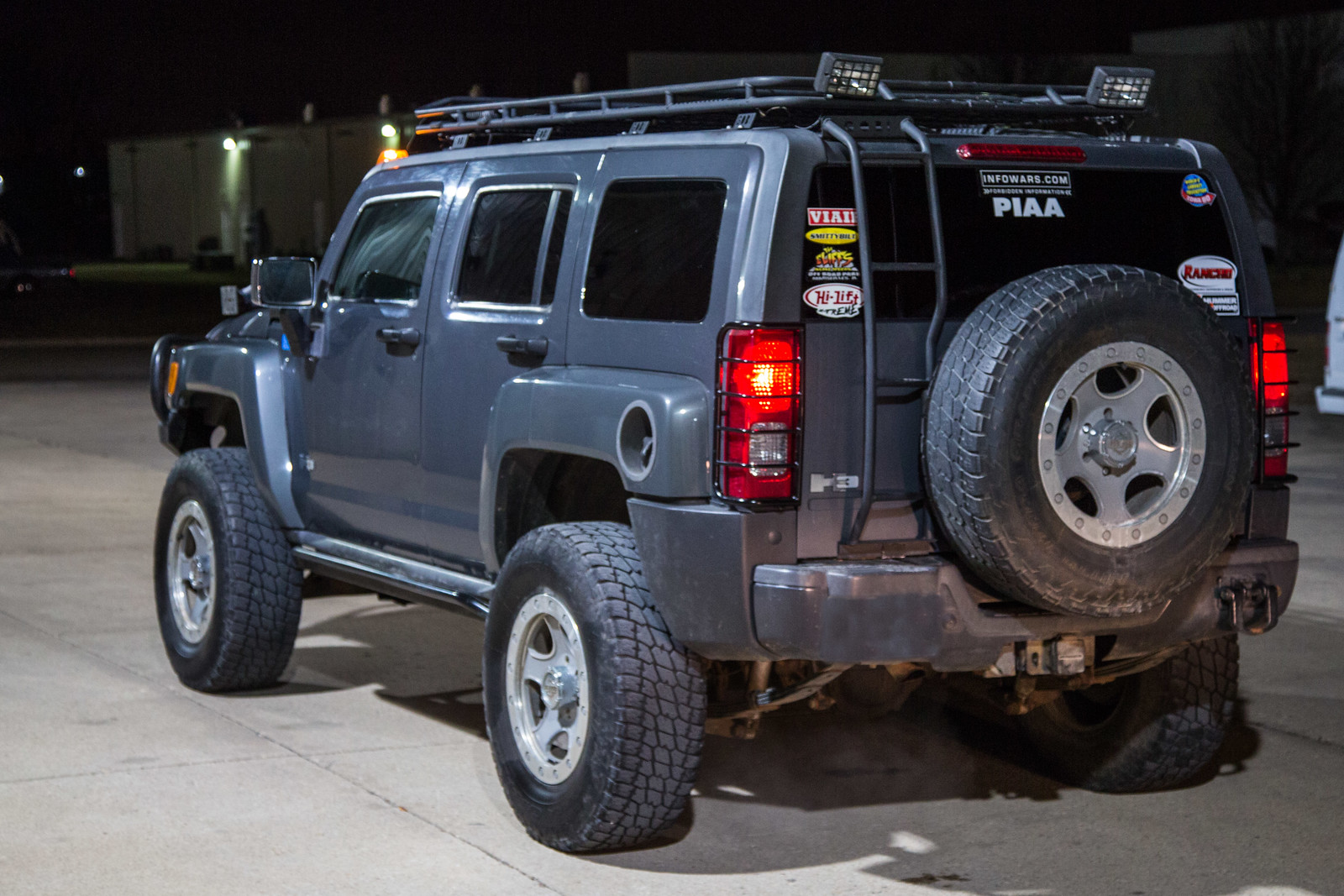

Here is are some night time shots with the roof lights. All I can say is wow... these look really really good. I am not sure why, but it just makes the truck look more "official"... if that makes sense.
Tags: Hummer H3 Gobi Roof Rack, Hummer H3 Gobi Stealth Rack, Hummer H3 Gobi Ladder, Hummer H3 OEM Roof Marker Lights, Hummer H3 OEM Roof Marker Lights Install, Hummer H3 Install Lights, Hummer H3 Marker Lights, Hummer H3 Tail Light Guards, Hummer H3 Rancho Lift Kit, Hummer H3 Lifted, Hummer H3 4in Lift Kit, Hummer H3 Rocky Road Sliders, Hummer H3 Hi-Lift Jack, Hummer H3 Mount, Hummer H3 Snorkel

Plasti-dipping
Platty-Dipped Emblems Black

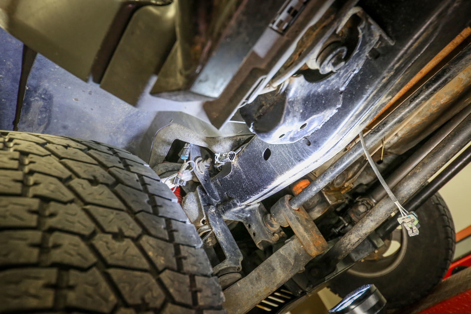

Wheel Spacers/Adapters
These just came in. Really need to add these because the the driver side upper control arm is actually rubbing on the tire. Look back at the JKS install pics for lolz. Having a friend who knows how to do these things right help me because Idk what I am doing.

Alright quick question guys. Been thinking about getting some wheels and tires in the next couple of months. Will 38" tires fit if I do the 1" daystar bodylift? If they fit I am probably going to have to regear right?
37s fit on stock h3s with a body lift so no reason 38s wont fit after you add a rancho. Its how offset you wheels are that determines if your tires will rub on the back of the front fenders.
As to regearing, at 38s you will need to go up to 4.56 (thats the max possible on the H3)
