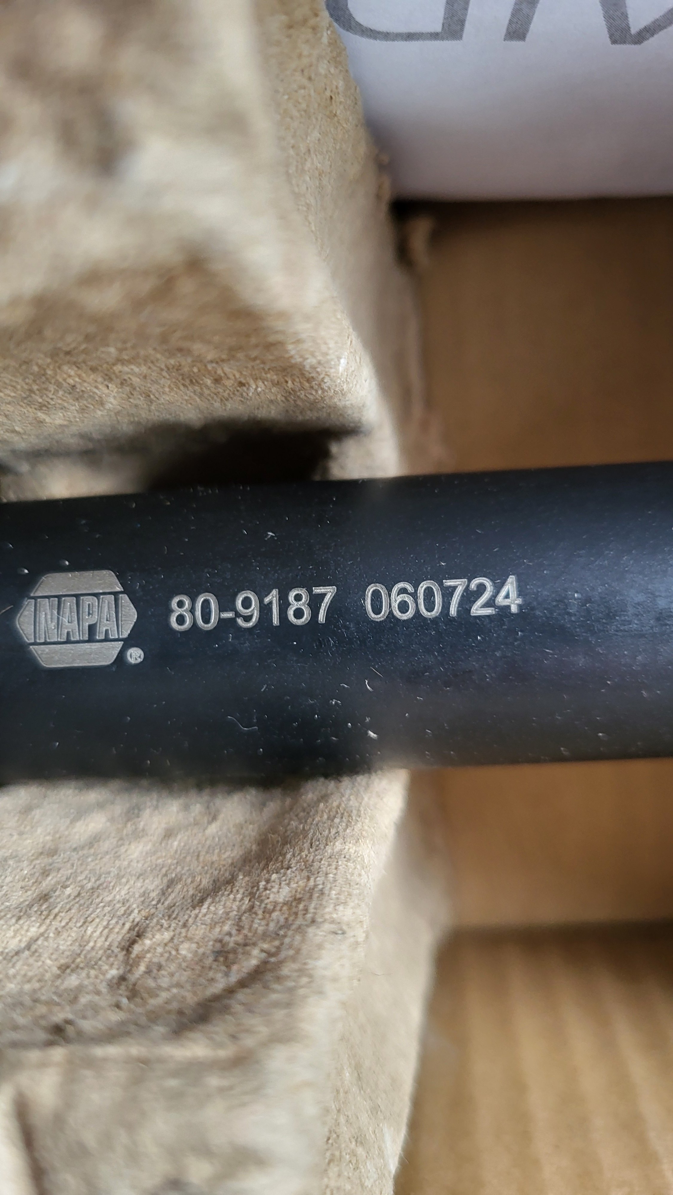

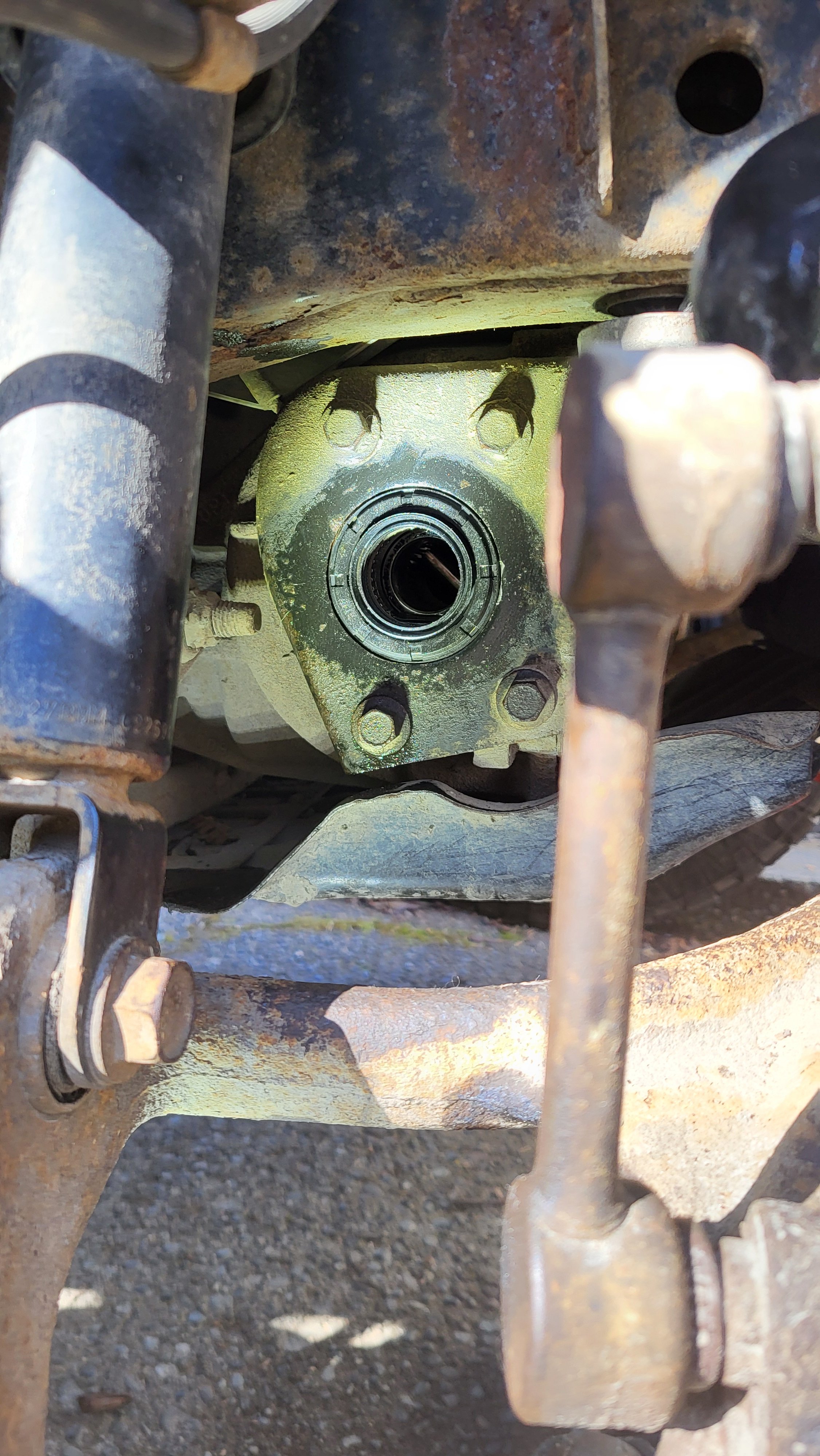

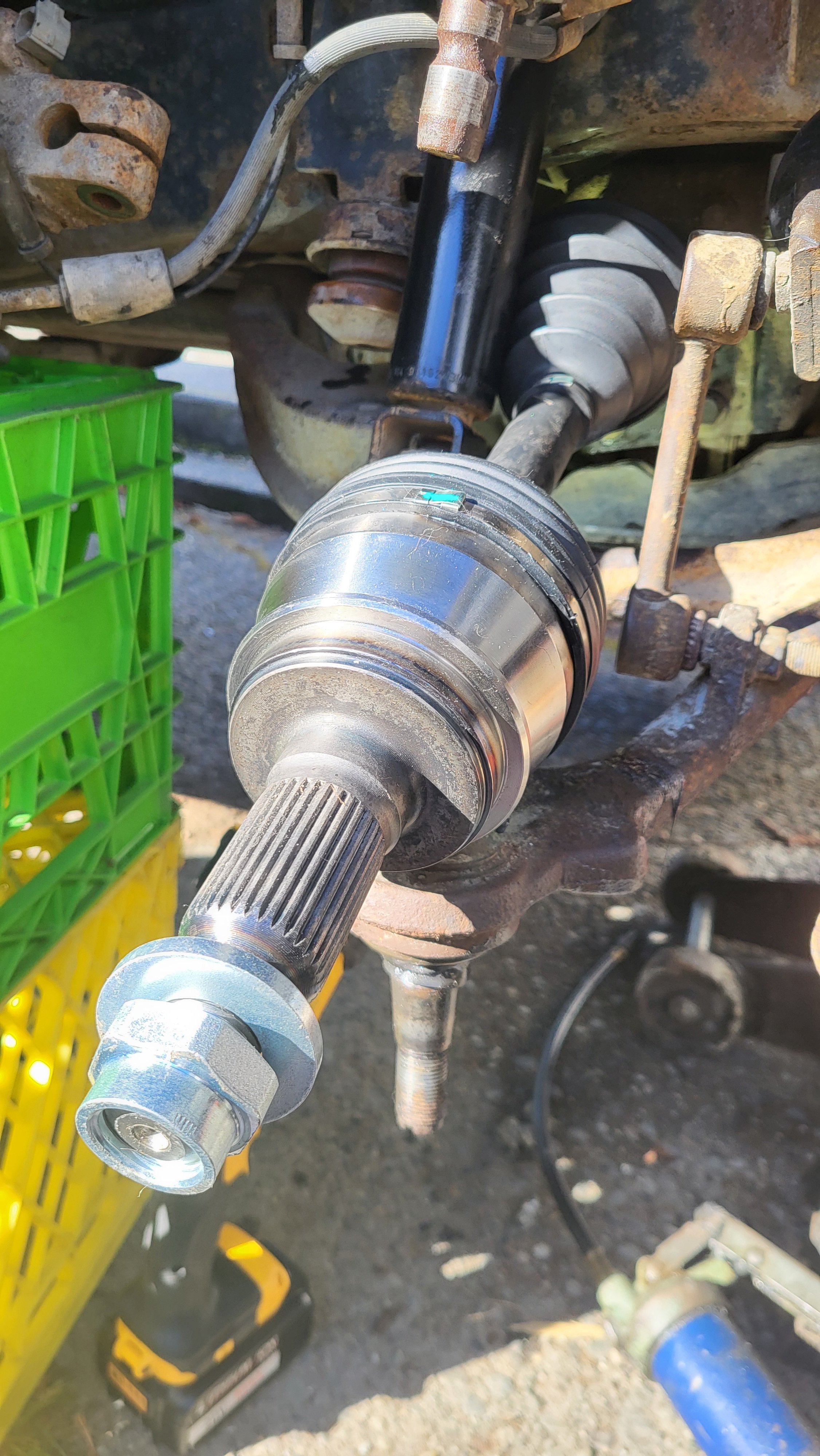

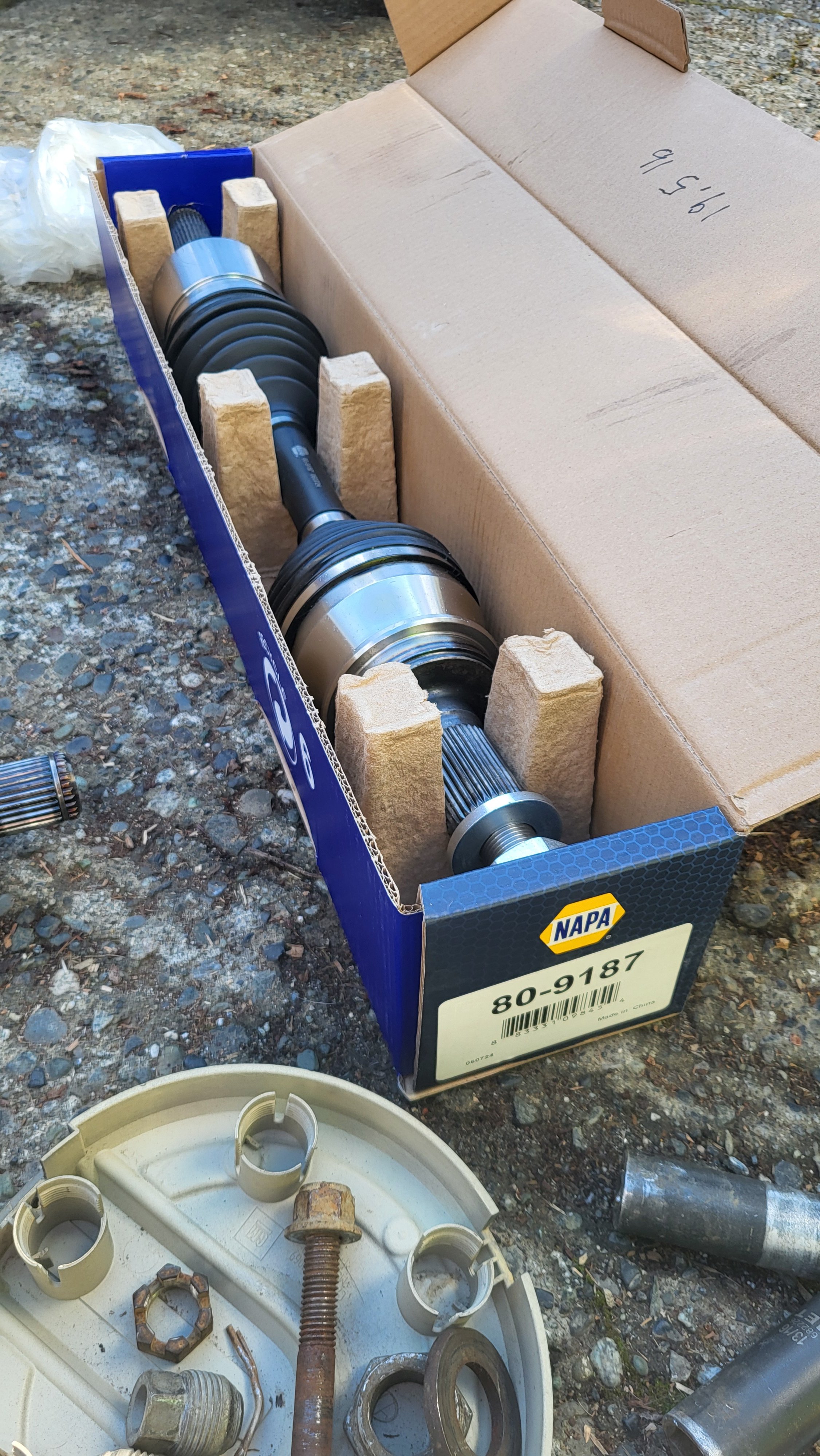

The parts manager at the GM dealership told me they've been having much better luck with the NAPA ones than the ones from Lordco. I'm guessing some of their customers dont want to pay $600 per shaft either.
This is my first go-round with this job and I had no idea how easy it is. 4 nuts removed, re/re, bingo-bango-drive away. Lol.
$190. Canadian + 15. for the seal

Grey poupon
67
Coastal B.C.
Very good news, can you share that parts store please? Thx
This was at NAPA in Powell River B.C.
This one weighs 19.5 lbs, if that means anything.

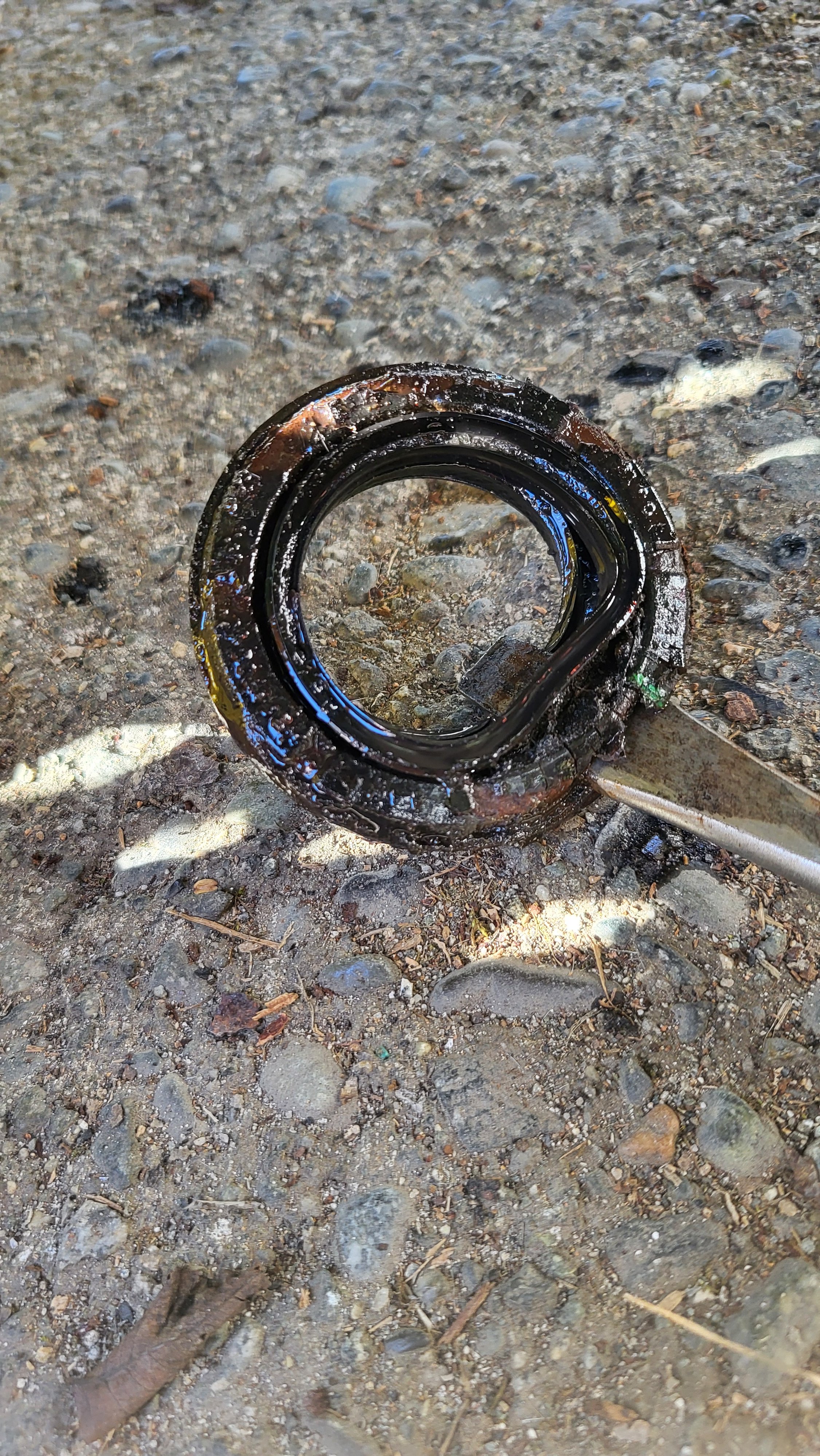

I am glad that went so well. I'm not sure if I should be doing something with the old axle. Does anyone know an easy way to tell if it's an OEM one?

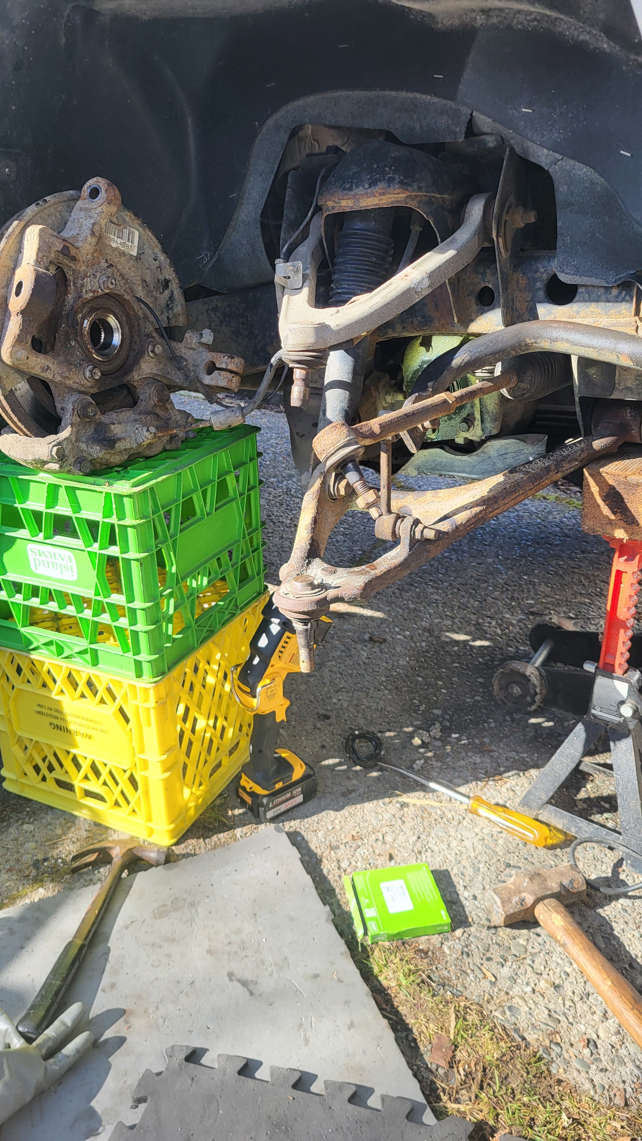

I watched a couple of inspiring videos. One was on a truck with lots of surface rust (like mine), and the other one was from Australia and the guy said to leave the calipers on. I did that and it is definitely the way to go. He also left the lower ball joint connected by a few threads, and the knuckle dropped down enough to get the axle by. I did not seem to have the same amount of clearance he did, so I took that off too and put the whole thing on a couple of milk crates that you can see in the pics.
