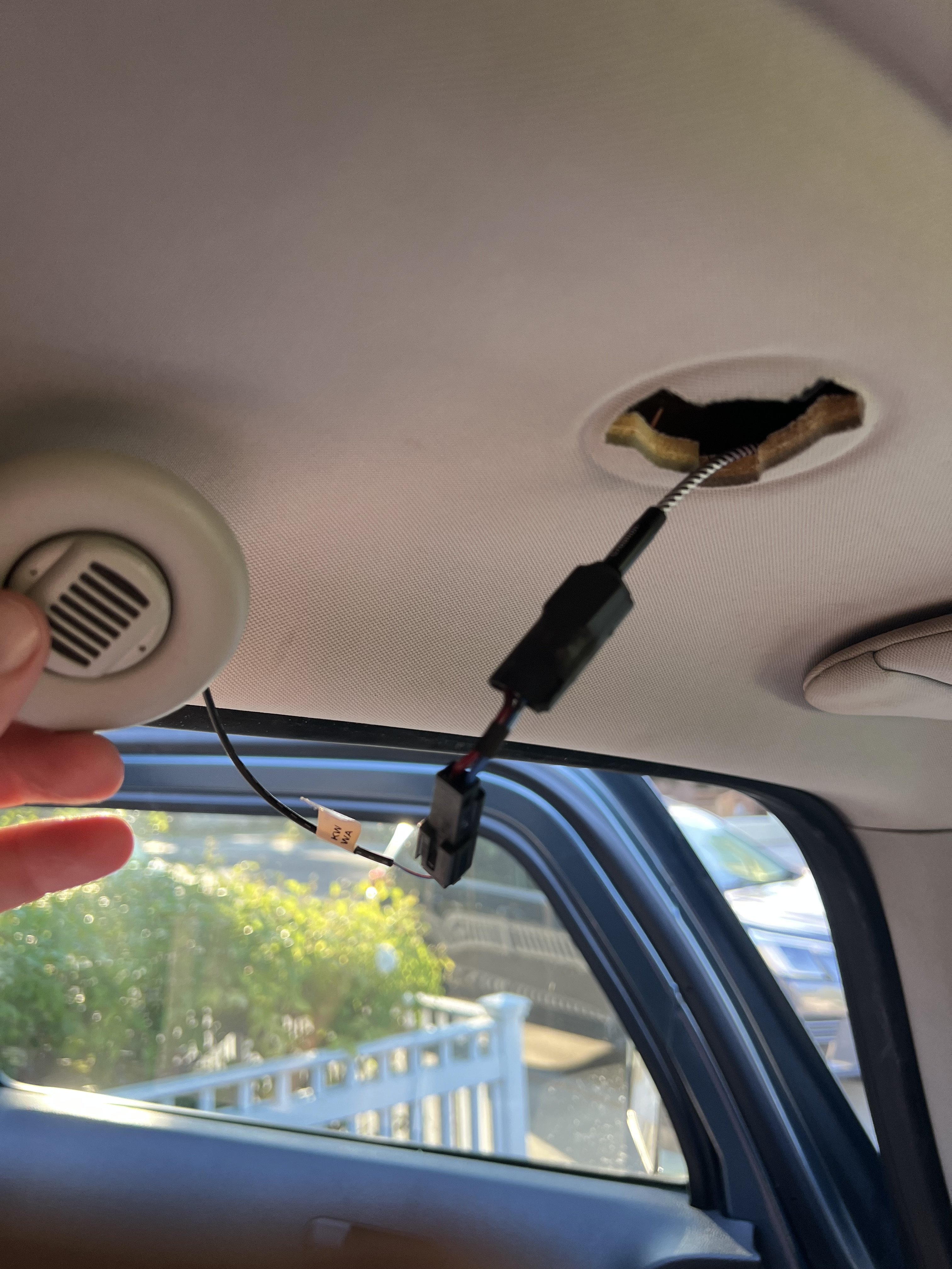

The Bluetooth mic is just a small mic clipped on to the top of the A pillar trim cover. I wanted to use the Swartzee Onstar mic conversion, but the stereo guy did not want to use something he did not know about as he was installing and warranting it all.

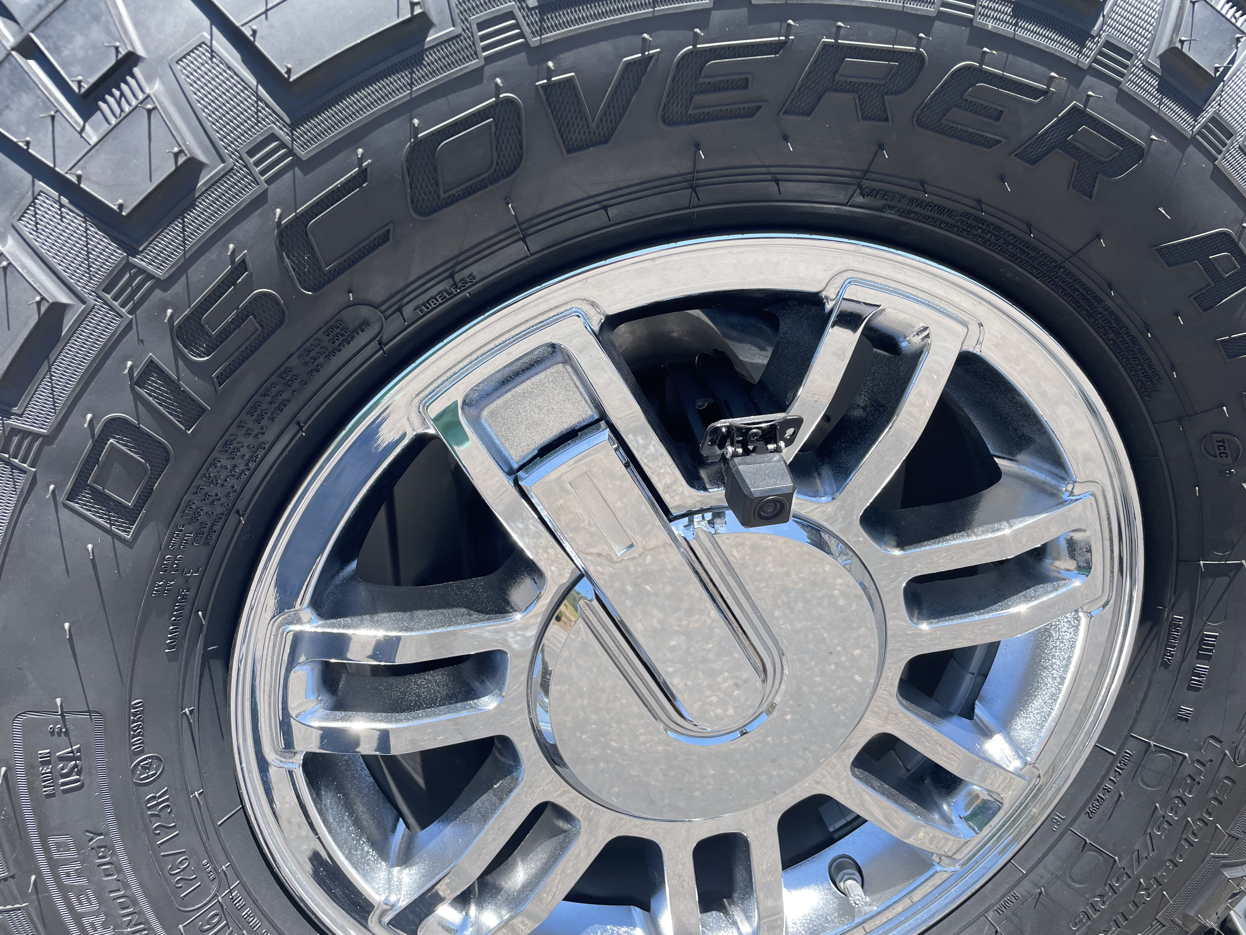

As far as the rear camera. It’s a metal ring that slips over the wheel studs on the spare tire mount. The kit has a few extension mounts that the camera mounts too. I need to adjust mine back more into the wheel to look a little cleaner. If I had aftermarket wheels with a bigger offer this would be perfect. I like the camera up higher as I can get a more broad view? which when off roading on a trail can be helpful. I’ll look up the brand of mount I got later tonight and post it up.
Rear camera

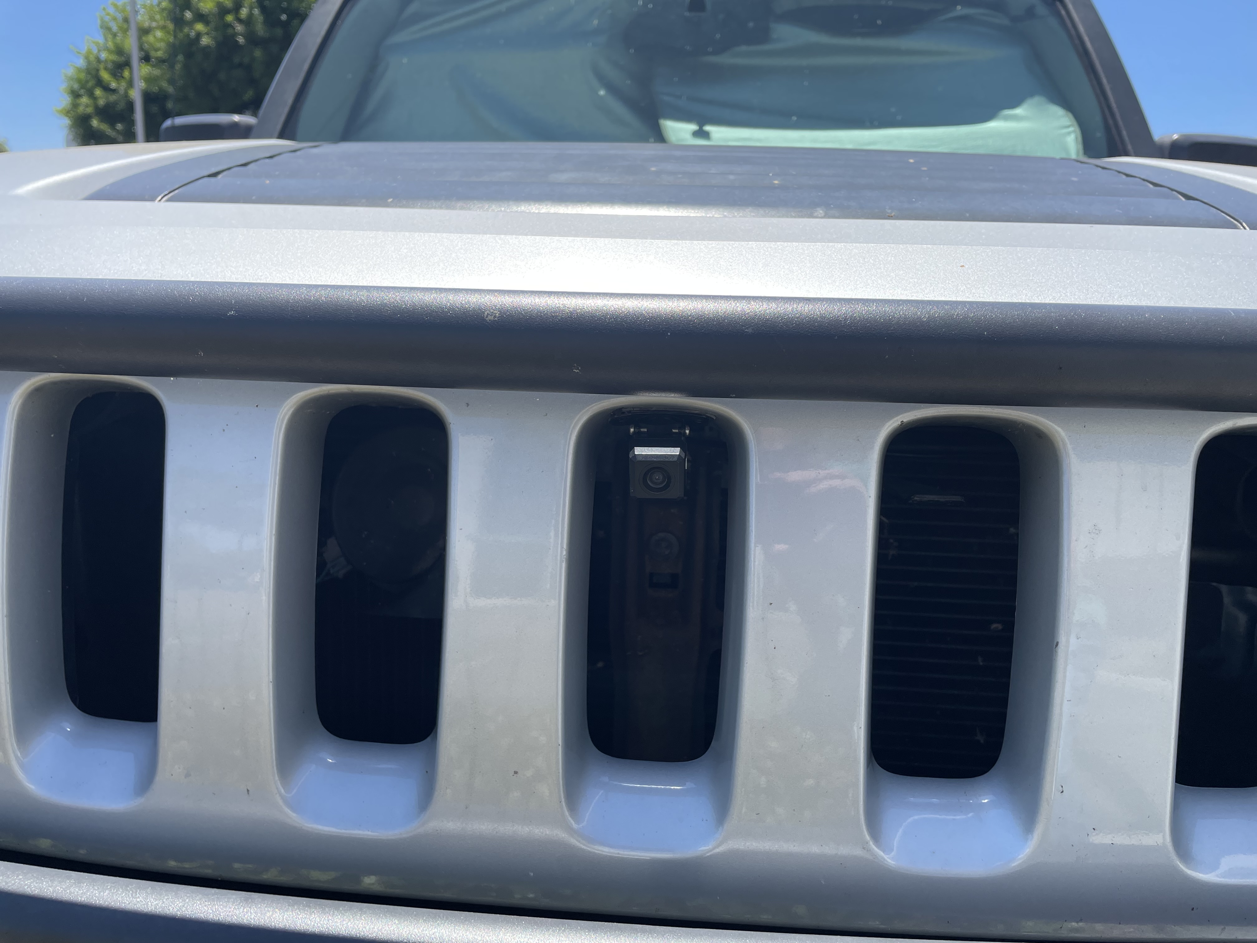

Front camera

I like your front camera placement. I went with the basic Kenwood. Turns out they have a special cable for the backup cam that was not in the kit. Back to Crutchfield for the WTF and another application of cash.

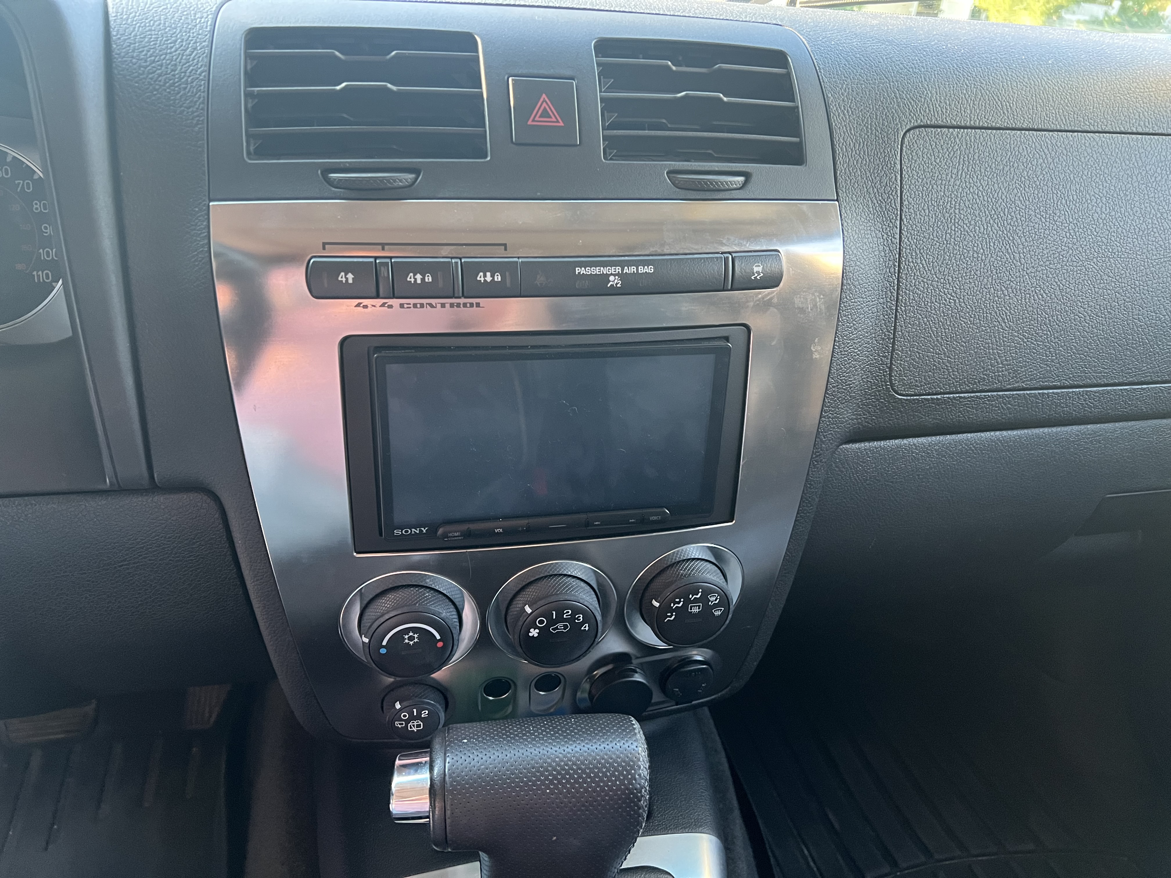

Figured it’s time for an update from me:
- added the Sony stereo XAV-6000
- added the OnStar mic conversion (http://schwarttzy.com/)

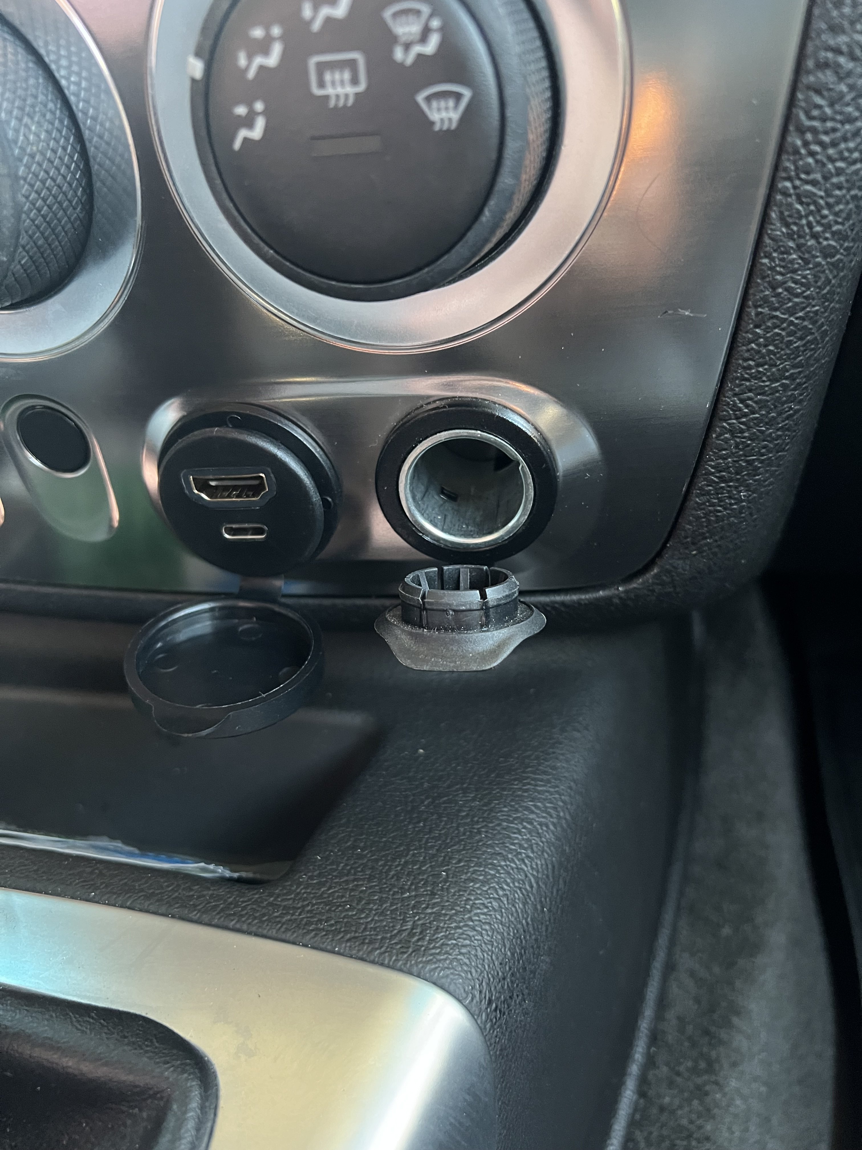

- replaced the cigarette lighter socket with one that’s a HDMI/USB port (https://a.co/d/epoB3Nt)
Haven’t yet set up the back-up camera, though that’ll be the last piece for my stereo. How am I going to get the wire in the vehicle if I hook it up to the tailgate?
Also, the adapter I received for the stereo was the PAC RP5-GM11. I initially set it up using the connection for cars with an amp (I have the monsoon system), but wasn’t getting any bass output so switched it to non-amp and now the stereo has bass and sounds much richer.

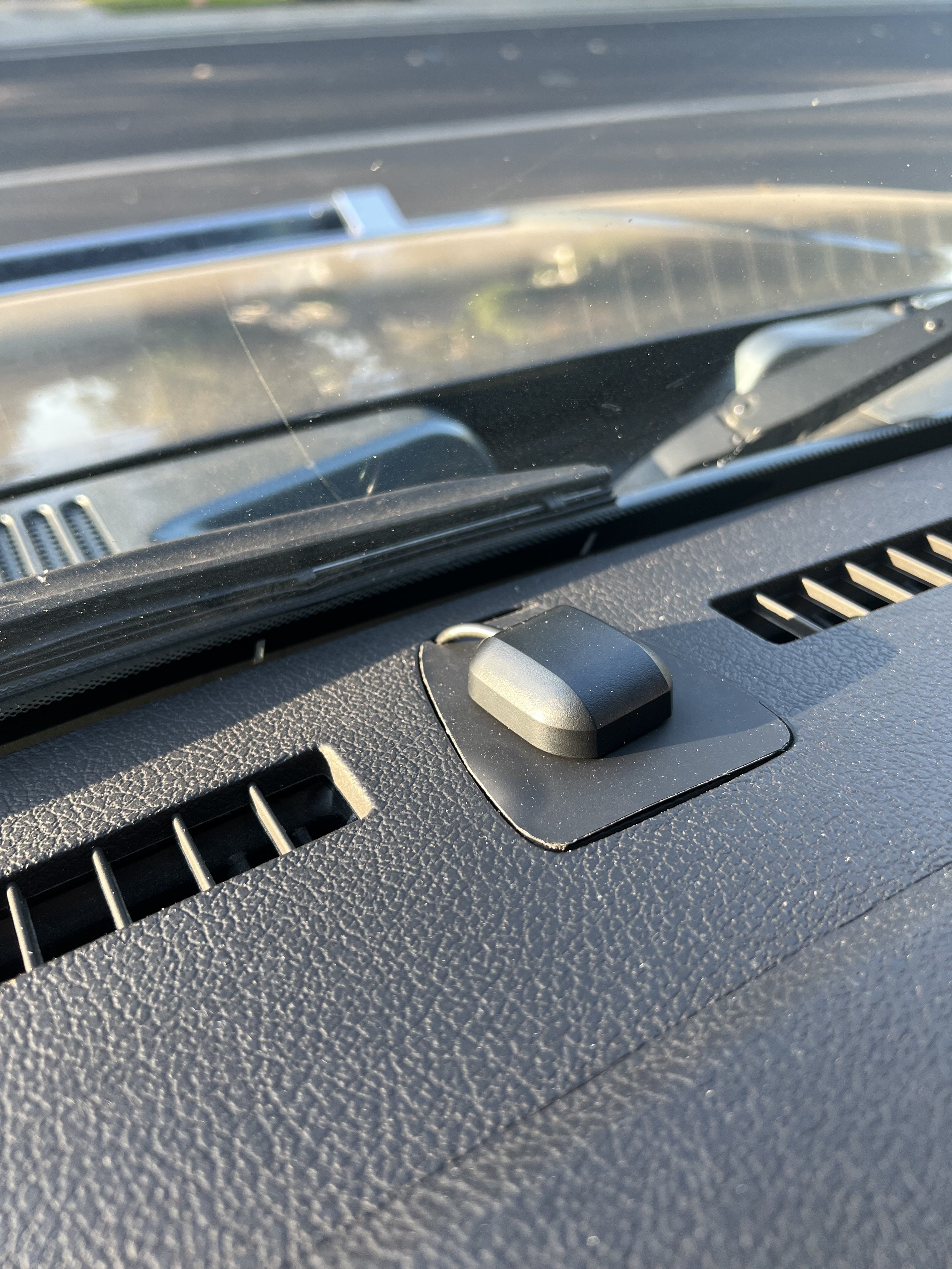

I had my satellite antenna in the center of the dash like you have and I noticed when driving in a Northern direction it would cut out. Not all the time, but enough to be frustrating. The windshield is too vertical for the antenna to get a clear view of the sky. I eventually had move it to outside and it’s fine now. I have the satellite antenna on my Silverado inside on the dash and it works fine. So it’s got to be the vertical windshield/ roofline of the H3. Btw I’m in So. Cal and maybe in different parts of the Country results will be different?

I did complete the wiring from the back. I ended up using the Schwarttzy backup camera mount on the spare tire.
It's been good; but maybe not great. Ok, maybe great, but not excellent? The fish-eye camera has some about 1/3 of the image cut off (blocked by my wheel).
Anyway, I think the video you shared might've been the wrong one.
But in practice, the wiring required:
- tunelling through the rubber flaps between the wheel (external) and the tire iron (internal)
- running the cable along with the other cables through a pre-existing wire management tubing (from the tailgate to the body; required pulling it through with some other wiring - kinda tight)
- pulling out the interior paneling up to the front (and the subwoofer, too) and routing the cabling alongside the wires that go along the door wells.
- running the cabling up / over / behind the steering column and into the chamber behind the stereo.
I also used coprious amounts of zip ties to organize the wiring going to my stereo as I had:
- GPS antenna wiring (came w/ stereo)
- adapter wiring to native connections for stock stereo
- HDMI / USB-C wiring (for stereo)
- microphone cable
- FM antenna
- chime speaker
Anyway, it's not so complicated looking back on it. But I definitely learned some stuff in the process!
