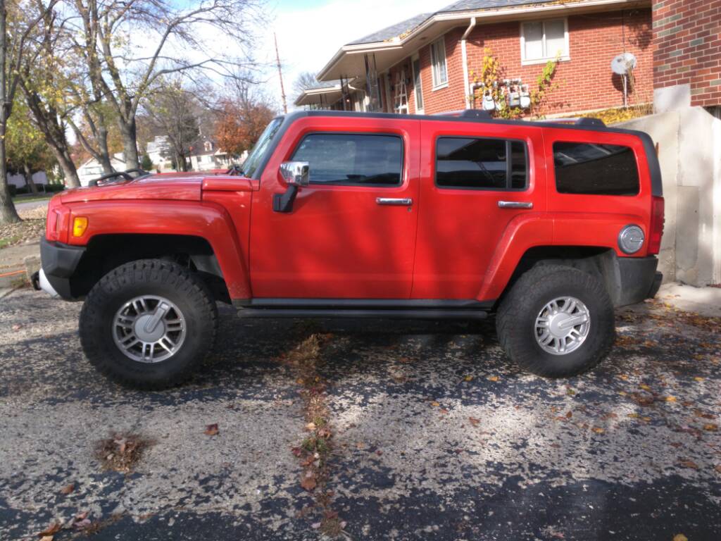

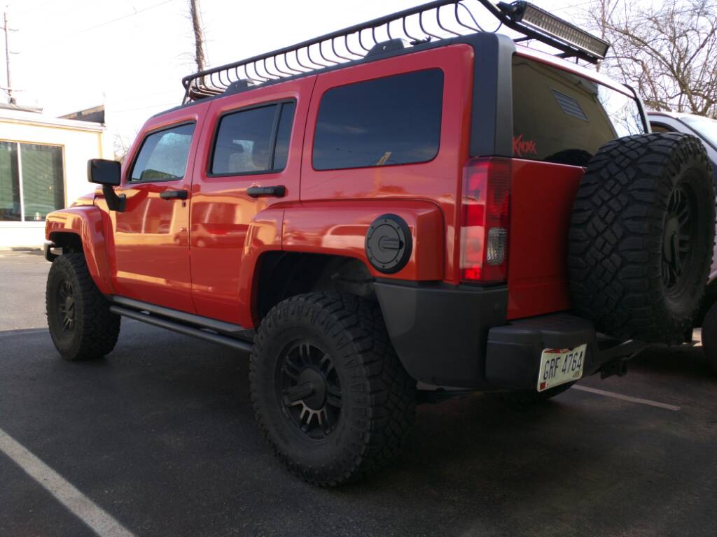

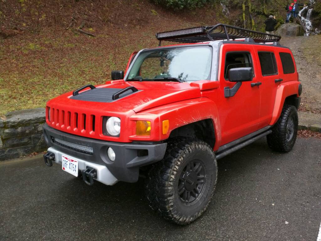

I've already done quite a few mods since buying it in October of 2015. I would like to keep a better progress record, so here I am. uploadfromtaptalk1457496566719.jpg
Starting out.
Three 300 watt 32 inch lightbars. Curved in the bumper and both are straight up on the rack.
Plastidipped wheels, mirrors, doorhandles and fuel door.
33" Duratracs
Airdoc intake.
OEM rocksliders.
Kenwood BT touchscreen head unit.
Muffler delete.
Led interior lights.

love your roof rack and light setup, that's the one I'm going to get soon when I have the cash for that and the oem rails, and I'm gonna do a rear bar exactly like yours.. tailgaters!!!

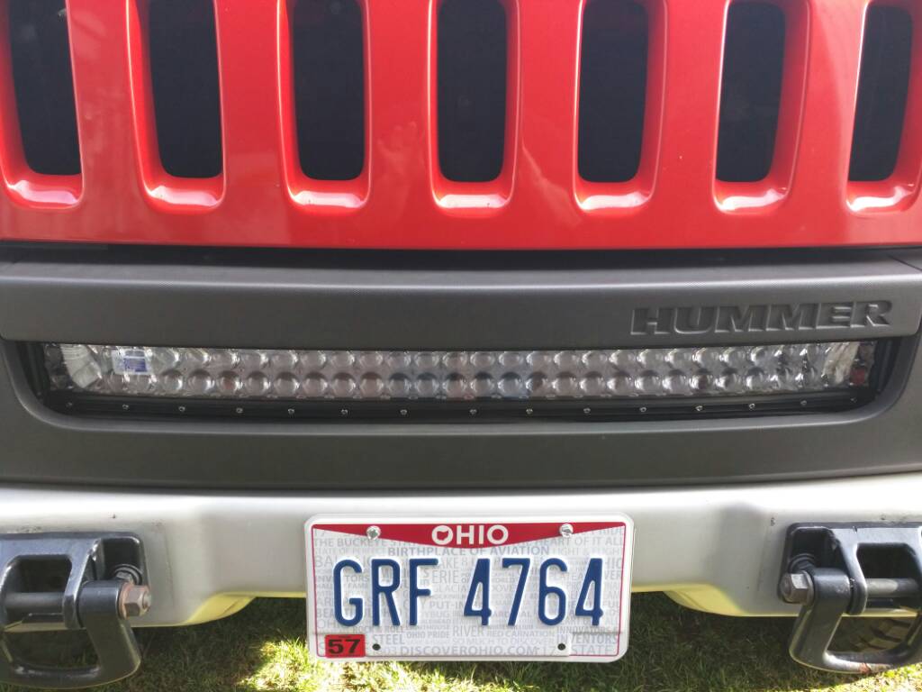

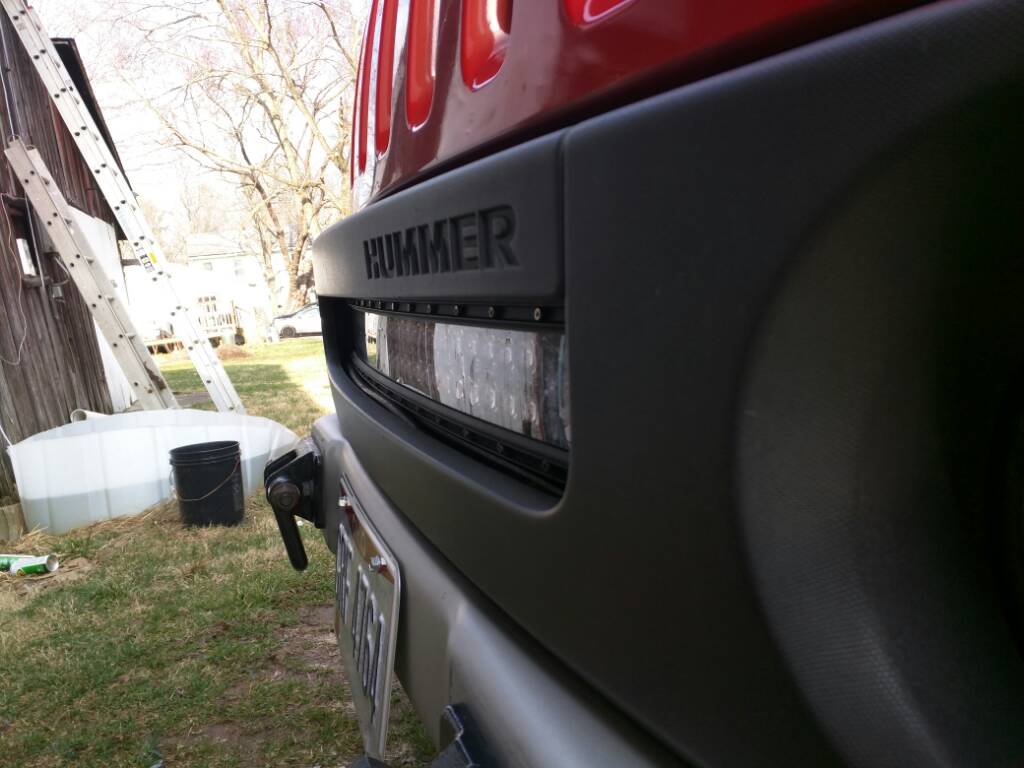

How does the 32 inch light fit inside the bumper? Any detail pics? Thanks
CaddyStrophic
413
It took about 2 hours of custom bracket building from square tubing to get it to sit right, but the 32" curved fits in there like a glove. Looks as close to something factory as can get. I'll take some close up shots this weekend.

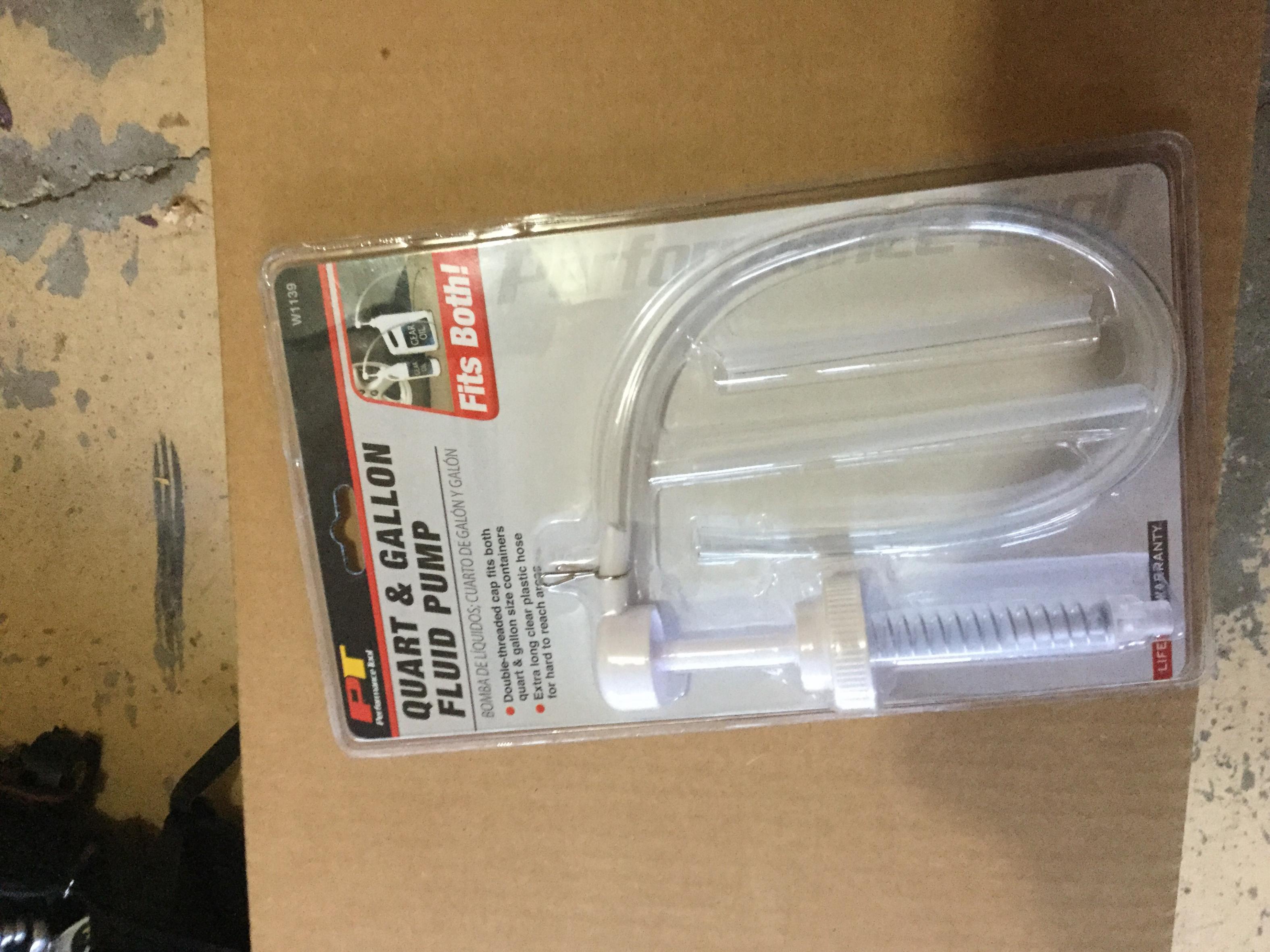

Best $9 I have spent in a while. Makes fluid changes a bit cleaner and definitely easier .

I got the motor oil changed and both differentials done last night. I did have a pump and honestly, I can't imagine doing the differentials without one!

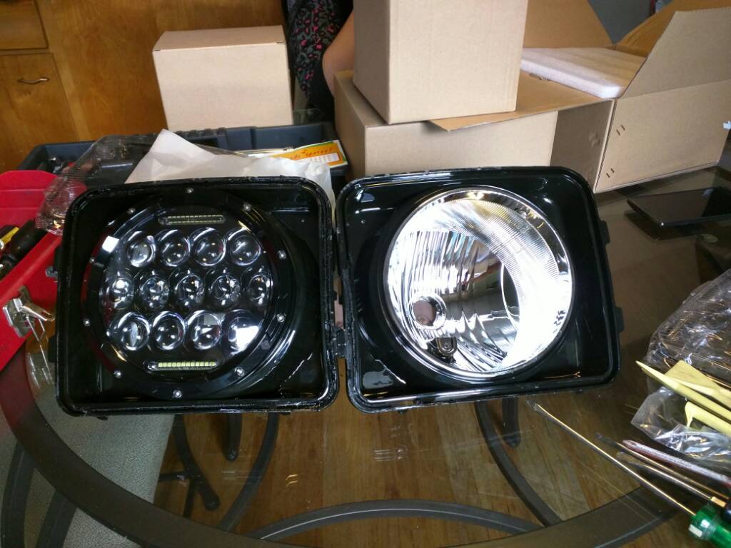

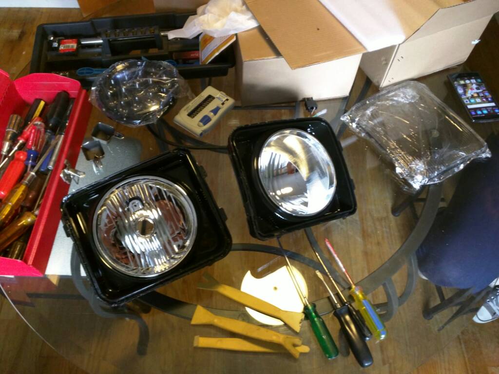

I got the headlight assemblies apart and the lens off. Measuring the Jeep headlights to the H3.
They are both exactly 7" edge to edge. So I need to figure out a clean way to cut out the chrome plated section and recess the Jeep headlight into the housing.
I'll be heading down to my buddy's garage tomorrow to see what we can accomplish.

Just a little update. The headlight swap is going to be an insanely time-consuming job.
It's seems almost impossible to cut it so that the LED headlight will fit into the housing without losing the 3 bolts on the back of the housing.
I've been slammed at work lately, so I haven't had much time go work on it, either. I'm honestly thinking about fiberglassing a custom enclosure for the LED headlights. I'll update when I figure something out.
