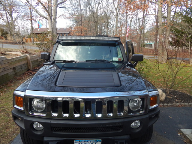

Does anyone know of a fix for the lightbar whistling when you get over 40? I did see a fix involving I think door trim but can't find it anywhere.

pictures... here's how I fixed the issue the first time
silicone between the vanes... note there isn't a wire harness on this side
this was the whistle position - note the wire coming out of the top of the light bar on the passenger side?
you can just see the wire coming out of the bottom of the light bar on the driver's side in this picture
yeah, I know it sounds like a joke - but it's true; they just forgot to mention that bit in the instructions....

I went with the silicone on both sides no noise or whistling.

The rubber door trim worked for me, be sure its the plastic base, rubber flap one though, not the one with the brush like hairy bit. That doesn't work as well.
