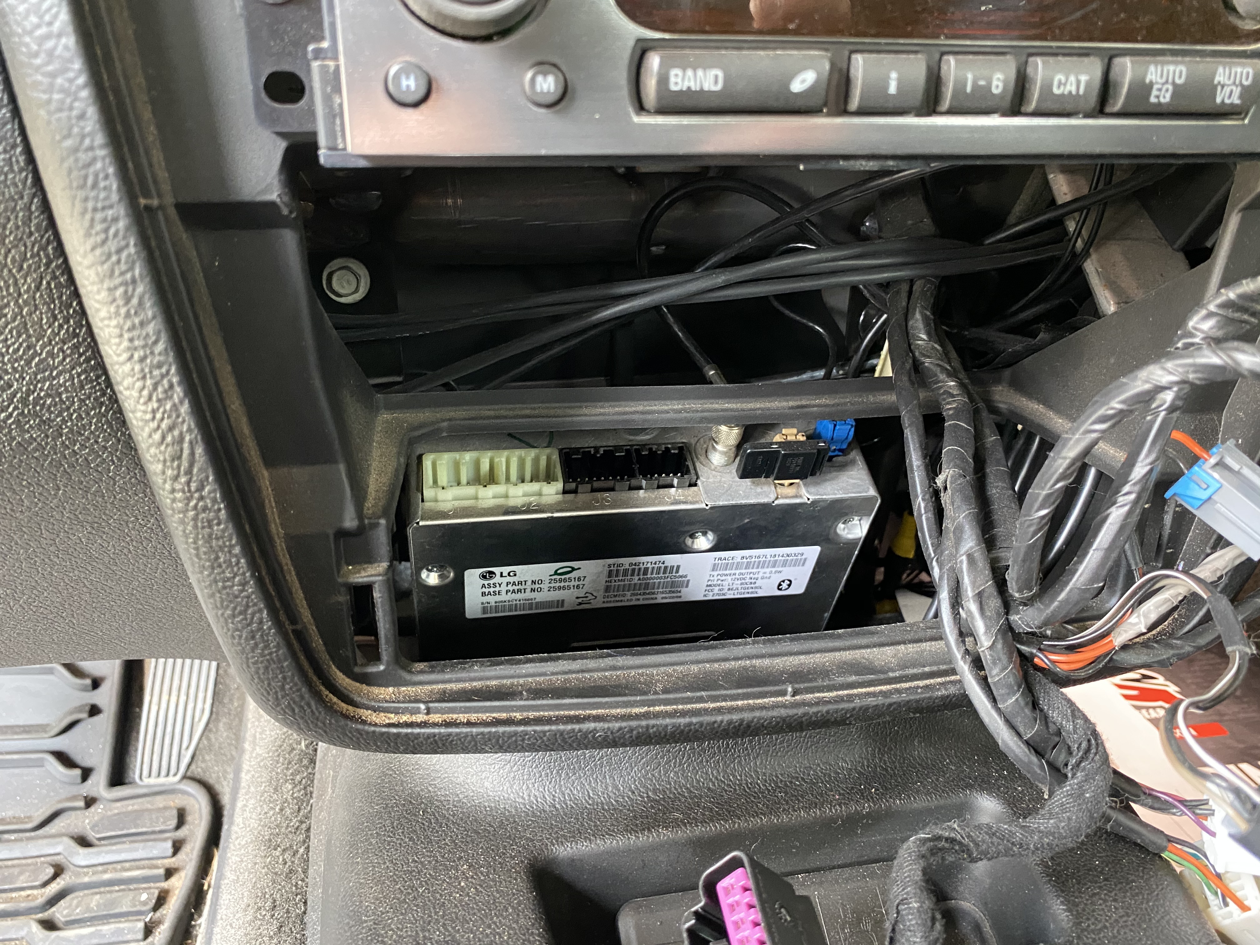

As I was splicing wires for my engine swap I noticed a single wire and inline fuse coming off the battery. It looks like this is for onstar. Does anyone know why this gets its own inline fuse rather than using a fuse in the fuse block?
Also has anyone removed the onstar module and associated components all together? I am looking to clean up and simplify my wiring, just wondering if anyone has succesfully bypassed it?
I do remember someone posting about this years ago, they unplugged something behind the radio if I recall correctly.

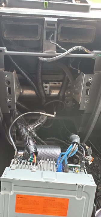

Is that box behind the stereo only for OnStar and XM? I've installed a new deck, and if that is just dead weight, I'd love to remove it.

Well for what's its worth the H2 doesn't care if its powered down and removed. I did this on my 06 when I was trying to trace down a parasitic draw issue which by the way was the issue. Its fuse on my 08 has been out for well over a year, no problems.

I ditched it years ago and mounted my Icom base unit in its place. No issues outside of satellite radio.

I kept that to tap into to run Bluetooth connection to the factory radio. Factory radio is finally starting to act up so I'll probably get rid of the module behind the glove box once I install a new deck.
