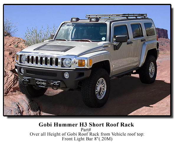

Great thread, GOBI has a new short rack for the H3.
http://www.gobihummer.com/H3.htm
