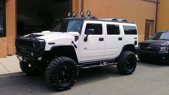

Hey everyone I'm looking at swapping my Jeep Wrangler for a hummer h2 in white with the 6.0 motor. I'm just curious about some of the cool mods you guys have done to yours. I'm wanting to do a 6 inch fabtech lift with 18 inch cleaver rims in black and 38 inch mudgrapplers any advice would be greatly appreciated. I will upload a photo of the hummer that I'm wanting to make the one I hopefully get look like.

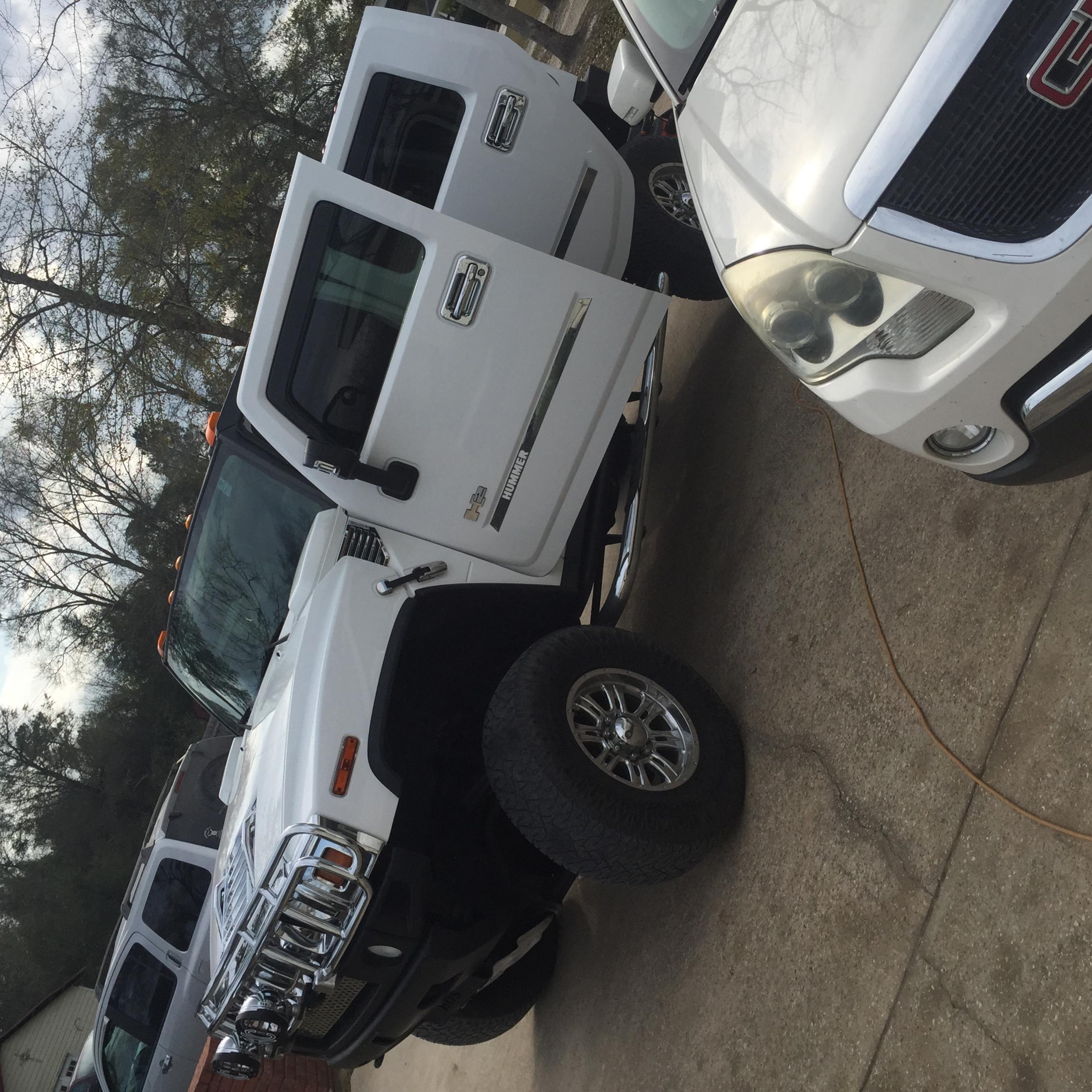

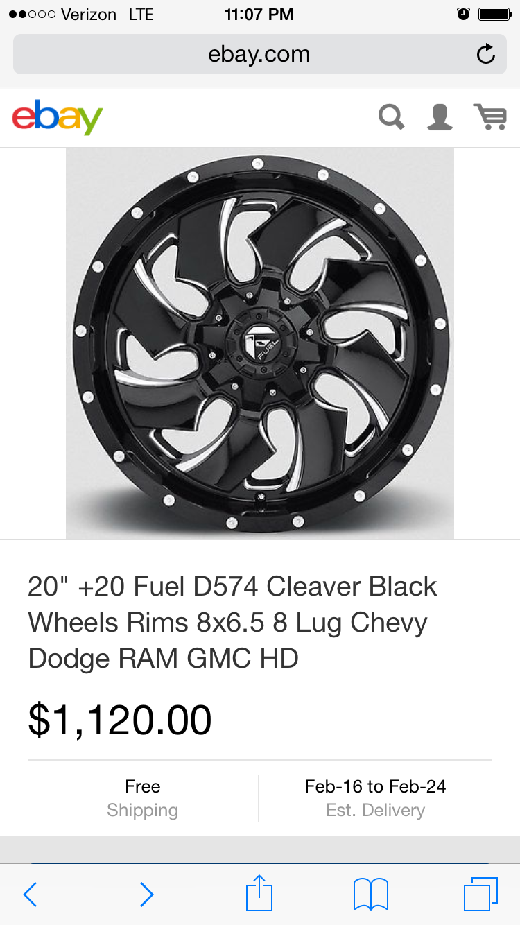

Swapped my Jeep for a 2006 hummer h2 luxury today it has 37 inch tires on it now do you all think I should put 40s and 20 inch rims on it the the 37s look very small I'm wanting nitto mudgrapplers and 20 inch cleaver rims any advice would be very much appreciated.

Keep it looking tough don't go with the girly wheels you cry when they get scratched. Put some Spyderlock Beadlocks on there and some big 37" Pitbull Rockers with a good 4" lift. Make it awesome. REMOVE THE CHROME**

I think it's got a 6 inch lift on it now and I'm definitely going to black all the chrome out can't stand chrome lol thanks for the ideas GreatDaneHummer!

I am running 38s with no lift. As far as mods, I run front and rear lockers and 4.56 gears, Dynatech Headers, DIY on-board air system, modded the rock rails to bump them out 2", Kryptonite centerline and tie-rods, and many more I am forgetting about over the years.

20" wheels would be a major NO from me but it's your rig-do whatever you want to it. Huge sidewalls serve a purpose when offroading, 20s are pretty much worthless once you leave the nice paved roads.
Thats a BS I am running 20x12s with 38/15.5 for years now ( sometimes with trailer on same wheels)never had any issues on or off road. They do look much better vs. SMALL 18s. And I do off-road more that 80% of people on this forum.
