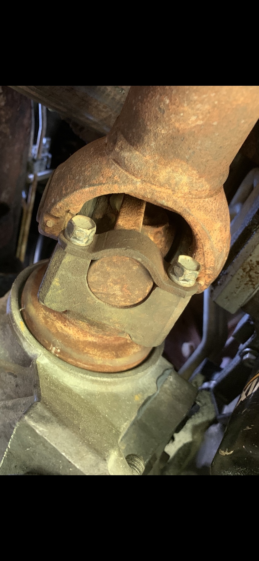

The shop kept telling me that they would send me some pictures but never did so I ran over there today to take a look. The ears on the front diff yoke that have caps on the end that bolt down over the u-joint are still there to my surprise based on what he had told me. He says that there are supposed to be two additional smaller ears 90 degrees from the previously mentioned ears that help hold the other 2 u-joint cap ends on and that they are no longer there. He says that the part has been discontinued but he has tracked one down and it is supposed to be delivered today. Does this sound legit or are they just trying to cover for a u-joint failure after only 3 months?

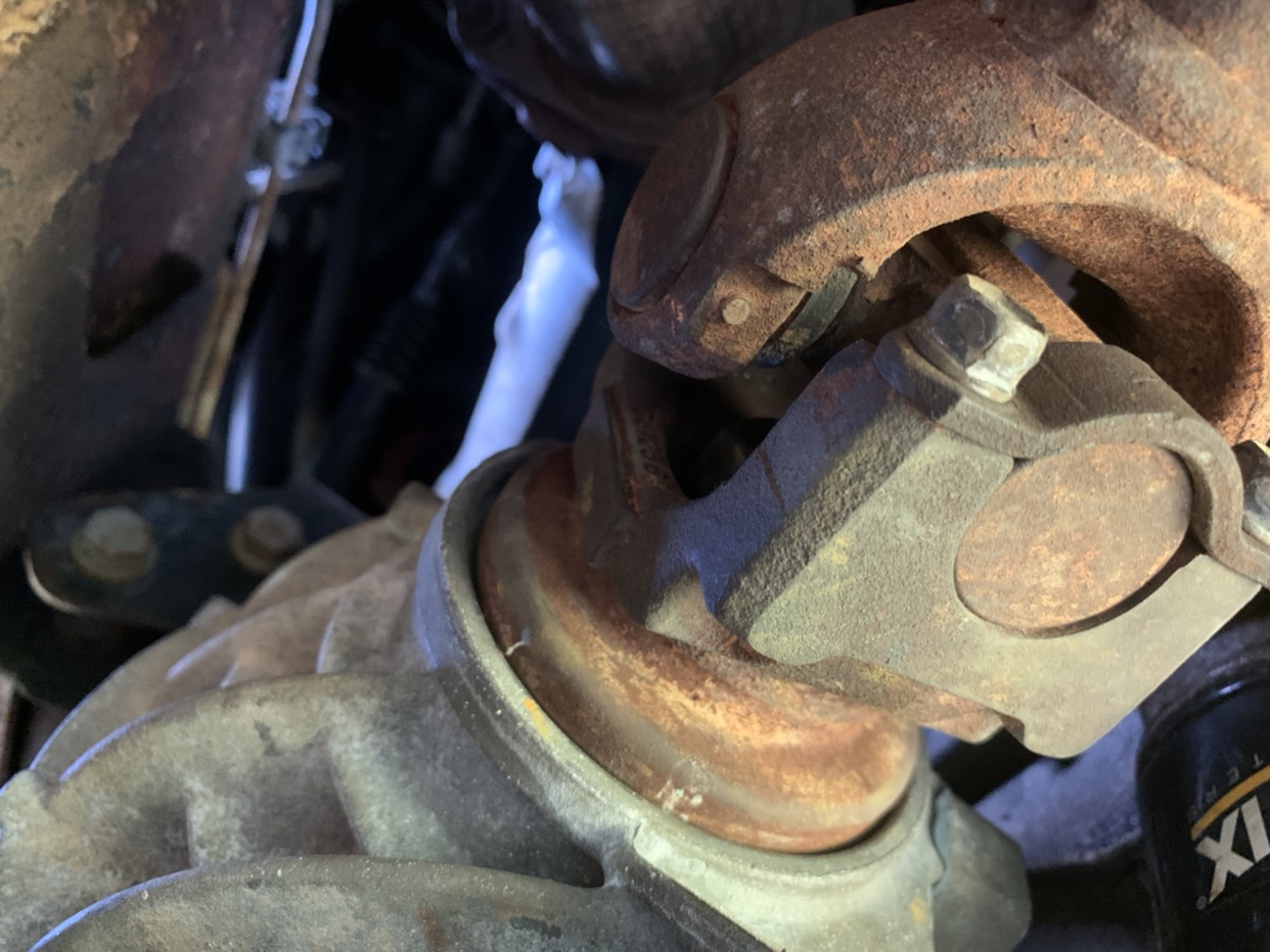

I attached pictures of my u-joints, they’re original however my front diff has been removed from my truck twice since new so it may not be set up as original

View attachment 26434View attachment 26435
Thanks. From these pictures I don’t see what he is talking about. I told him to send me a picture of the new one when it arrives today.

Yea I’m like you, I’m not sure what he’s talking about, it looks very straight forward to me?
