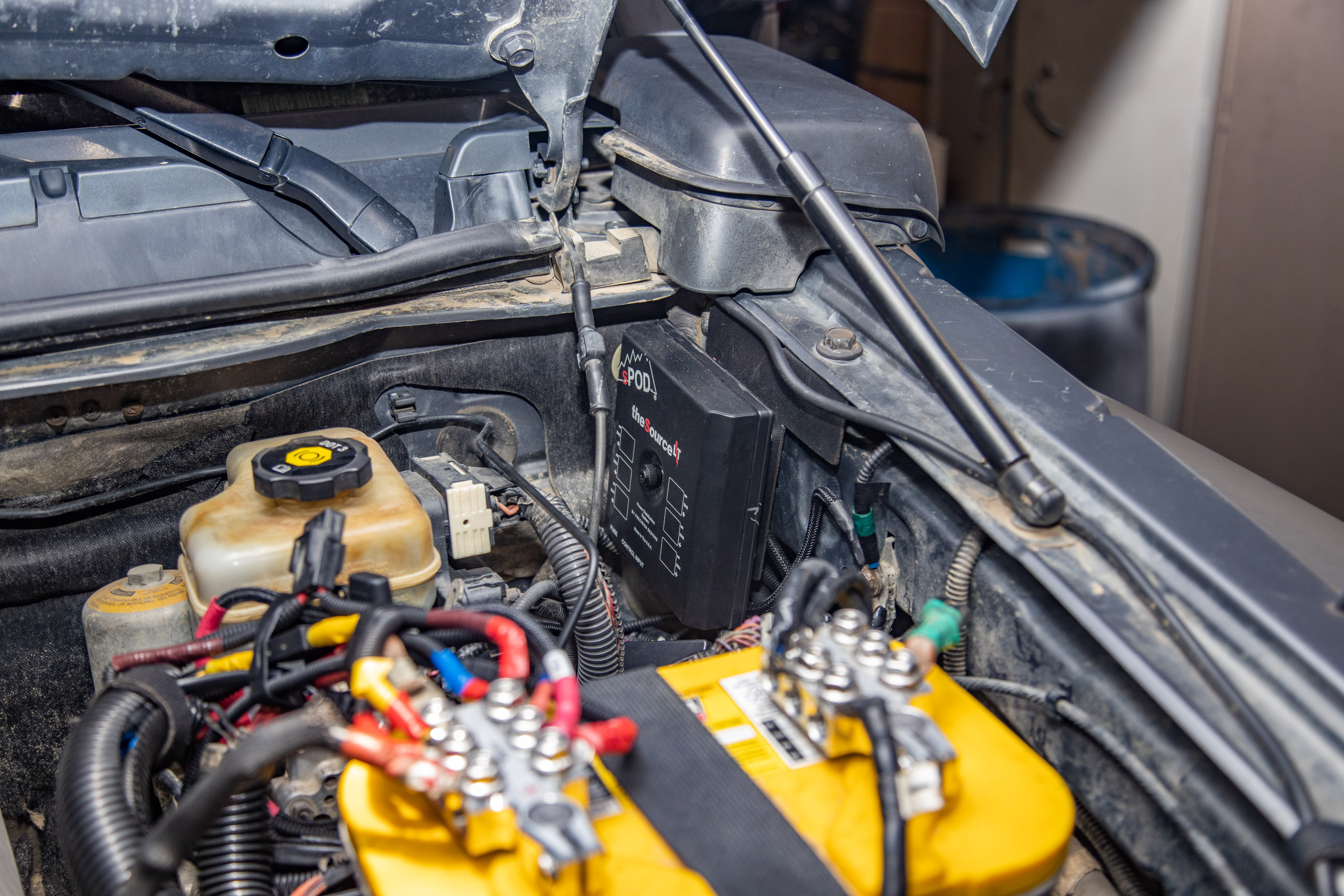

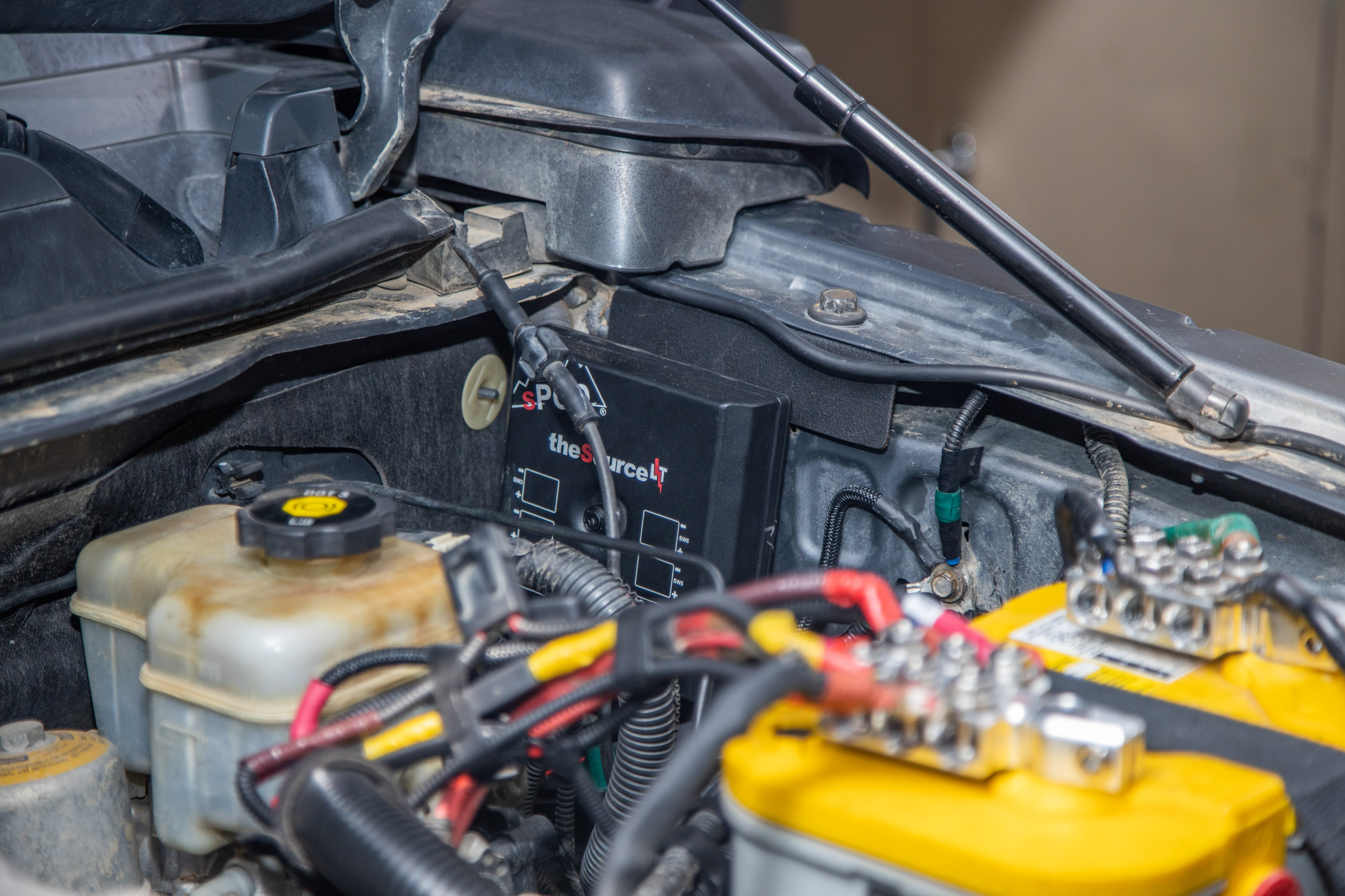

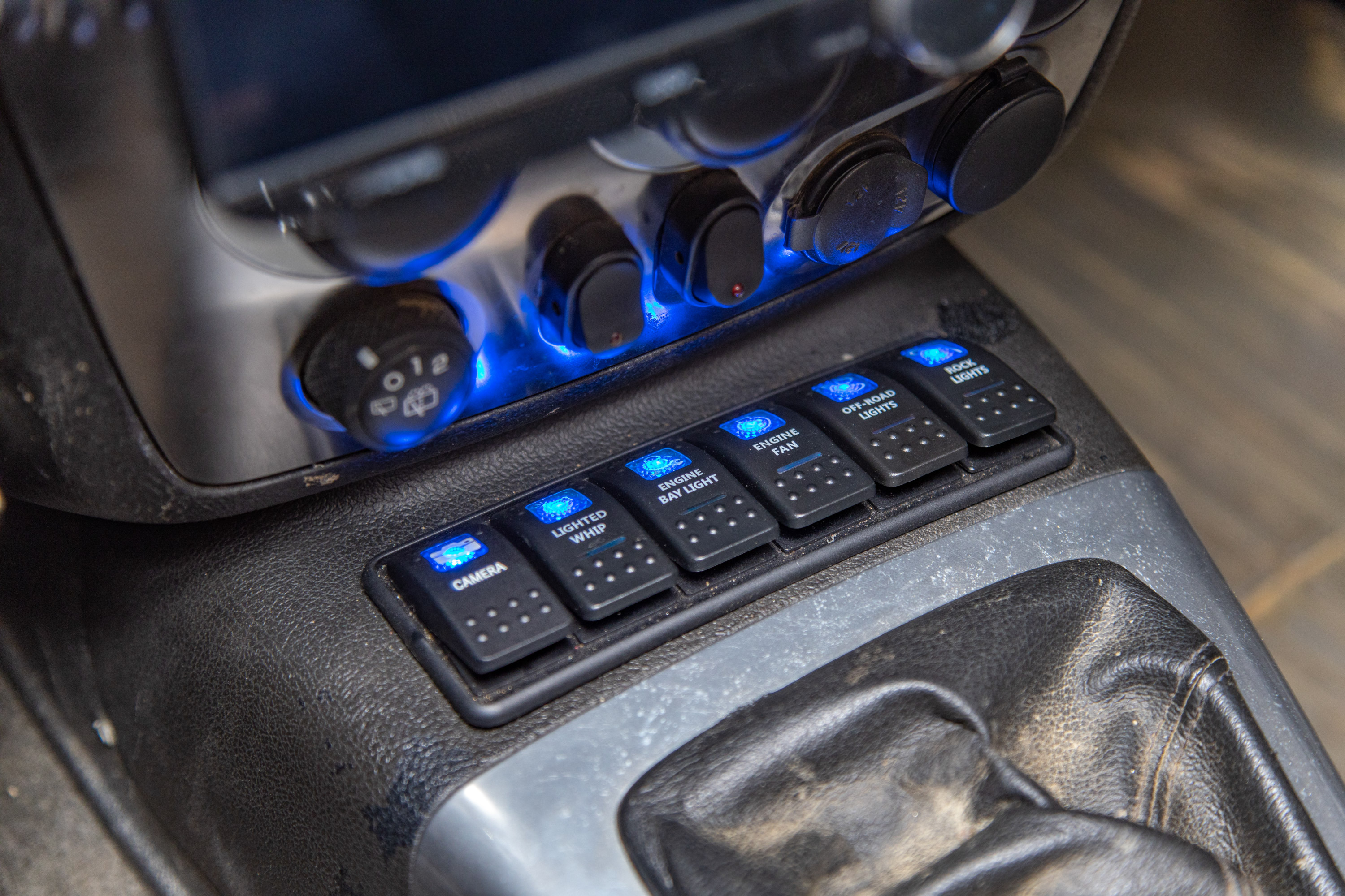

Hey everyone! I posted a new video on my YouTube channel installing a SPOD Aux switch system. I also took some pictures of the install. I know there is many, many different ways to go about doing this and there are different brands to choose from, but this video covers how all these systems work in concept. Let me know what you guys think.

That's a good looking install. You'd think it was factory. But I've had a question ever since I first saw your video. Is there any vibration or interior chatter in the console from routing out the corner of the bracket post?

I haven't had any problem with that actually. The shifter cover piece still stays in place very nicely even though I had to remove one of the clips that was holding it in place. No vibration noise or anything of the sort.
