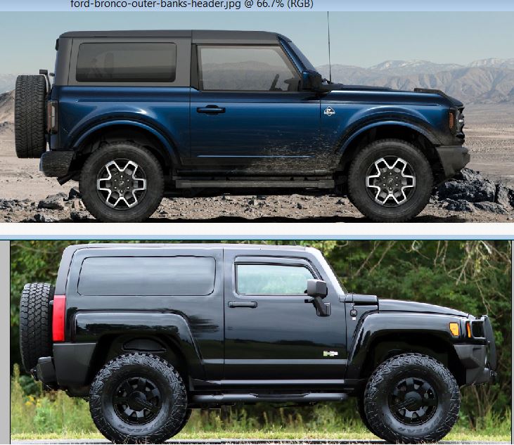

I have been tossing the idea around.....quick photoshop attached. I've seen the suv to truck conversions but wondering if anyone has seen this done? Longer fixed glass, gas tank, frame rails, suspension and rear seat would be some work but it would be unique!

No. But it looks like a fun project!! Love it!! What are your metalworking skills? It really wouldn't be any more difficult than any other 'custom' or street rod if you've done one of those before. You could sell the rear doors to help fund the project.
You might want to play around with photoshop to see what it would look like with maybe a couple more inches behind the front door. Play with different ideas. It looks juuuuuuust a schootch short to my eye. I might add a couple more inches behind the driver's door. YMMV. I've seen a number of 'shortened' projects in real life where if they're too short they can look like clown-cars. ha ha. Something you want to avoid. But obviously personal preference. A good parallel might be the Bronco 2dr & 4dr's to compare.
Another 'trick' approach a guy might consider to fill that gap the 'easy' way might be to add a short 3rd (hinged) driver's access door from, say, a Colorado pickup (or S10 pickup) ...with matching outer sheet metal of course. Or not.. just throwing out ideas. Looks like a fun project.

the H3T concept is awesome and if I could use a 2 seater more often I would probably go that route too. I have been playing with the dimensions trying to avoid the clown car effect but now that even Jeeps are almost all 4 doors, almost everything looks like a clown car/short bus in a 2dr version to me from the side.2dbronco.JPG

the H3T concept is awesome and if I could use a 2 seater more often I would probably go that route too. I have been playing with the dimensions trying to avoid the clown car effect but now that even Jeeps are almost all 4 doors, almost everything looks like a clown car/short bus in a 2dr version to me from the side.View attachment 27991
The H3 needs the rear axle pushed back 5-8 inches, to reduce the rear overhangs and to not look so squished. Look at how the Bronco looks more proportioned. Plus the added wheelbase to a short vehicle is a huge help.
By the time you do all this and the time & expense, you could probably buy a new 2 door Bronco.
Btw the glass would not be the Al hardest part to source as the glass is flat. Lots of guys take the older full sized “OJ” Broncos and stretch them to get more wheelbase to make as a Prerunner. They stretch the rear side windows and get cut to made glass with no problems .
