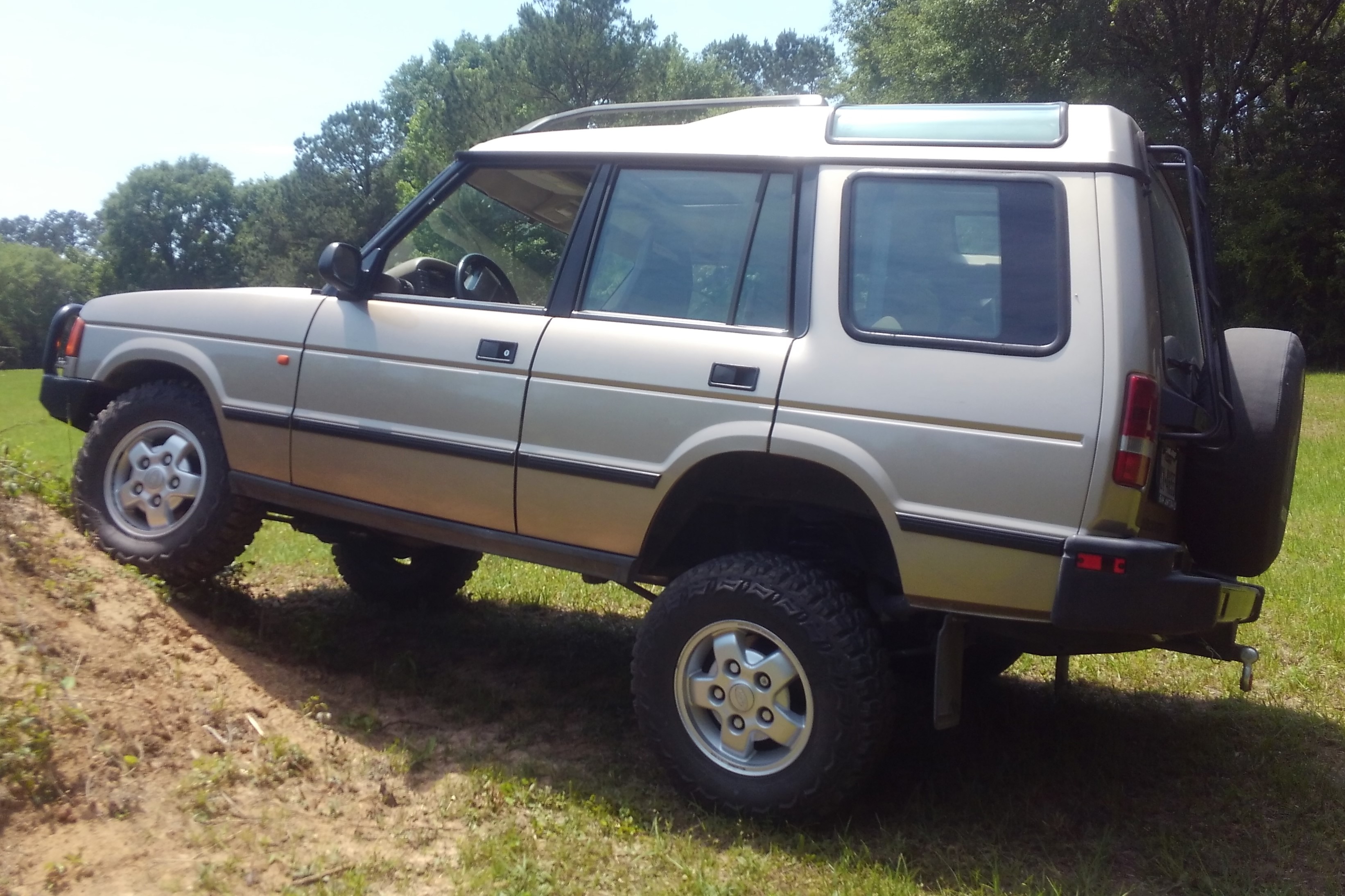

This is my nearly pristine 95 D1. When you look at it inside/out there is no way it looks 25 years old and it certainly doesn't drive like one. The pics above are how it looks now. It was 100% bone stock when I got it. I had to do some engine work straight away, but it wasn't anything I'd call serious and once I found out what it was it was VERY clear it was not the LR's fault but a techs fault from what I can tell around 07 according to the service records it came with.

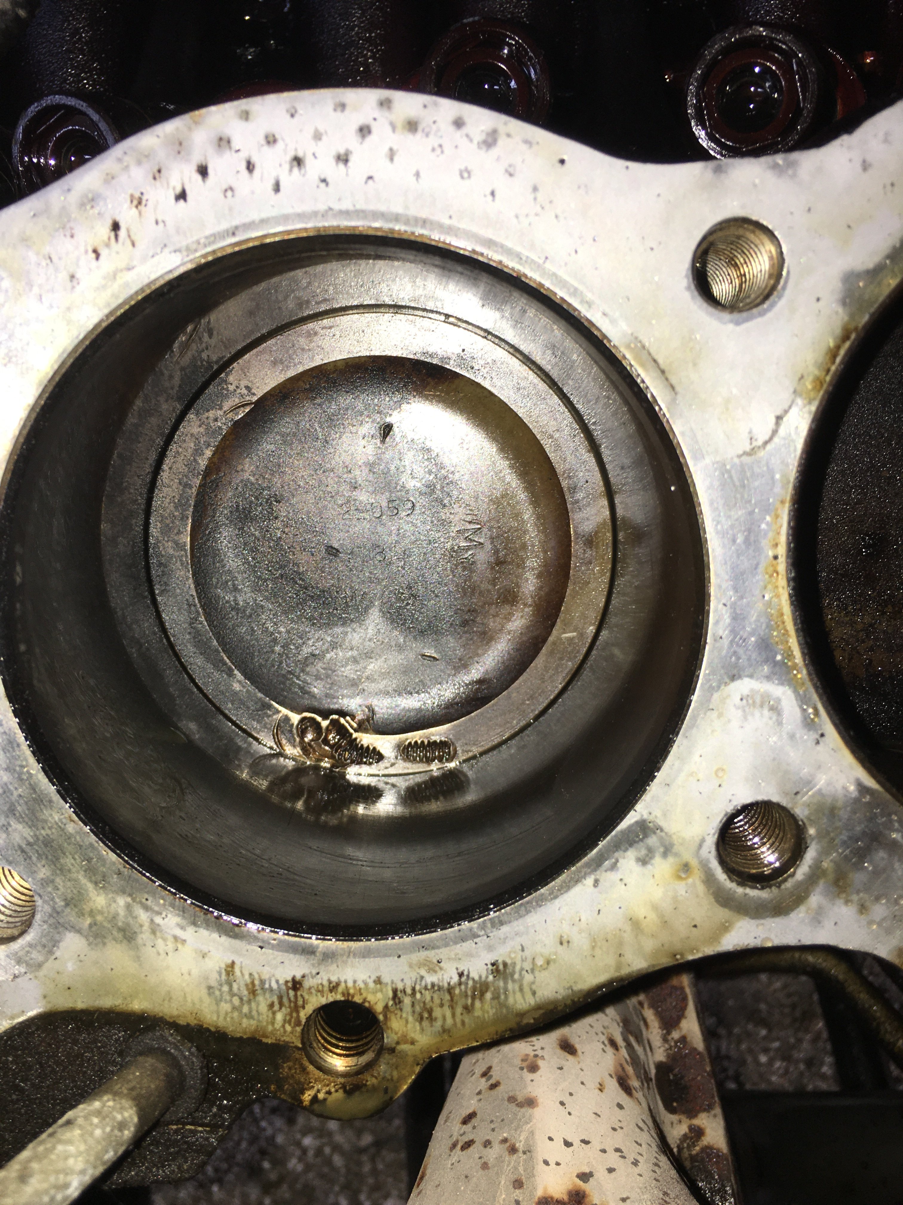

When the engine was warmed up it knocked pretty bad. It was extremely well maintained with a ton of service records. The last service it had before the documented tick/knock was noticed was back in 07. It went in for a simple valve gasket replacement and valley gasket. Apparently the tech dropped what looks like an old valve cover bolt into the engine, put it all back together, and fired it up. The shop did not document the issue, but when you looked at the engine it was obvious the drivers side head had been taken off while the passenger side looked untouched. The shop replaced the head, but they left the piston. Shortly after the documented repairs for the gaskets a regular oil change service documented an engine tick, and eventually it was documented as a severe engine knock. The last service receipt I found highly recommended the engine be completely torn down and all the bearings be replaced along with lifters and the cam.
Once I had the head off cylinder #5 told the story lol. I dropped the oil pan, removed the piston to find all the rings cracked in at least 2 places, and once I got the carbon build up off the piston itself you could see a crack across the middle of it and down the side. The cylinder wall/sleeve was completely untouched by the disaster and it survived from 07 just like that until 2019 when I tore it down. I replaced the piston, the lifters, and did a HG job along with a complete valve job on the heads. Put it all back together and she's good to go. The engine was very very very clean inside and the only issue I found was with cylinder #5.
It just goes to show the best shop in the world can have your vehicle, but it all comes down to who is actually working on it. The work was done at a very well known LR shop in San Antonio.

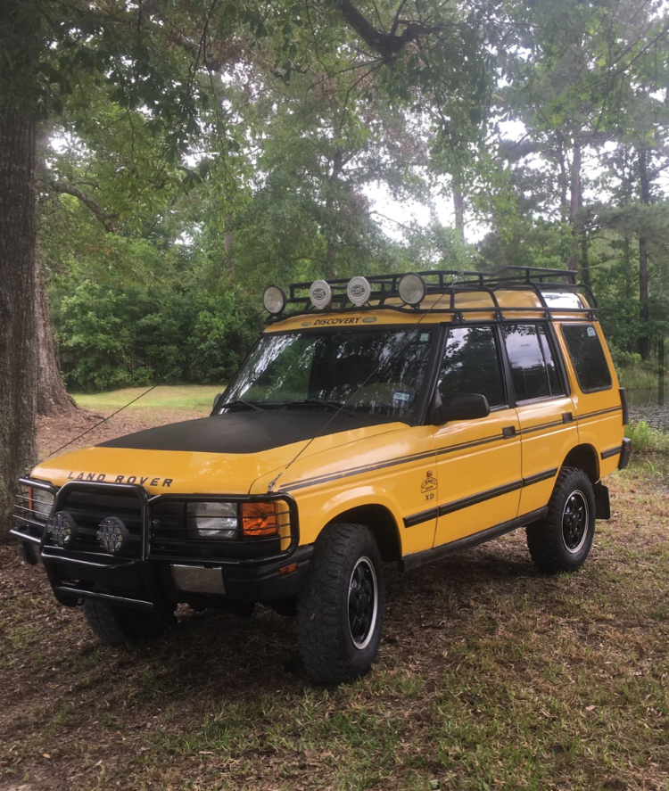

My fleet minus the 95 D1 and my wife's 06 LR3
The black one had water over the hood and just below the windshield wipers during Hurricane Harvey and that was before I had the snorkel. I didn't get water inside of the D2, the air filter never even got damp, and the axles, engine, transmission, and transfer case didn't get any water into them either! I had to drive thru that high water 6 times and it was at least 3/4 of a mile long. Had people been stopping traffic and allowing traffic to flow one way at a time it wouldn't have been so bad, but air boats would pass you, or people in front of you would just come to a stop!!! It was very very hectic to say the least and I was only doing it because we had no choice at the time. Lucky for me all she needed after all that water crossing was a new CPS sensor. I couldn't get one locally for months so a friend on a LR forum sent me one immediately and she was good to go after that.
The 2 yellow ones are extremely rare. One is an 02 D2 Kalahari Edition (one of 150 ever made) while the other one is a 97 D1 XD (one of 250 ever made) both are what Land Rover calls Special Vehicles. Made in limited #'s with unique one of a kind parts. The 02 is nearly flawless with 237K on it. The 97 sadly is a rust bucket as it came from Iowa. One day I would like to get a rust free body and transplant it onto the XD. I'm just honored to have 2 limited edition LR's.
