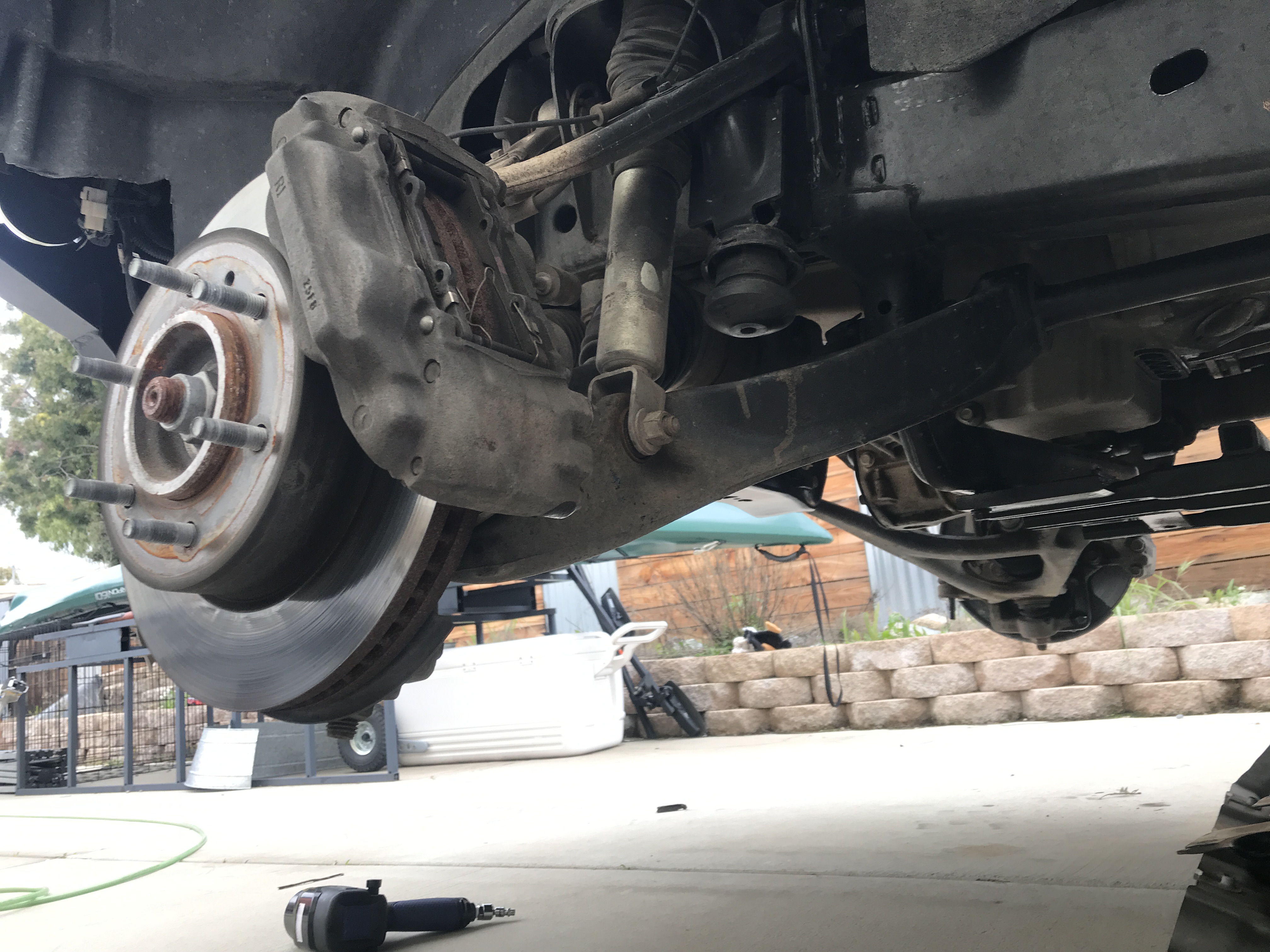

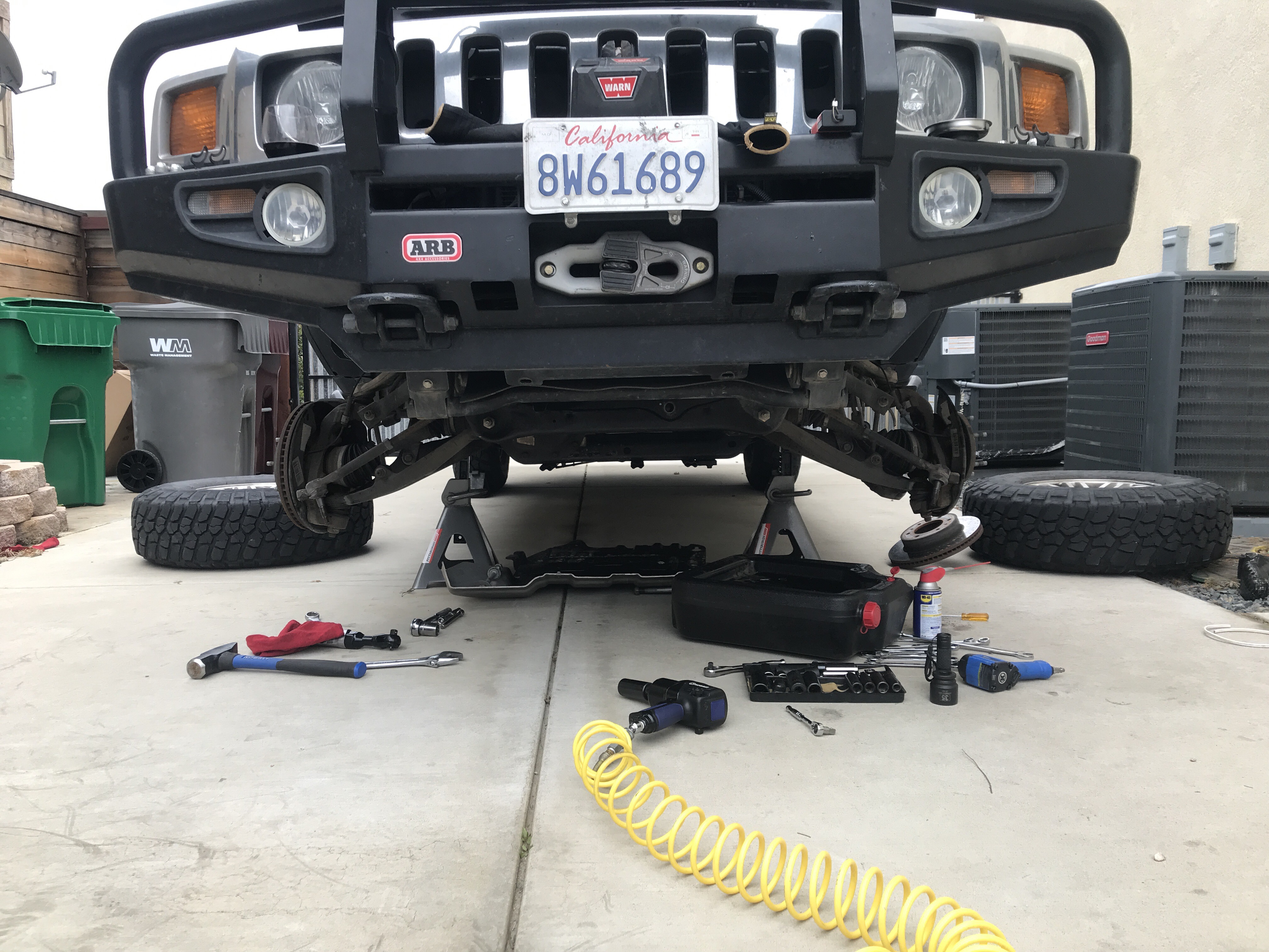

Ok folks, I have an H3T, bought it new, now at 166K mi. Steering rack bushing finally went, and I’m replacing it. I have everything unbolted except for the top bolt on the passenger C clamp. It’s a 3.7 engine. Can anyone describe how to get to the top bolt to get it undone. For the life of me I cant figure out how to get a wrench on it........
10,650
If you don't have access, it can help to unbolt the diff (3 bolts) and disconnect the front prop shaft, and slide the diff back an inch or two. That will give you the access. Sounds like a pain but should only add 20 or so minutes.

Got it out without moving the diff, I used a flex handle socket wrench and a 15mm socket with a built in universal. Thanks for all the replies!!! On a side note, nobody has the reinforcement bracket or upgrade bushings for sale, I’m bummed that I’ll have to put the new rack in without it.
