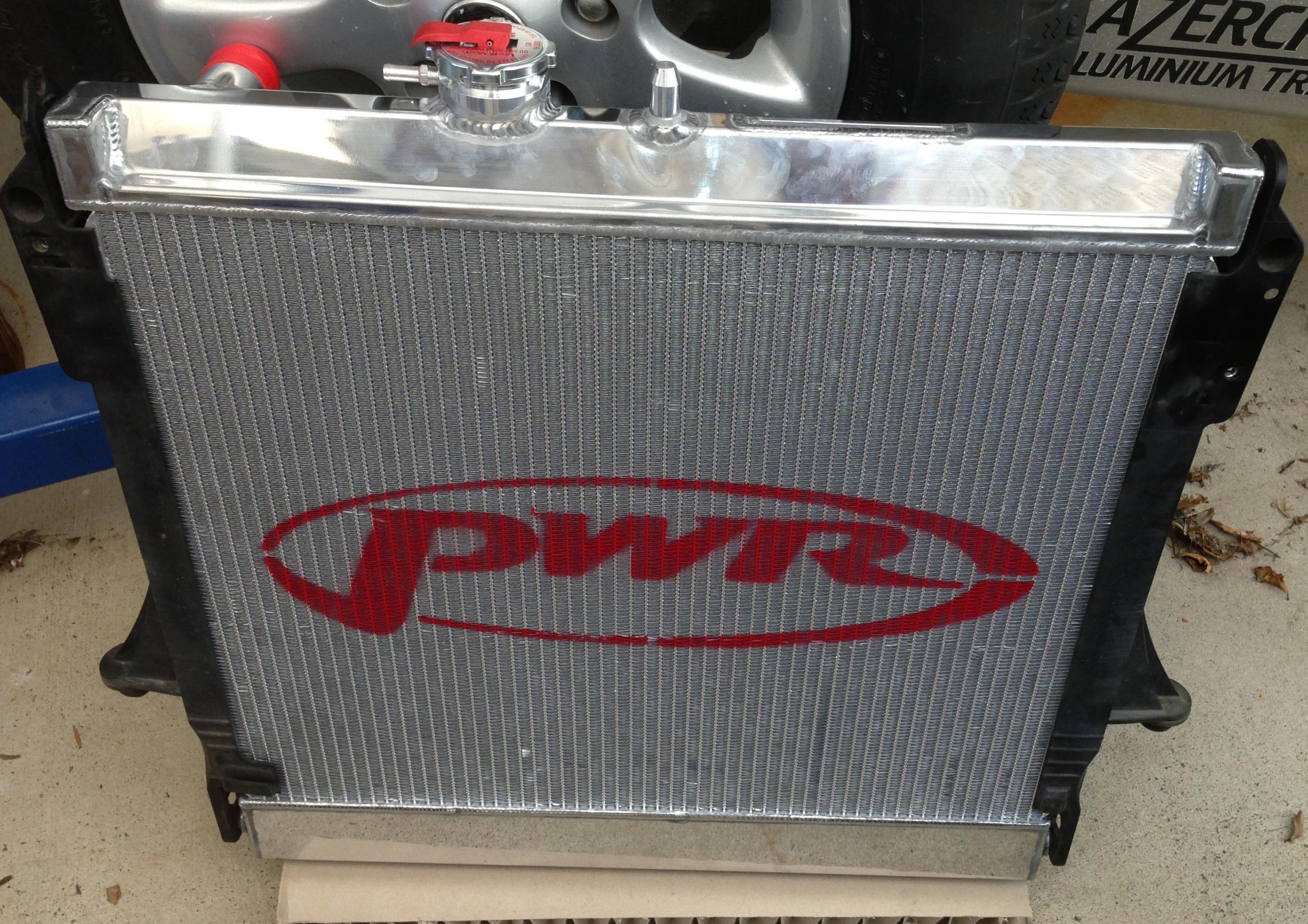

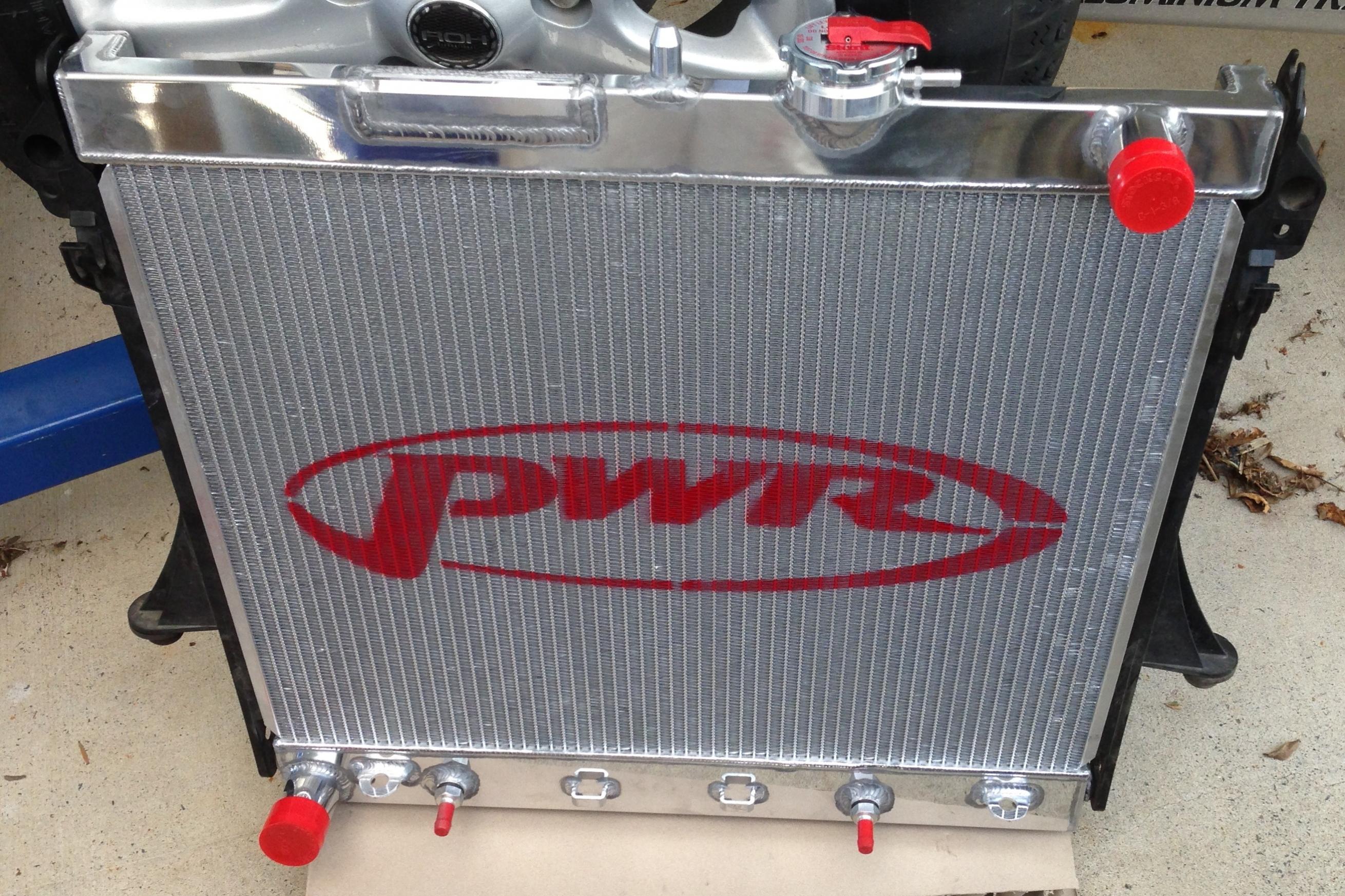

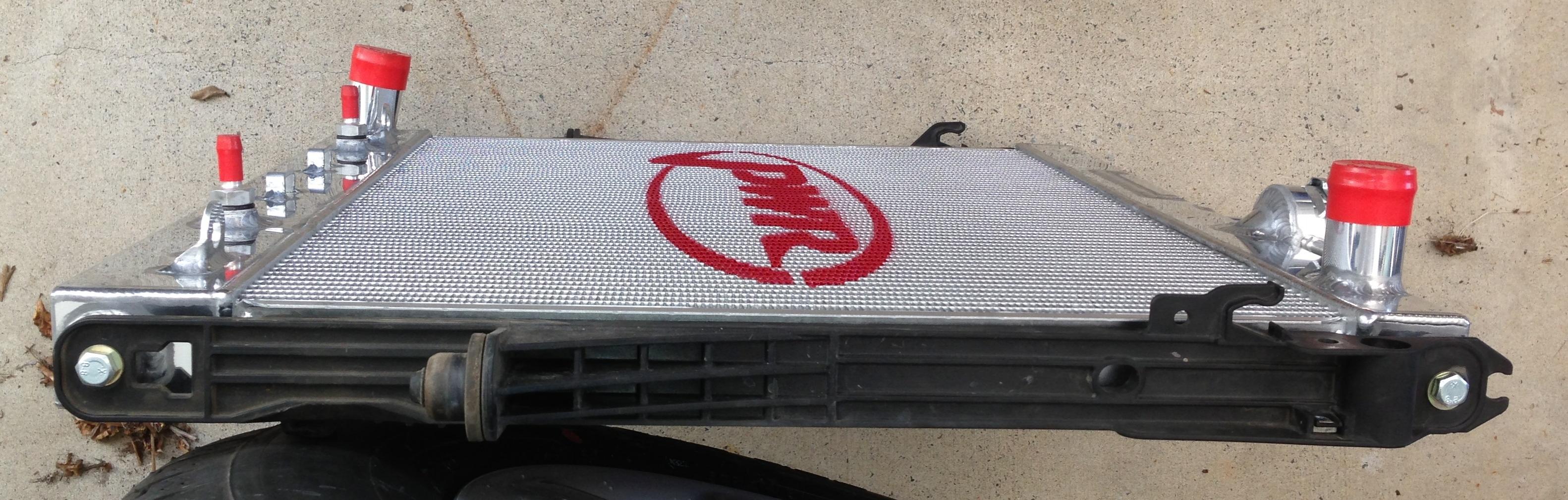

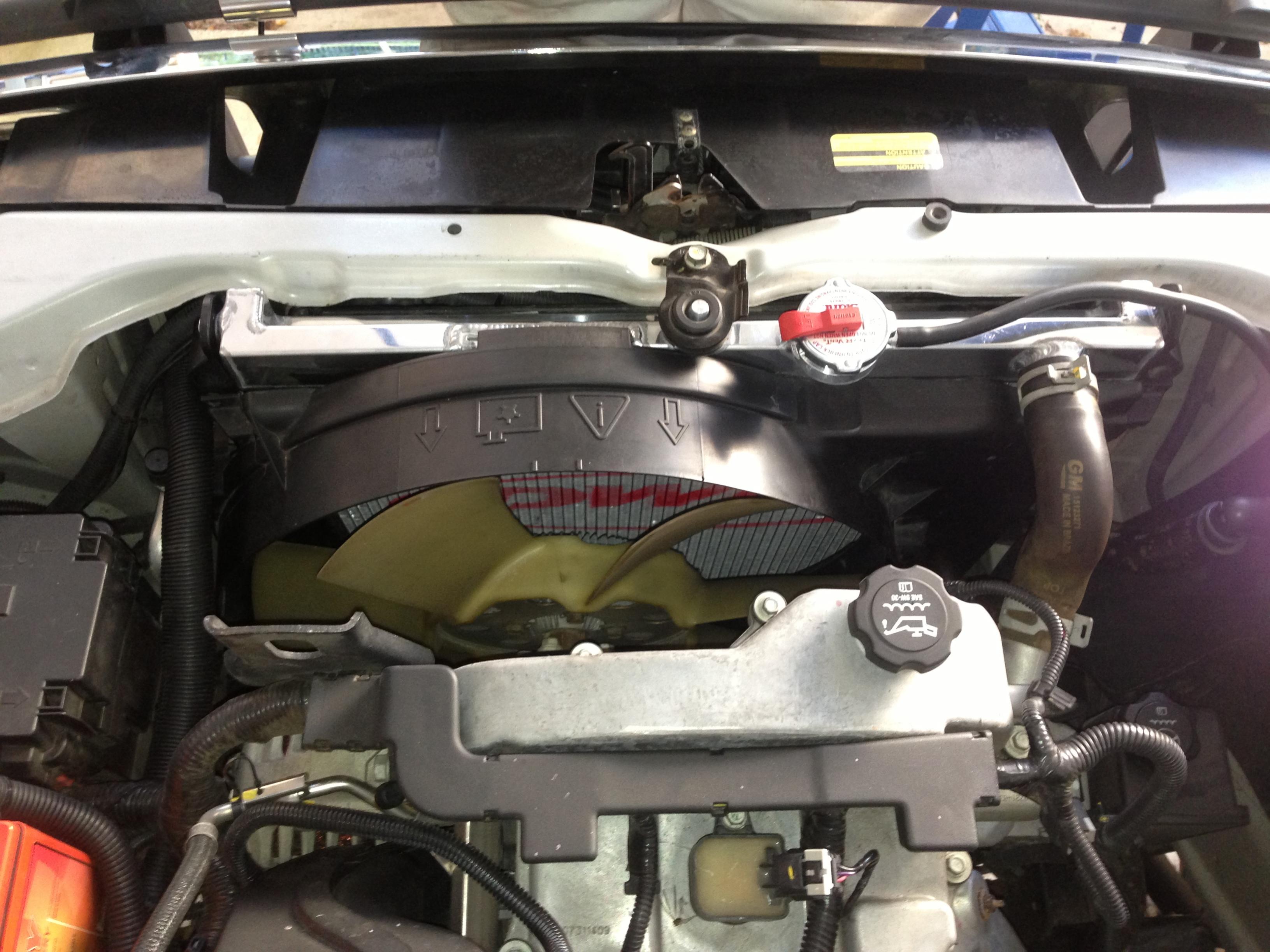

PWR Radiator arrived this week Lug Bottom.jpgLug Mount.jpgMount Front.jpgMount Rear.jpgRear.jpg You have to take the side mounts off the OEM radiator & I had to get 2 more bolts (M8 1.25 x 20mm) as the bottom uses the bolt mount rather than the lug mount

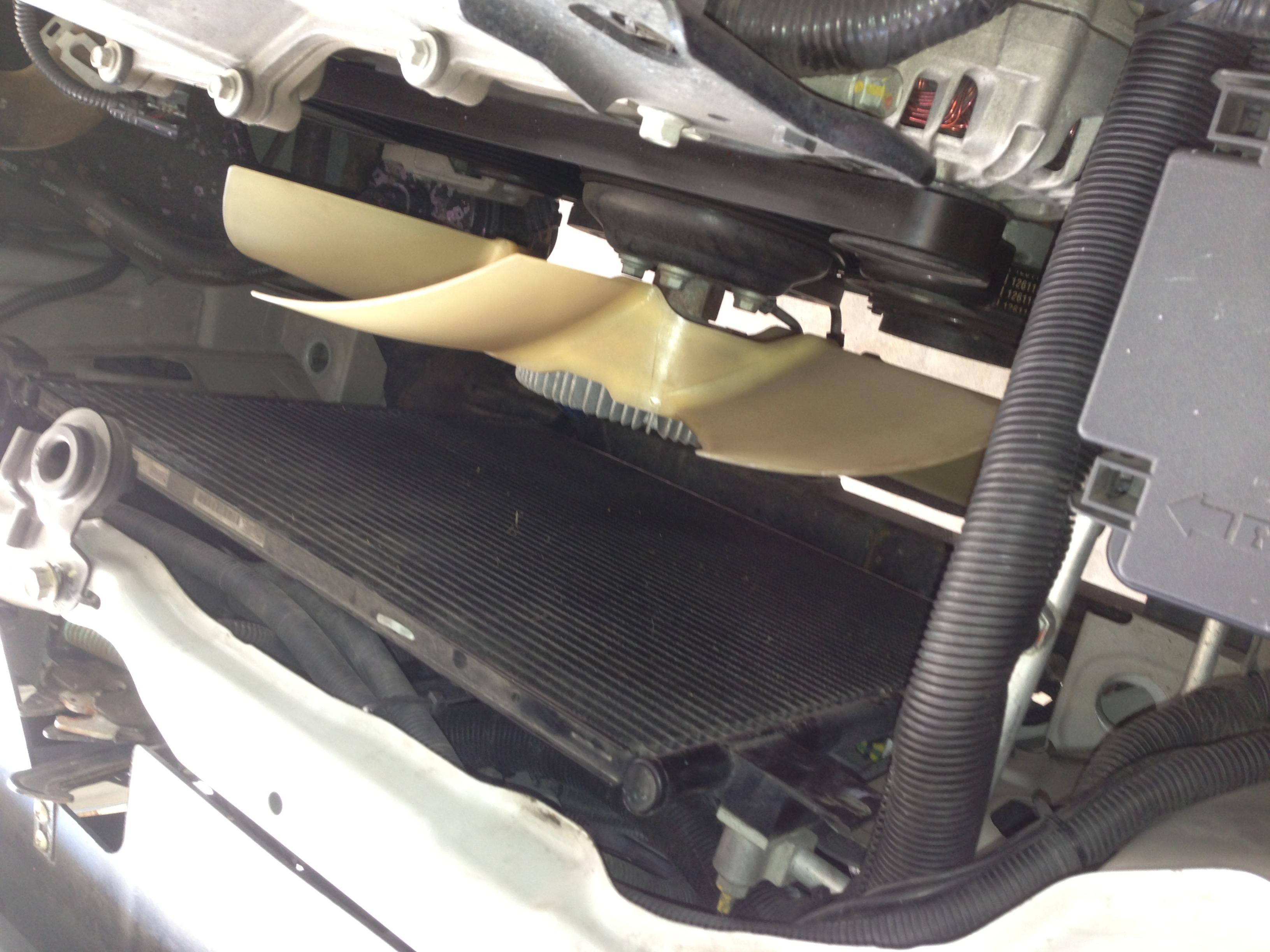

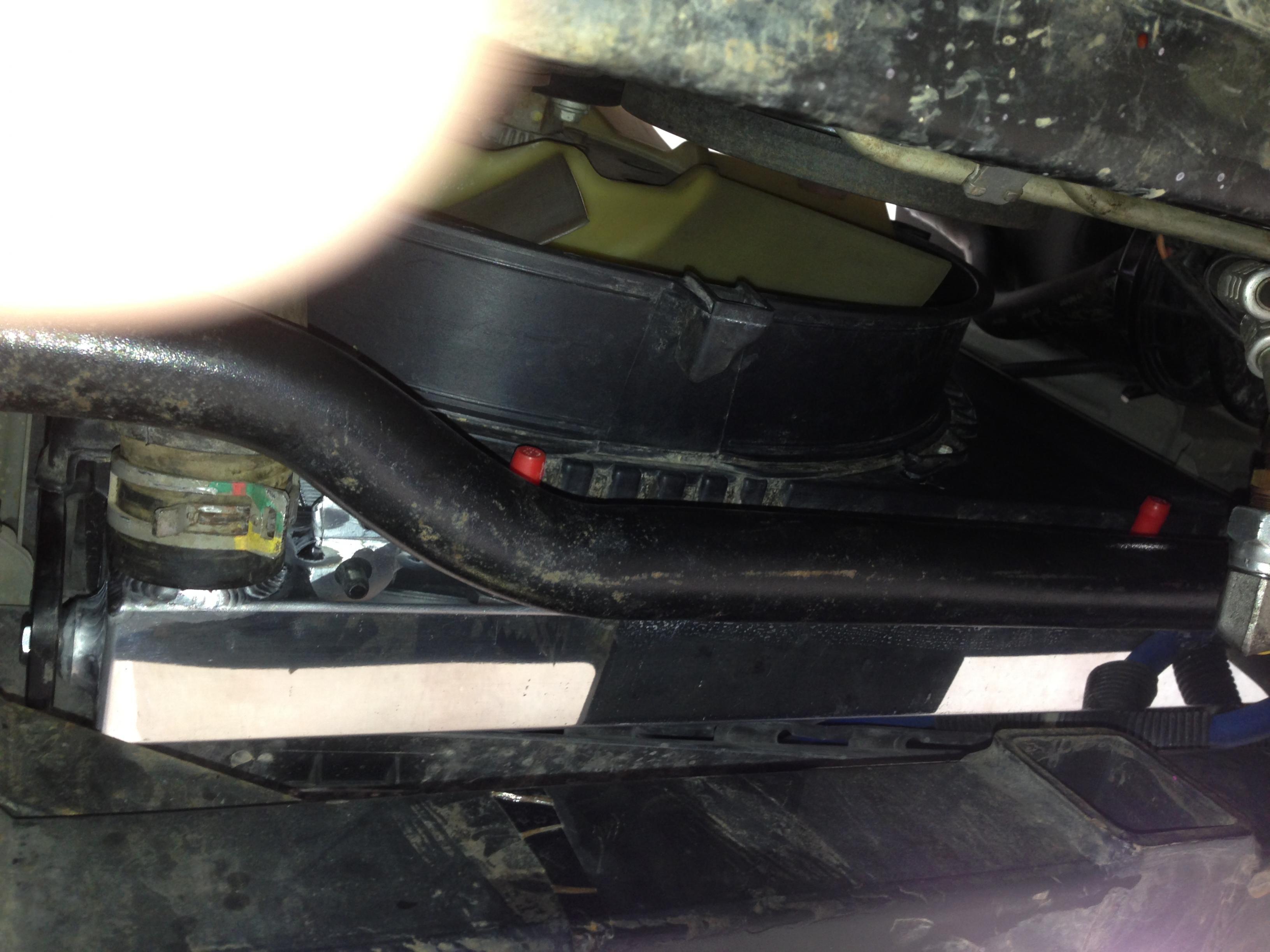

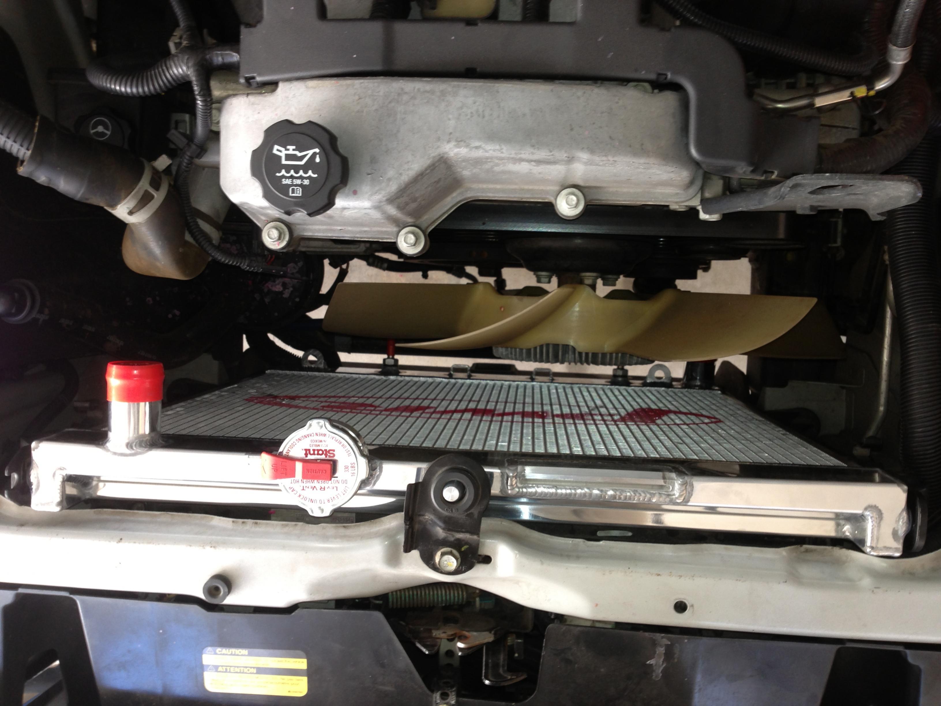

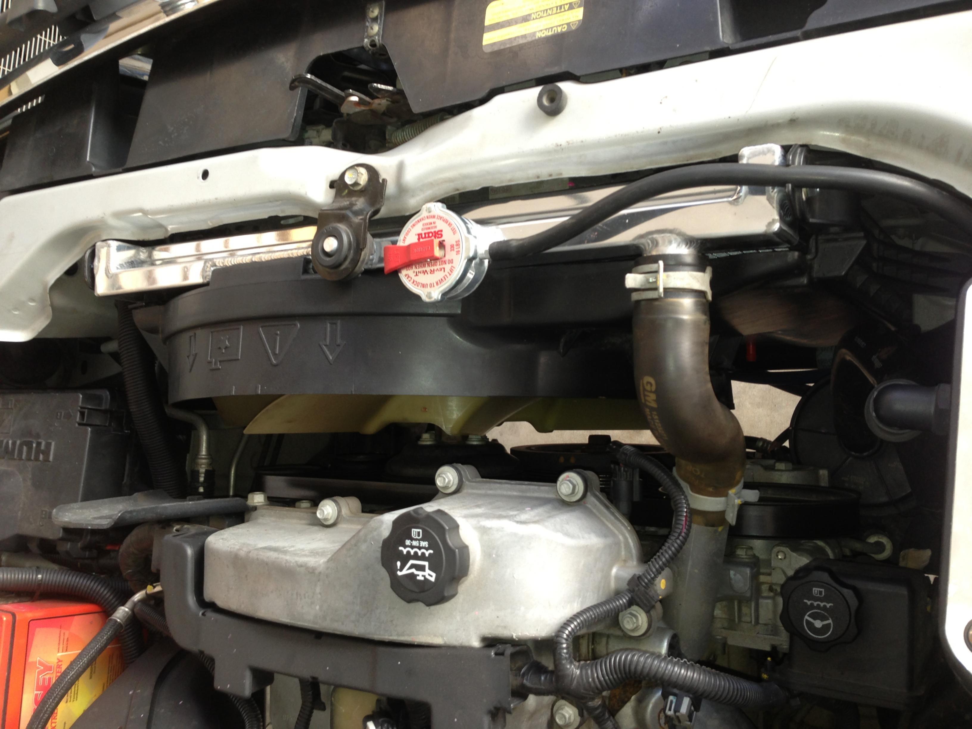

Here are some shots fitting (note manual says to remove fan but you can remove replace without taking the fan out as the bottom fan shroud rotates to the top) Condenser.jpgEngine.jpgRHS.jpgUnder Shroud 2.jpgFinal Top rear.jpgFitted Top.jpg

Just posted the fitted pictures above. Install went well, only inconvenience was the condenser to radiator bolts because of the mods/accessories I had fitted.
