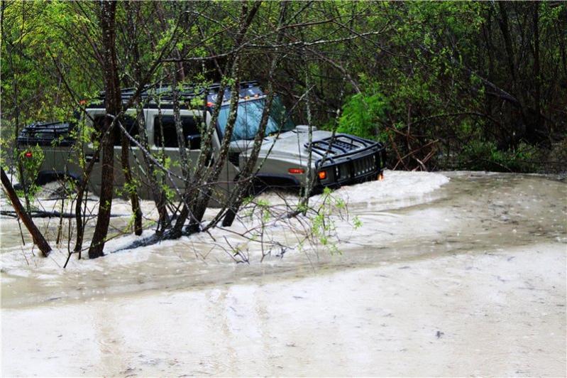

I got the code about two weeks after this water crossing when I was filling up with fuel, the evap canister started to leak a ton of water out of it. Once I removed it an cleaned it out as much as could, the code went away and has never returned.
