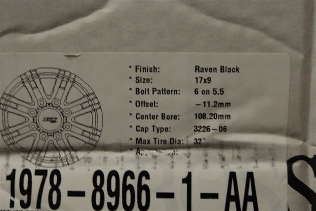

The Rancho Installation doc :link: says "N. The recommended tire size for this suspension system is 35” x 12.5”. The maximum wheel backspacing is 5 inches on 20” wheels and 4.5 inches on 16”, 17” and 18” wheels. For 37” tires, trimming the fender is required." There is also a figure that illustrates how backspace is defined.
If you plan to wheel it off road, I'd recommend the smaller rim diameter to get more sidewall and less potential to damage the rims. Therefore, my first choice would be 16", followed by 17" and 18". Keep in mind the tires will stick out about 1.34" more that with stock backspace (I have stock 5.84" backspace with 315/75R16 tires and they stick out a little, so photos in my build thread). Going to 20" allows 0.5" more backspace so it would reduce how far the wheels stick out of the fenders from 1.34" to 0.84".
Thank you very much. This information is greatly appreciated. With the wheels sticking out 1.34" more than stock, will the tires stick out even further than that since 35x12.5 are recommended?
