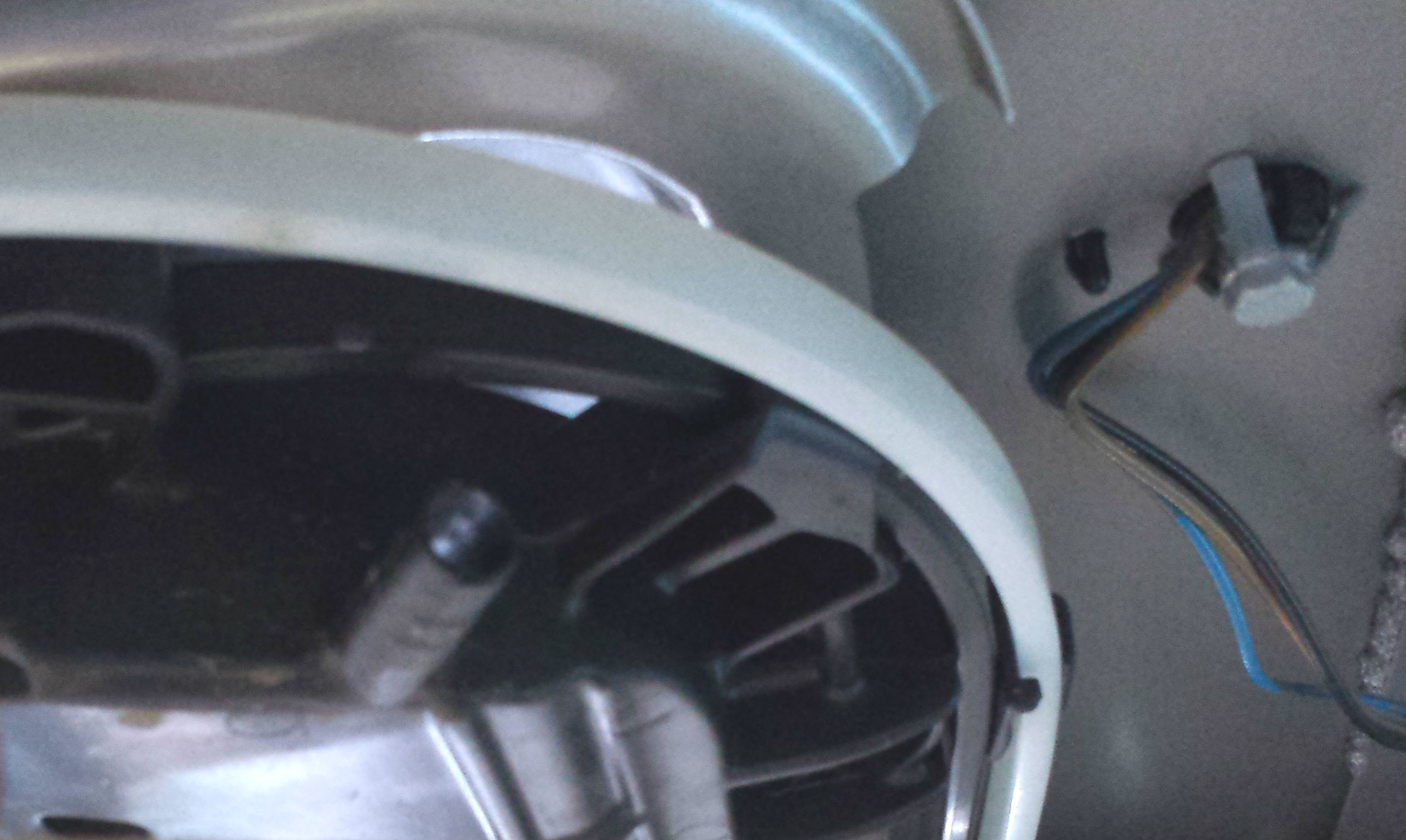

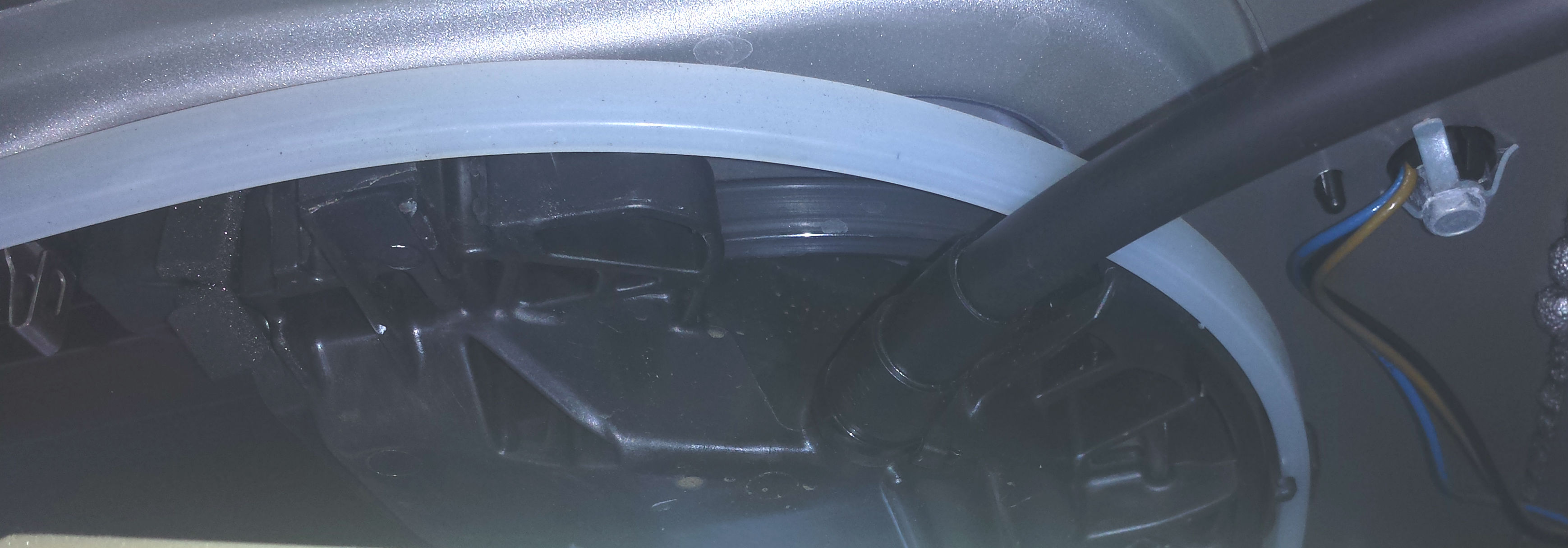

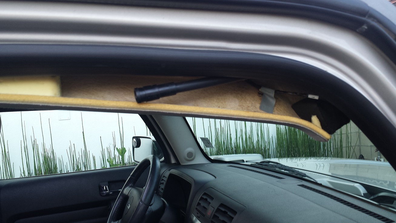

So I thought I had fixed my leaking drain for the sunroof. After a bath last weekend the carpet was wet again. So I started with a small piece of 14 gauge wire to push through the tube, after I heard it wiggling around the head liner I knew the problem. The tube had come free from the drain fitting. All my own fault.
I cleaned off the dirt, added a dab of sealant, and zip tied it to the fitting. That should keep it on.
Note to everyone else. DO NOT USE AIR OR STIFF WIRE TO CLEAN THE DRAIN.

I think he just cleaned the drain nipple. He didn't use air or a wire because he didn't clean the tube, just the end that goes through the sheet metal.
2,823
Y o u c a n u s e a i r o r w i r e o r w h a t e v e r y o u w a n t A F T E R i t h a s b e e n p u l l e d f r o m t h e s u n r o o f f i t t i n g.
2,823
I have had a good track record with the air method. I set my regulator to low pressure (20 PSI if I recall). My truck primarily lives in the city so there is little chance of dirt getting in them.
Air worked on the drivers side. Not sure if it was the air or wire that pushed the tube off of the fitting.
Okay...I get it now. I thought maybe you used a .22 caliber bore brush or some other method. Regardless...pulling the headliner down sounds like a helluva job. Basically...be gentle and don't blow the hoses off the fittings.
2,823
You only need to pull part of the headliner down and it is easy. The zip tie and silicone are insurance to use air in the future. As for the bore brush, I tried that too but it is too stiff.
