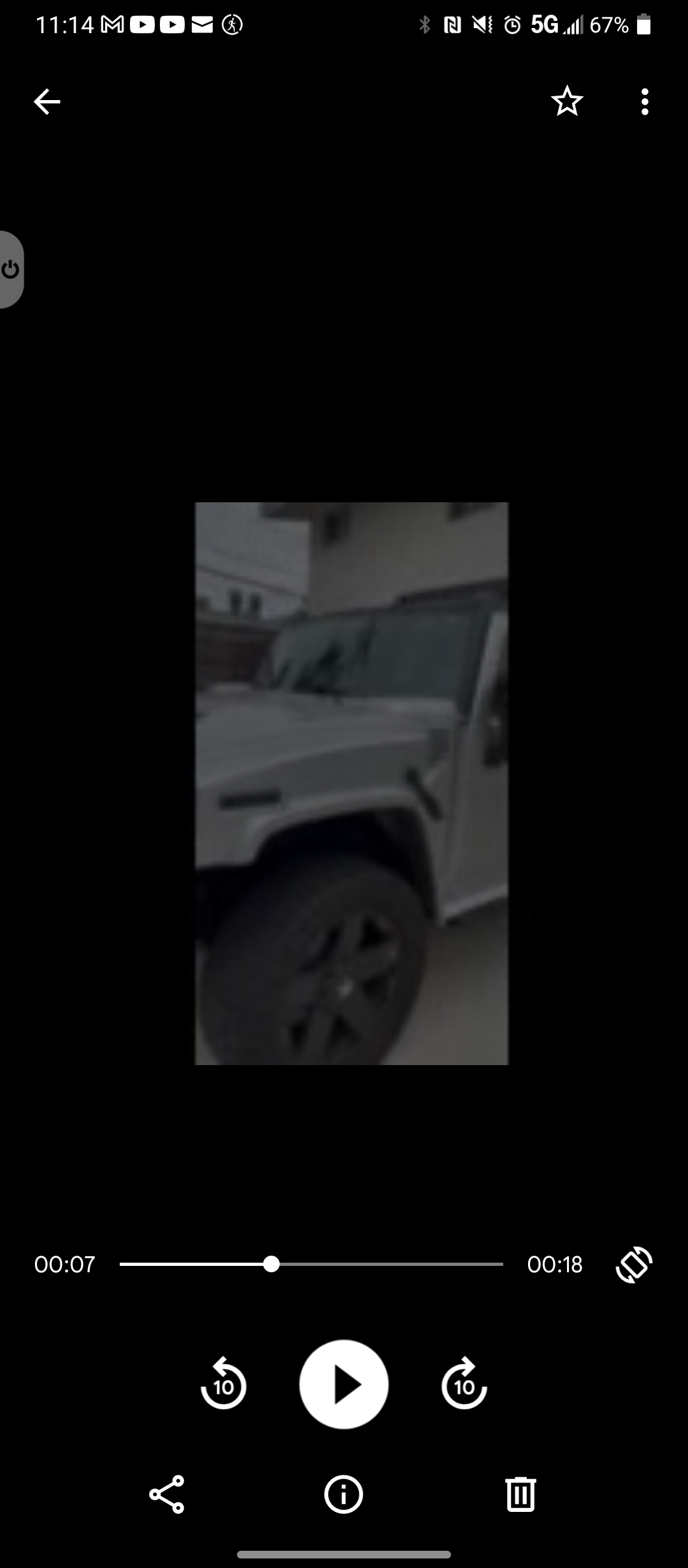

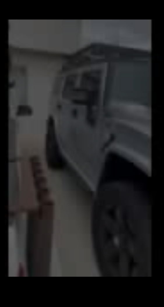

Hi Everyone, I've got a H2 that has 37's so I'm going to install 4.88 gears in about a week and get it re-tuned / programmed for the gears. I'll post a picture of it shortly
Iwillnc
236
Hi Everyone, I've got a H2 that has 37's so I'm going to install 4.88 gears in about a week and get it re-tuned / programmed for the gears. I'll post a picture of it shortlyView attachment 31143View attachment 31144
