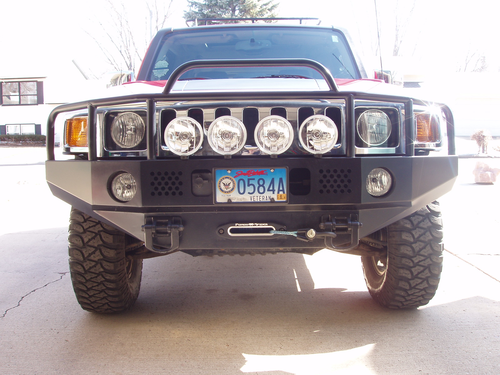

P1010045.JPGThe BA bumper is 12 gauge steel which is 1/8" I believe. I have had mine for almost 5 years and it is one of the best modificaions I have done. The powder coating was crap. I sand blasted mine after two years and recoated it with Extreme chassis paint from Eastwood corporation. It has held up well. I also widened the fairlead openining a little and put on a billet hawse fairlead to replace the roller one. I also replaced the steel cable with 85 ' feet of amsteel blue synthetic line .

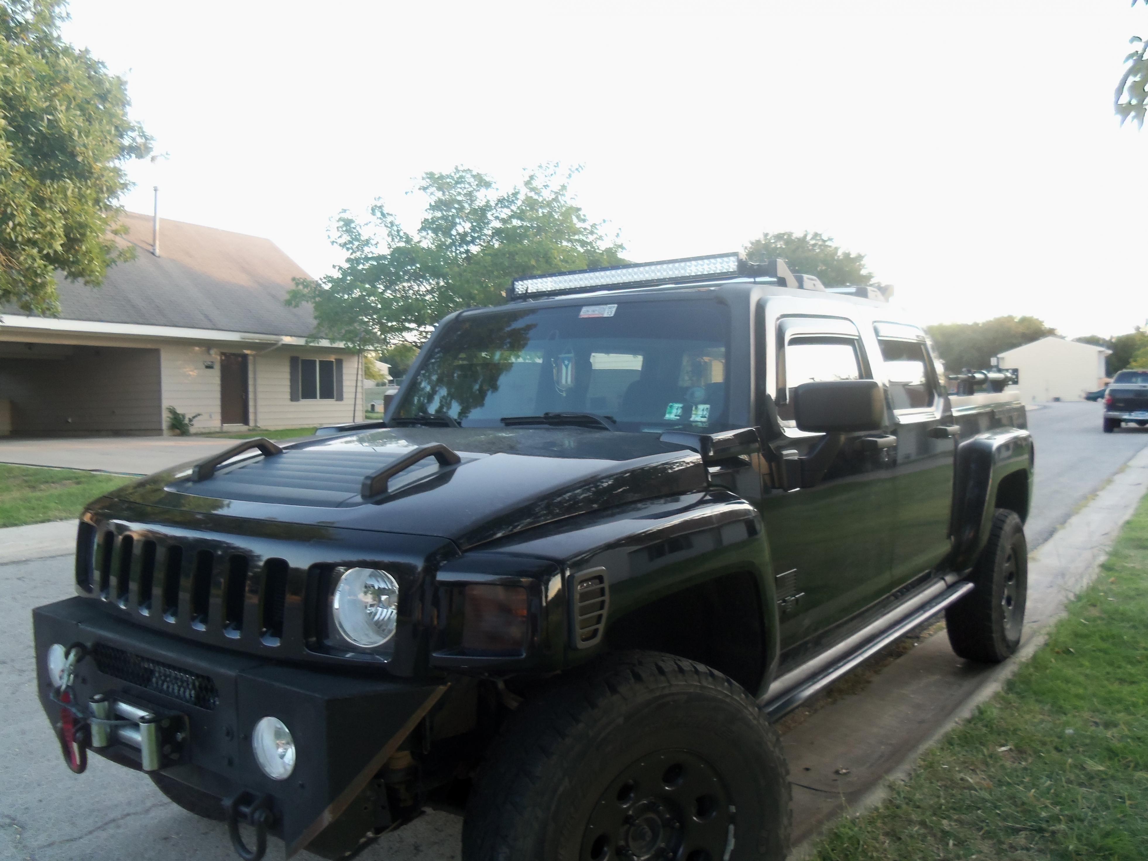

When I made the bumper for solid, I used 3/16. 14 gauge will bend easy if hit. The h3 can handle more weight then people think. My tough country is pretty thick metal plus a bumper made from 3/16 won't be as heavy as u would think. Gotta consider why u are building it...looks, protection, etc
True story!!!
