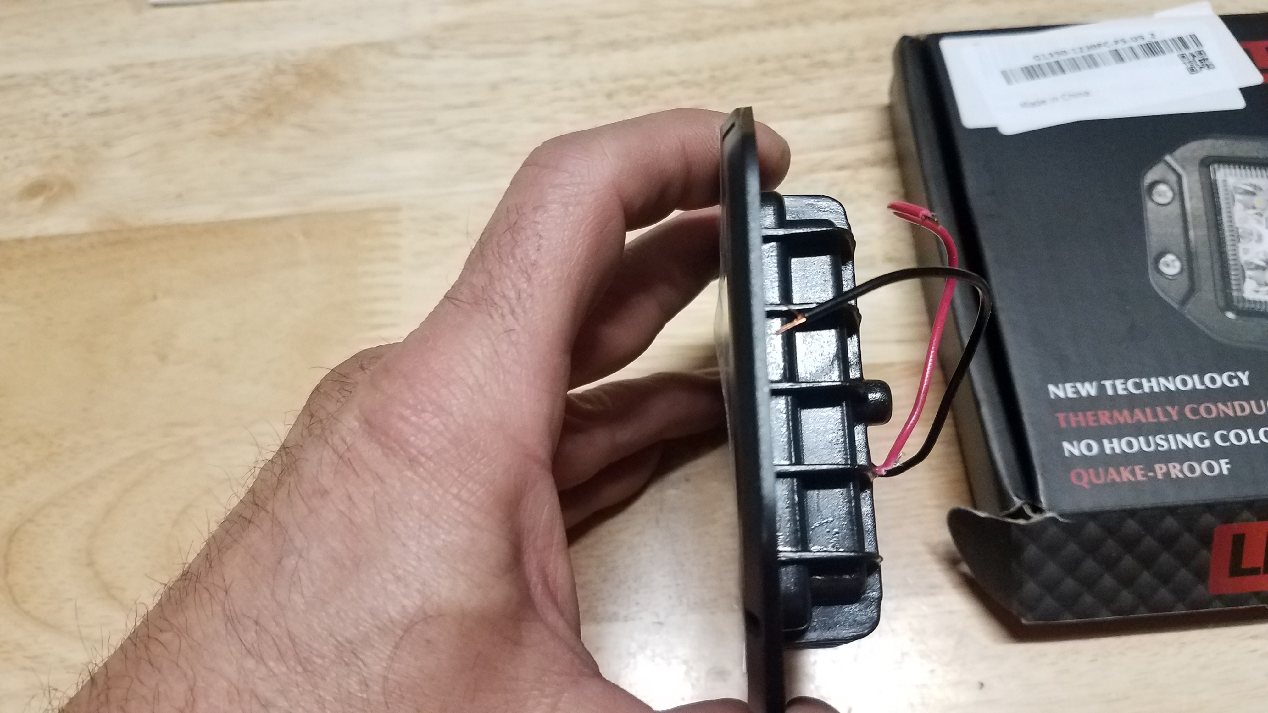

ordered new 160w rear trail lights will post up when they get installed

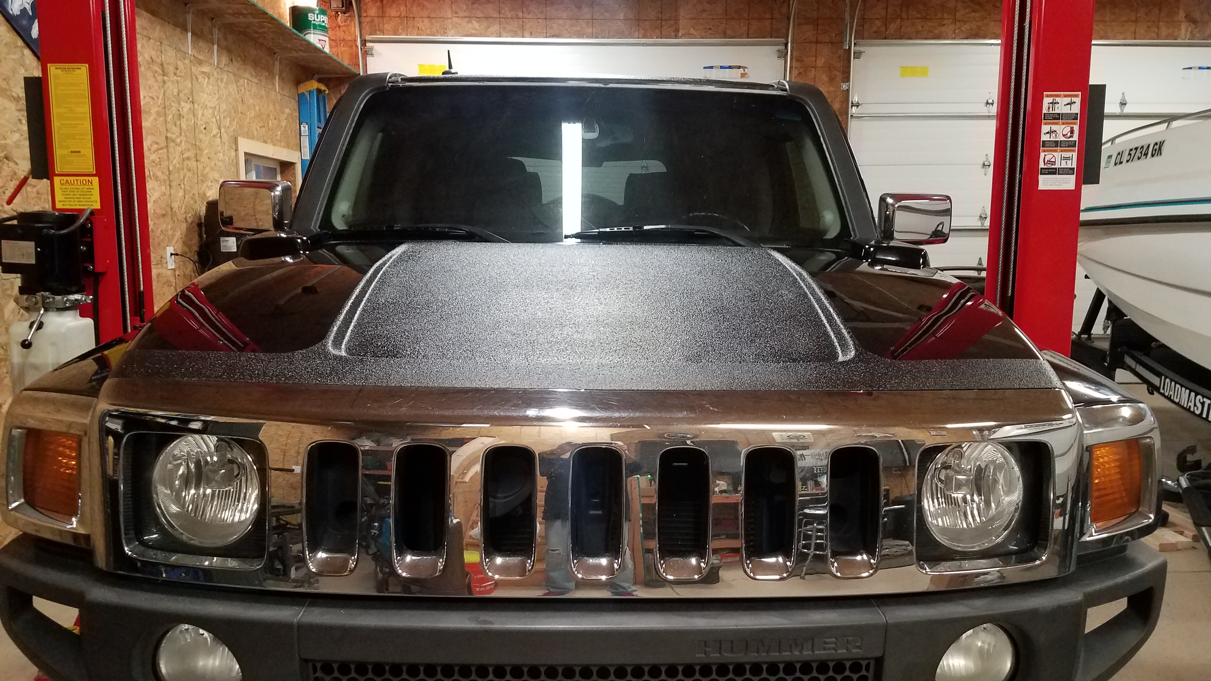

Hood faux vents deleted. Braised with silicon bronze, smoothed primed, 4 coats of raptor liner with three coats of satin clear. The holes from the overhead marker lights got the same treatment, that required new edge and top trim around the windhshield:

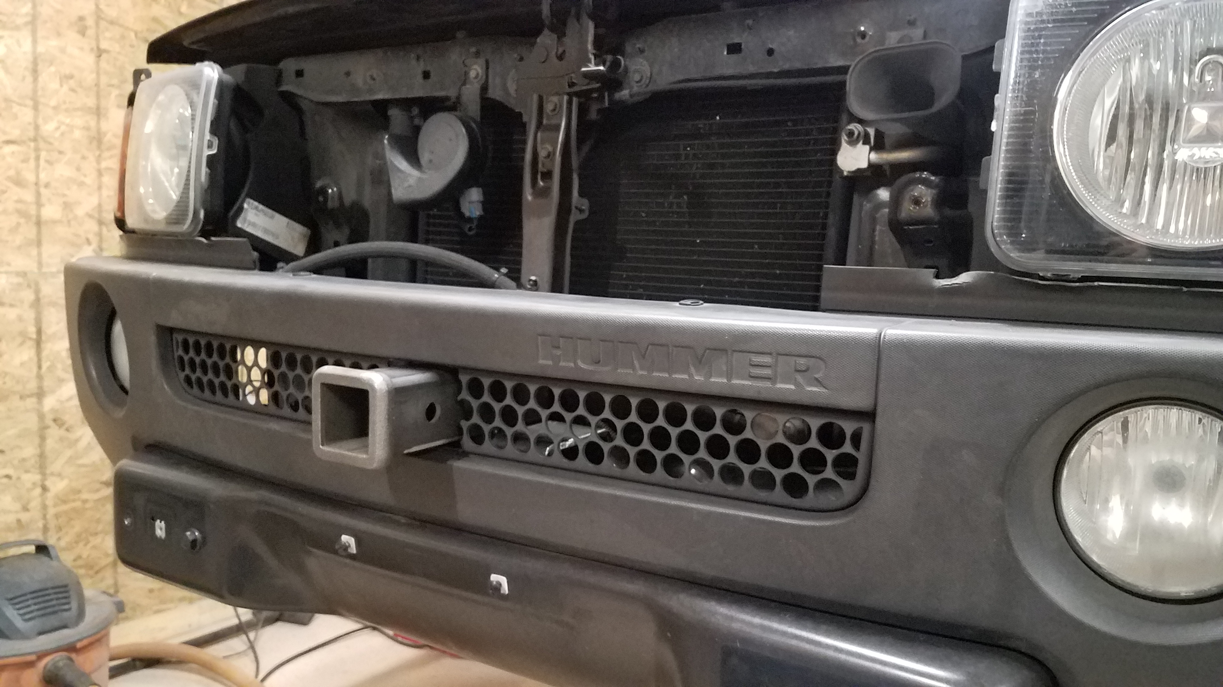

New winch point:
New winch point:
