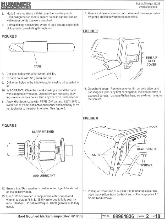

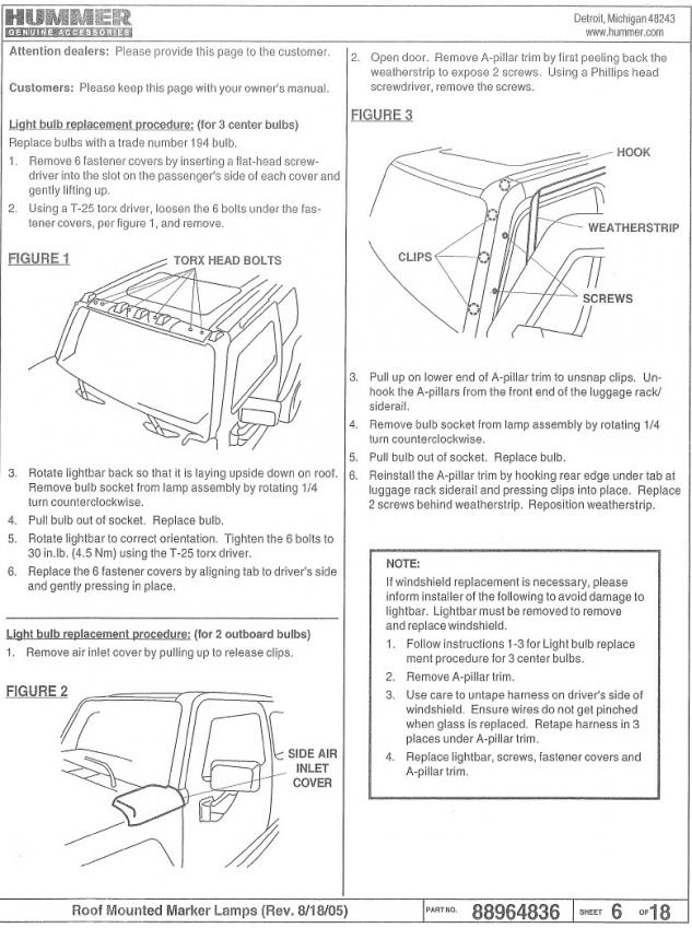

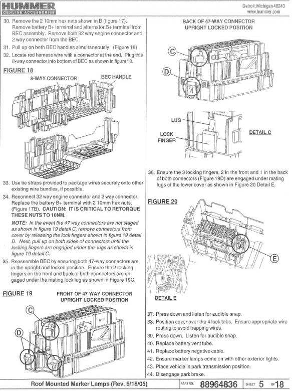

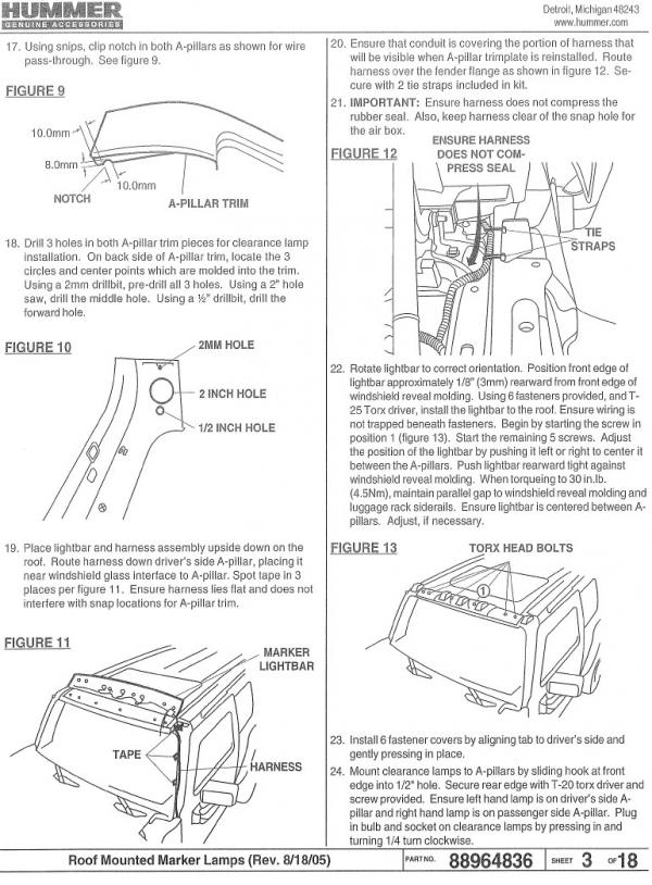

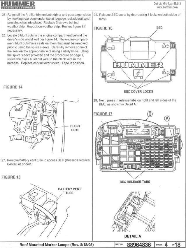

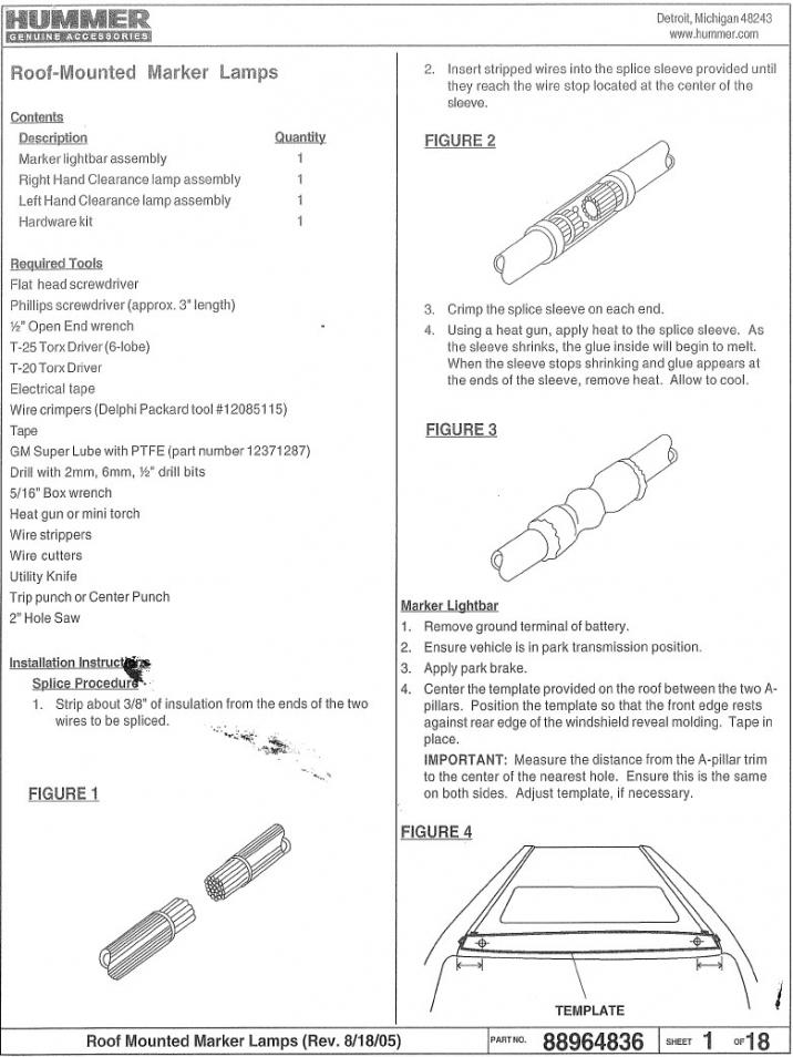

H3 Roof Marker Installation OEM Manual, [need it? come in]
davidh3
334
N/A
I finally found Roof Marker Installation Guide PDF in my Mac.
