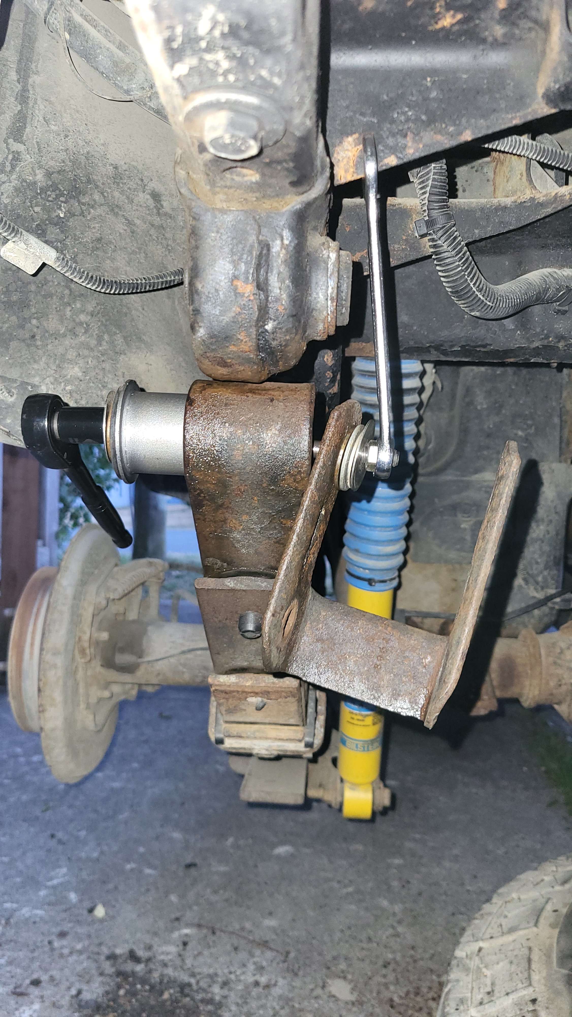

I changed the drivers side spring-to-shackle bushing and my squeek cleared up immediately BUT I used the old pins and that may have been a mistake? They were worn and went in loose enough that I could rattle them.
I greased all the rear shackle bolts, both sides. Did not overnights them. Now over small bumps I hear them click/rattle. This is my first go-around with this kinda thing, but I couldn't find anyone around, or on the web, that would confirm that the bolts were too loose and should be replaced. I'll also add that I'm having a hard time finding them in town.
Any thoughts much appreciated.
