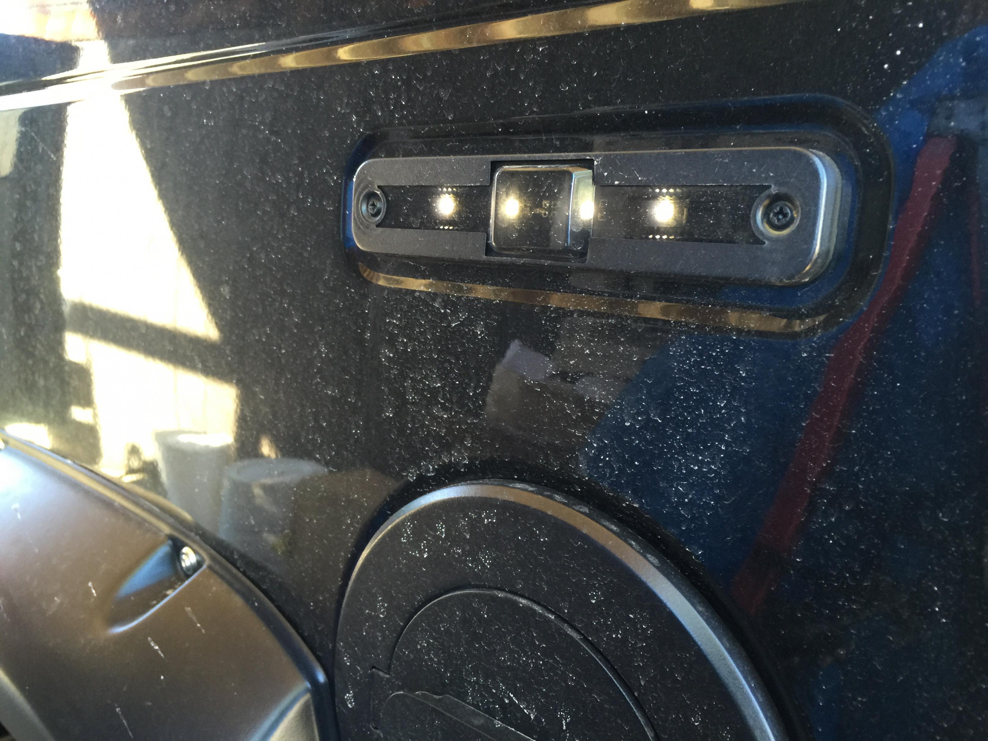

My front drivers side marker light has offically died... Where do I get a new one? The only one I found was like $123! If its going to cost that much it'll just have to stay out.

You do mean the one in the front fender, right? That has replaceable bulb so it should cost you $3 to fix.
Access is through fender liner or *very* careful removal of the lens cover by prying it out from the fender. Be careful to not scratch paint or break the cover if you pry it

yup exactly remove wheel well liner and the bulb is right there, if I remember correctly it's a 194 bulb. You can try popping it out from the front but there is a very good chance you will break one of the 2 clips that hold the lens in. I recommend removing the liner it's alot more work/time but you won't break anything

I have all the markers off my truck at the shop...I should be out there tomorrow. I'll look and see if there is any way to put in a new led.... way I figure it, if its not a servicable part- its junk anyway....might as well crack it open.

Mine just went out as well. Does anyone have the following document "Door Sill Plate Replacement - Rear" for properly removing the cargo trim panel in order to replace the market light?
