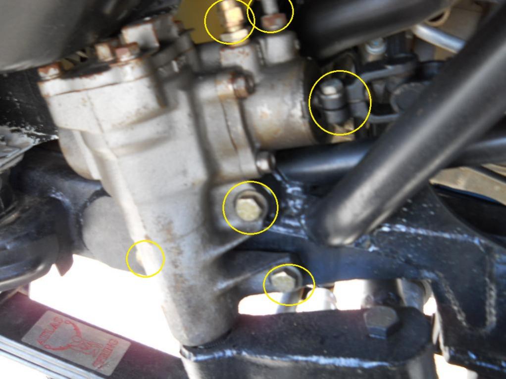

Hey guys, I finally bought another steering box to replace the messed up one. I should be getting it in about 2 days or so and had a few questions prior to installing it. Forgive me if these seem like dumb questions but I've never done this before and I don't claim to be a top mechanic haha
So, as we know my truck is unique and built quite weird in using a steering box from a 86-88 toyota 4runner. As far as I know it shouldn't be a difficult job.
-Unscrew the two hoses from the top of the box
-unbolt it from the frame
-unbolt the steering shaft from the box
-Install new box and reconnect the hoses and steering shaft and replace fluids?
Again, I've never done this and have no idea if the above steps are correct, so if anyone has any advice or steps I'd really appreciate any help I can get. If we need some pictures I can definitely get some taken and posted up asap.

Thats how i did a friends sas 4 runner. Leave the brake fluid cap off and cycle the steering back and forth with fluid to get the air bubbles out. Should be good after that. Since its out you can drill and tap the box then plug the holes for ram assist later on. Pretty easy job.

Swapping your box is pretty simple. In addition to the yellow circled stuff...you'll have to swap that gigantic pitman arm onto your new box. Normally you would need a pitman arm puller, and perhaps an impact gun....but due to the size of that thing...all bets are off. You might just have to wail on it with a BFH.

From what it looks like, are the circled parts all I need to unbolt?
You have everything circled that needs to come off.
If you don't have some tubing wrenches you should get some.They are recommended for the power steering lines.
Tie the steering wheel so that it can not spin freely
Remove the drag link from your pitman arm
Remove the steering shaft from the steering box
Loosen the power steering lines before unbolting the box from the frame.
Unbolt box from frame
Remove power steering lines form box
Remove box from vehicle
Remove pitman arm from the steering shaft with a pitman arm puller.Most auto parts stores have loaners
Install in reverse order
Once everything is installed and tight.Jack up the front tires so that they are off the ground
Remove power steering cap "Not your Brake fluid cap'
Fill reservoir With the"'Clear Power Steering Fluid" not red
Do not start the truck yet
Untie the steering wheel
Cycle your steering slowly from lock to lock several times checking fluid level and adding if necessary - several times
You can now start your truck.
Cycle steering from lock to lock several more times.
Check fluid level
Clean up and have a beer:cheers:
