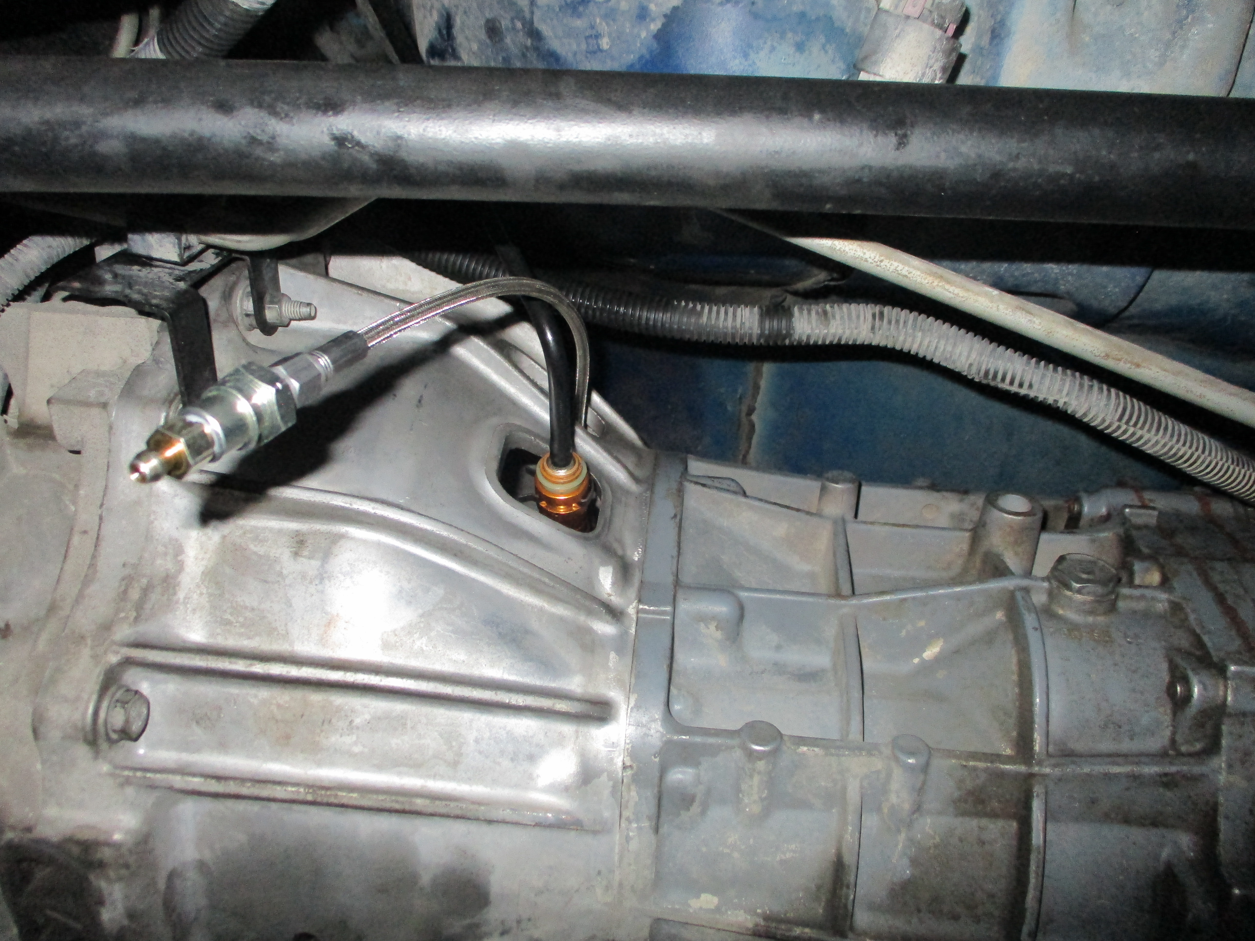

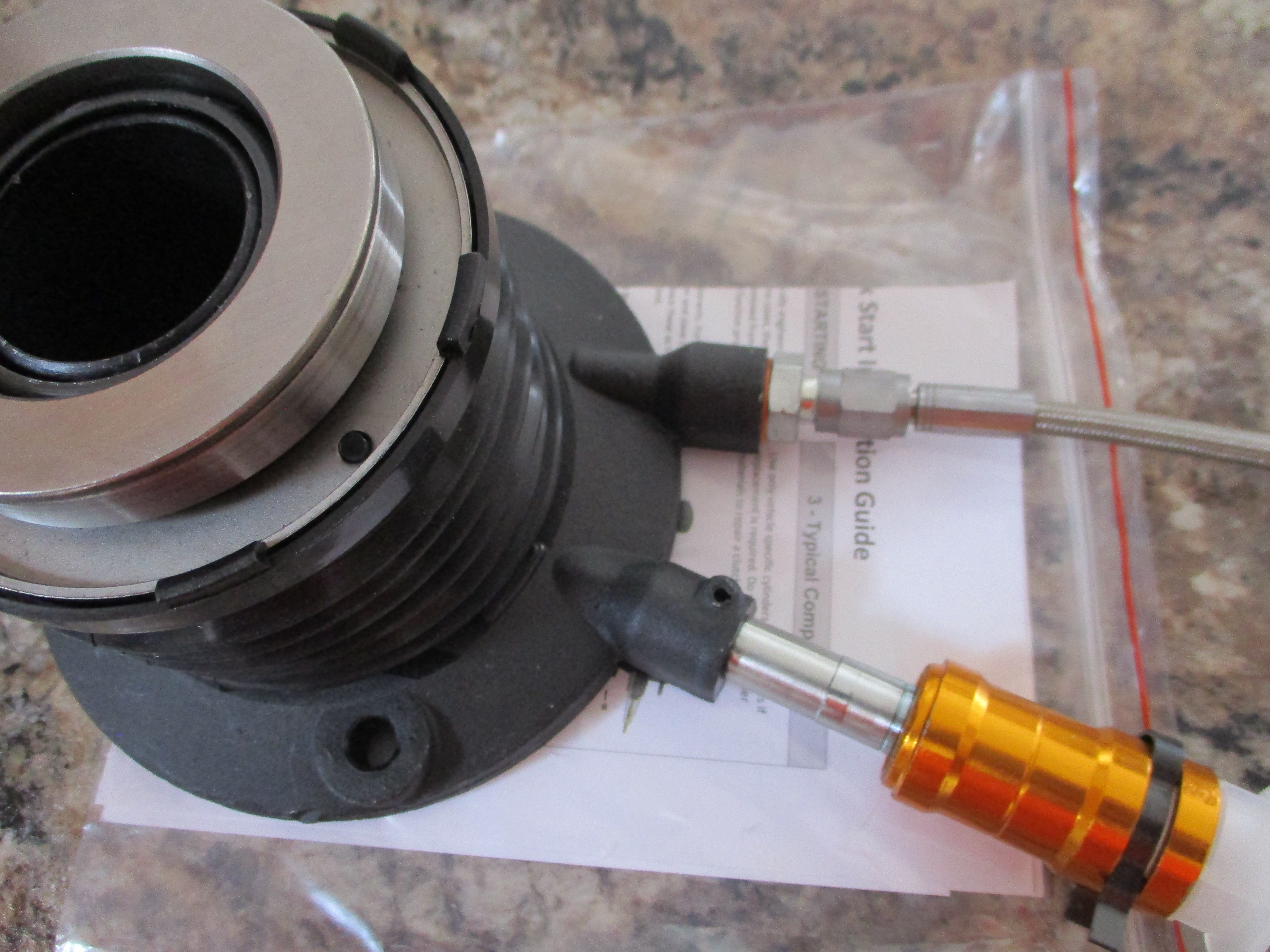

while i was in there, i decided to build a remote speed bleeder line. it payed dividends on the vette, so i figured it'd be worth trying on the hummer so i could bleed it myself quicker. go figure - nobody in the entirety of the interweb has ever mentioned doing this on (or offering a kit for) the GM midsize trucks... so i found a place that sold all the pieces i needed & built my own. it tucks up out of the way using an existing fuel line bracket.
only oddity so far is that the SPEC instructions never mentioned a need to shim the slave... but it's currently engaging/disengaging at the bottom 1/2" of pedal travel (like a clutch at the end of its life would). i know this design is 'self-adjusting', and i bled the crap out of it last night (~a pint of fluid through), so we'll see how it feels by the end of the 500mi break-in. i REALLY don't want to take all this back apart to space that slave out!
