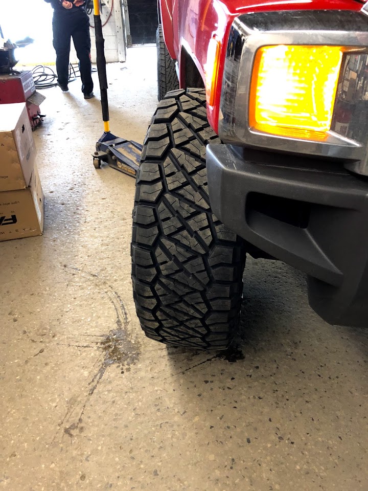

35 x 12.50 R18...
This is a stock H3T Alpha that came with 285 75 R16. The t-bars have never been touched and I measure 21" from the H in the original hub up the fender. Should I bother trying to crank them up? I can live without the mud flaps.

Might have to crank the T bars. I would have stayed with 16”personally but each his own. I run 35s with the factory rims with no issues except the inability to turn full lock. I wonder if after removing the mud flap if you’ll still rub when the suspension compresses?
Not really sure, but those wheels look like they have the wrong offset. Cranking the torsion bars will probably help, but to my untrained eye the wheels are out too far which is going to increase the swing of the outer edge of the tire and cause clearance issues.

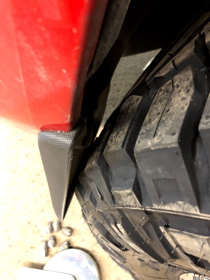

Also the mud flaps are probably eating some of the clearance you normally have.

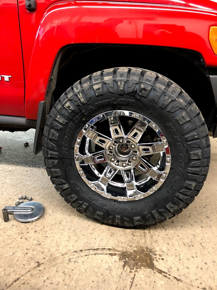

They're only +15 and factory rims were +38. So it was coming into contact with the calipers without the spacers, which are 1.5" (38mm.) They are 'far out'...by the +15, and then by those tires are wider by another +16 on each side (than stock 285s), if I understand the math. Seems like more than +31 sticking out there though. Math is hard.

I am running +10 offset with 35s. That pushes the wheel 28mm out. In your case +15mm has the wheel out 23mm. I had to remove my mud flap as it robbed me of 0.5" clearance.

Wide tires + spacers = way too much offset, lots of rub. Crank the torsion bars and lose the mudflaps before they get ripped off. I don't see how the wheels would be coming into contact with the calipers 18" wheels have plenty of space between wheel and caliper.

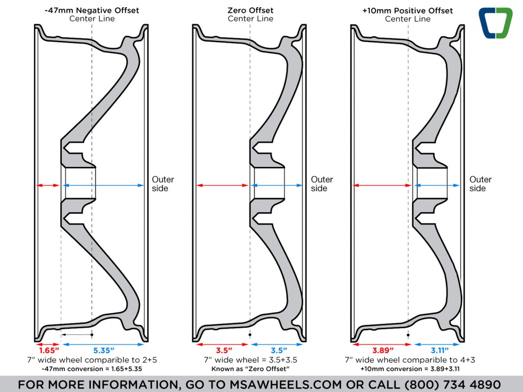

So if the wheels you have are a +15 offset, and you added a 38mm spacer, you turned them into a -23 offset which is why they are sticking out so much. Offset is measured like this:
The more positive offset a wheel has, the farther into the wheel the axle hub is. The more negative the offset, the less the axle hub sticks into the wheel. You gave yourself negative offset so the axle hub isn't in as far as it should be for proper fitment and suspension/steering geometry. If your wheels were already +15, then that is 23mm too little offset from where they should be, depending on the width . If these 18" wheels with only a +15 offset were hitting the rotors, even if the rim is a 12" or so wide rim, they should easily clear the calipers. The factory aluminum wheels are 16" x 7.5" and clear the calipers just fine. Looking more closely at your pictures, I have a feeling the wheels are hitting the face of the calipers with the spokes, rather than the inner circumference of the wheel as one usually sees. This would explain needing a spacer to move the wheels out far enough so that the spokes aren't hitting the calipers.
Truthfully, you need to return those wheels and get some that fit correctly. There is no valid reason 18" wheels should not fit correctly aside from the issues of improper offset and insufficient clearance between the spokes and the calipers. If you bought those from a wheel shop (either online or locally) then they did you a huge disservice by selling you wheels that did not properly fit for the application.

To quote the mechanic, after cranking it up even further during my second trip there today: "I've giv'n her all she's got captain, an' I canna give her no more."
Such a tight fit with the swing from this bolt-on spacer. We may try something different later but these rims require something to clear the calipers. May have to trim/remove the flaps in the interim. But...I think we're going to run with this setup rather than dropping back down to 305's

1.5" plus your current wheels are alot. If you really dont want to change the wheels or remove the spacers (or go with thinner spacers) then your options are limited to removing the mud flap, cutting the body or doing a body lift.
