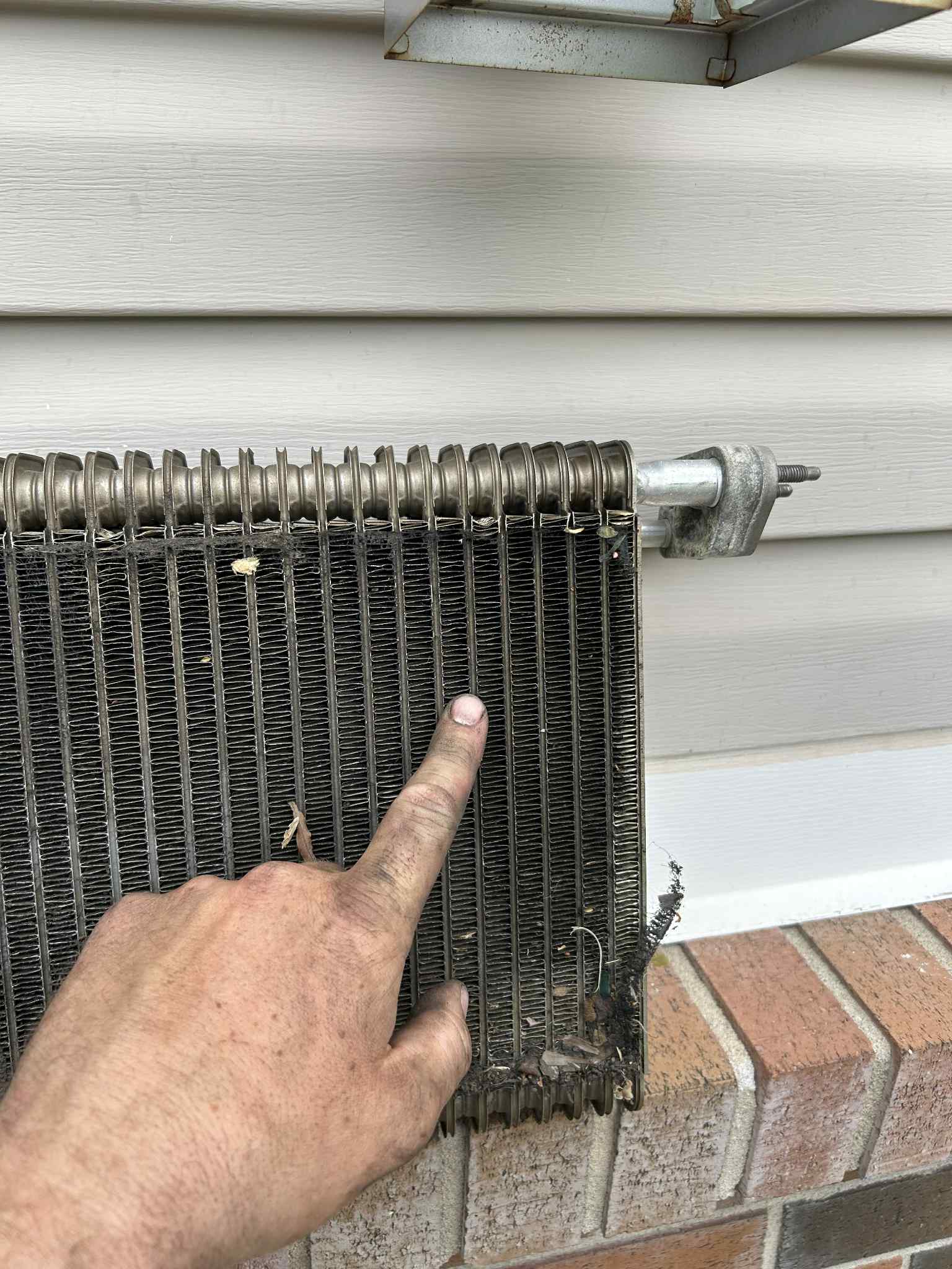

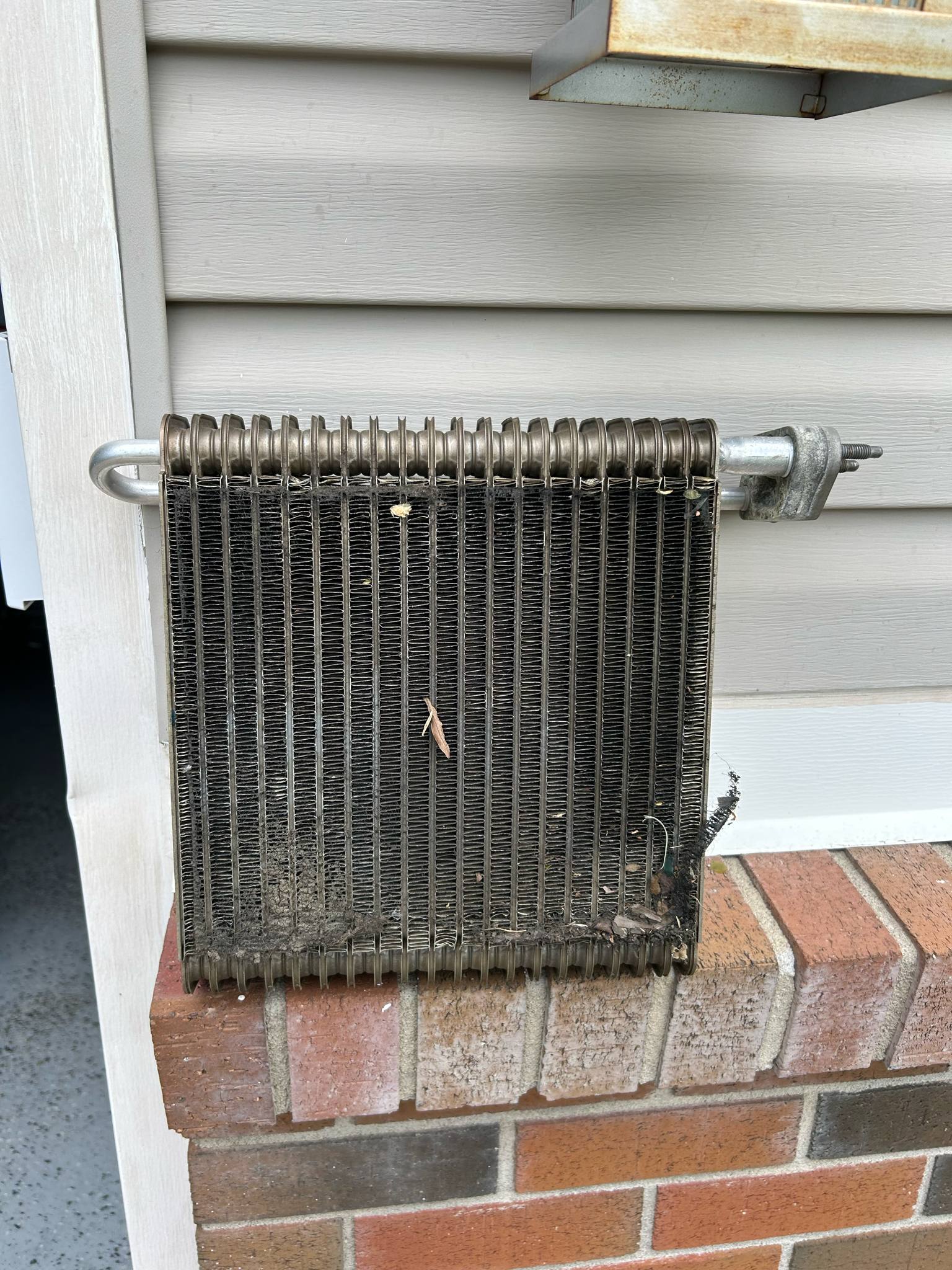

Current Mileage: 325,800
Currently prepping for a cross country move. Repaired the A/C this weekend after discovering a massive evaporator core leak while diagnosing the system faults. Also addressed a few other A/C system issues and some needed maintenance. This weekend I replaced:
-Jounce bumpers
-Blower motor
-Blower motor resistor chip
-A/C Airflow Direction Actuator
-Heater core
-Evaporator core
-Condenser
-Missing dashboard mounting bolts
-Washer fluid tank (plus both sprayer motors and level sensor)
-Washer fluid line
-Missing radiator fan shroud retainer clip
-Repaired misc. dashboard wire harness insulation
-Interlock shift solenoid
-Serpentine belt
-Serpentine belt tensioner pulley
-Serpentine belt idler pulley
-A/C belt
-A/C belt tensioner pulley
-Air dryer
-Air dryer seal kit
-A/C pressure switch
-A/C compressor
-A/C seal kit
-Orifice tube
-Low pressure schrader valve
-High pressure valve
-Climate Control Module

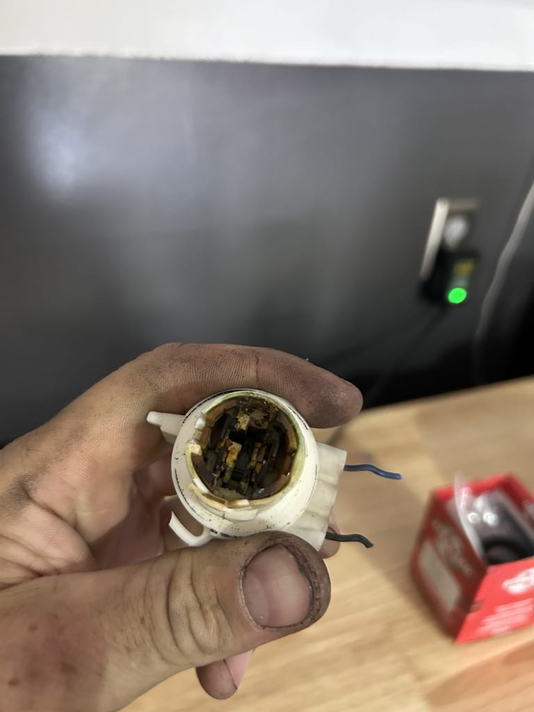

-Daytime running light pigtails

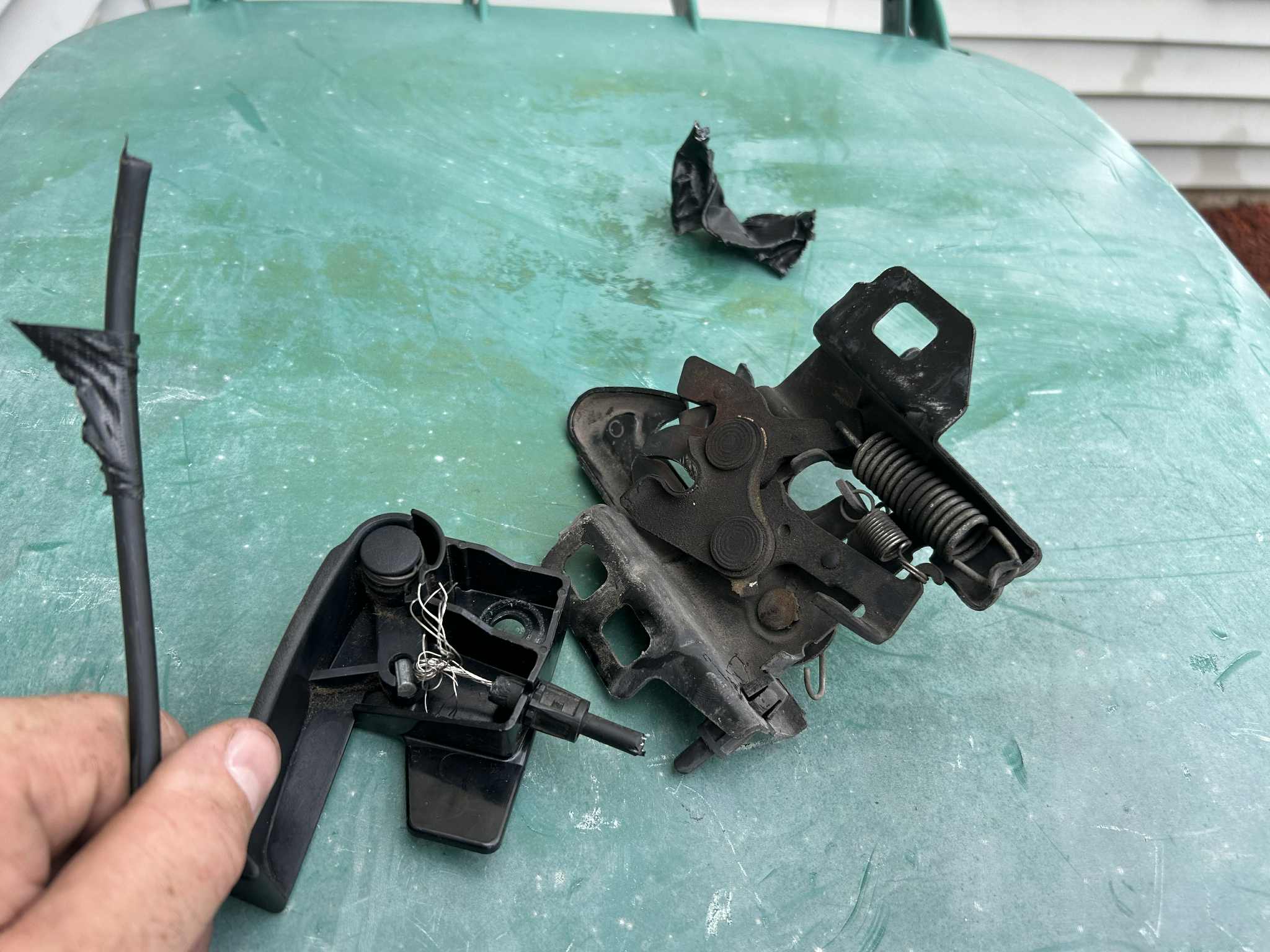

Current Mileage: 328,183
-On it's trip from Kansas to Georgia the Tahoe decided it would be a convenient time for it's hood release cable to break as well as a (worn out from old age?) liftgate glass mount. Both were replaced this weekend.
-Hood Latch Release Cable (GM#15142953)
-Hood Latch (GM#15756432)

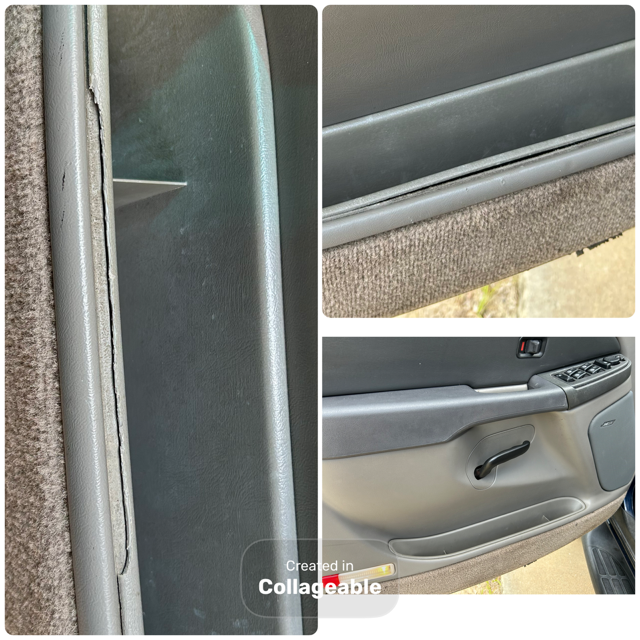

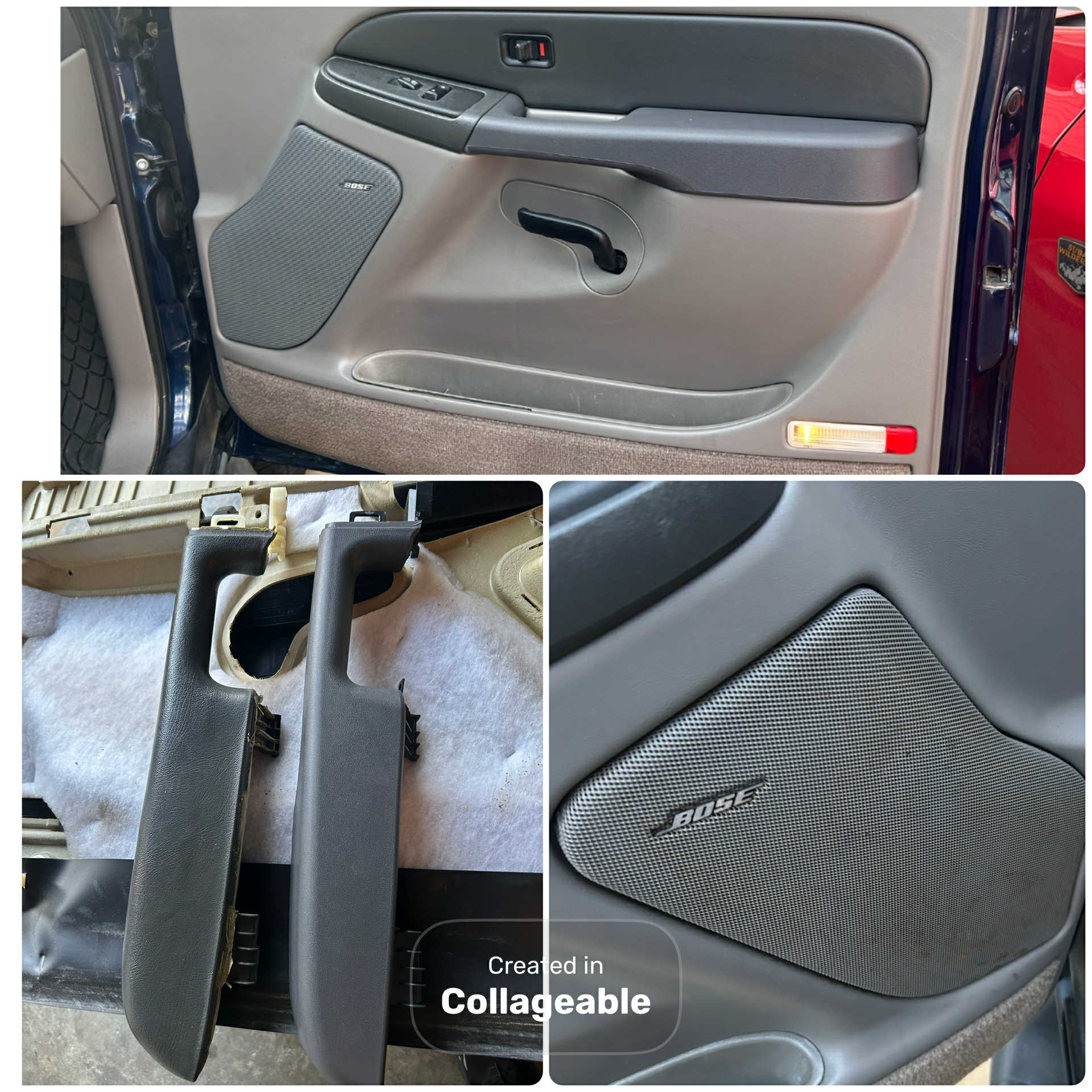

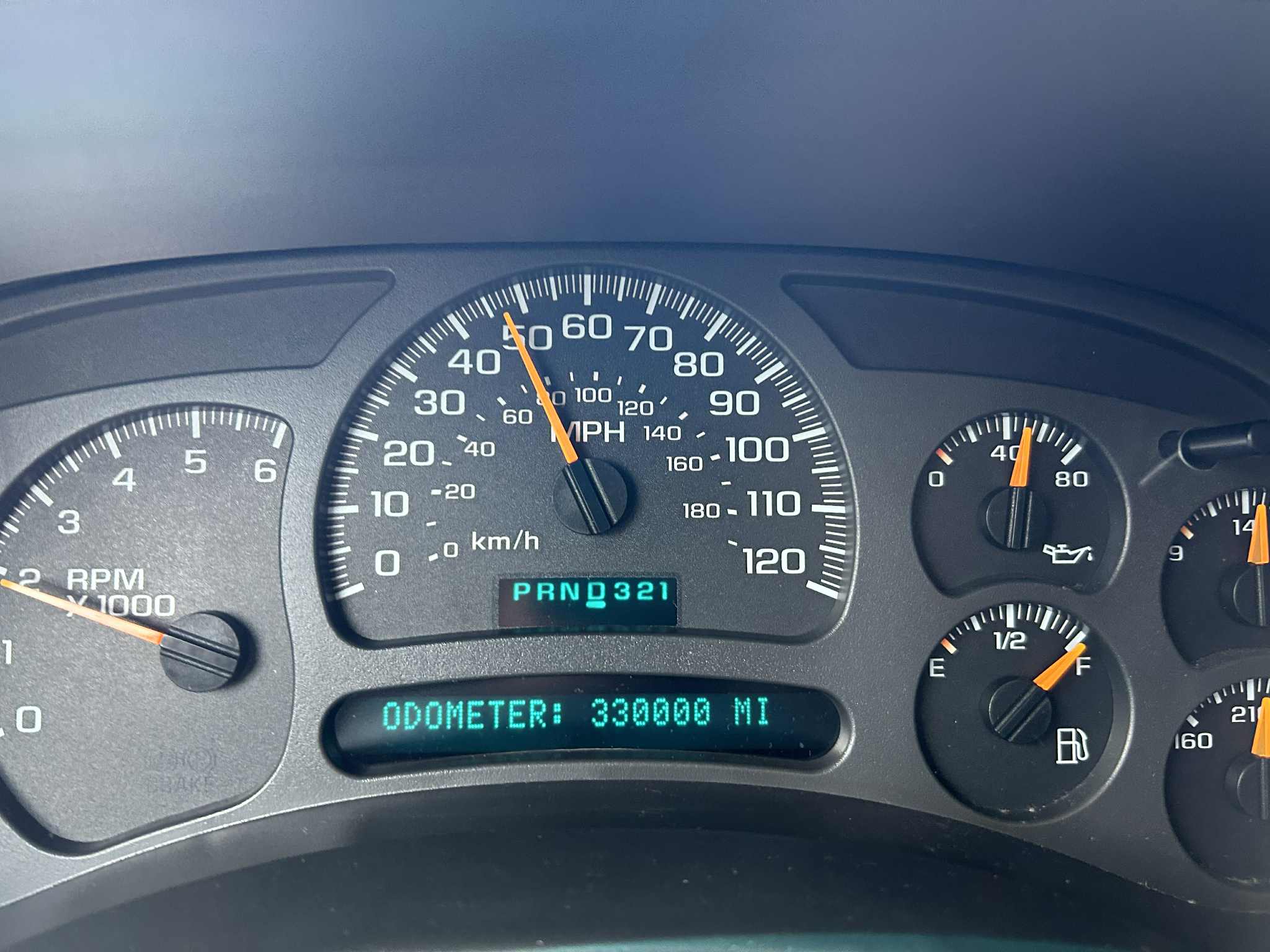

Current Mileage: 330,000
Replaced the following:
-Both front door speakers (GM#15236987-BOSE-) [driver door was dead, passenger sound quality wasn't great]. You can see the old speaker on the bottom has a little spot where it got too hot.
-Repaired left rear door panel armrest mounting bracket [broken]
-Restored all four door panel speaker grilles [rusted/stained]
-Replaced both front door arm rests (GM#15703701-L-/15703702-R-) [hard as a rock/mushroomed out]. The arm rest on the left is the original.
-Replaced all four door courtesy lamp bezels (GM#15021517-L-/15021518-R-) [bezels were in misc. state of crusty sadness]
When I find a suitable donor I'll go back in and replace the front door panel pockets. The door panel carpet strips will be replaced at the same time as the carpet, hopefully before fall.

Replaced:
-driver seat power switch [incorrect color] bezel (GM#88941672)
-front door panel pockets [damaged] (GM#45971-L- / GM#5970-R-)
-driver seat lower cushion [clapped out] (GM#12473404)
-driver seat lower cushion support [worn] (GM#12476891) and spring [broken] (GM#NLA)
-driver seat lower cushion cover [torn] (GM#88936884)
Installed Missing:
-cargo bay storage lid (GM#NLA)
-cargo bay storage lid bumpers (x2) (GM#NLA)
-cargo bay storage box insulator mat (GM#NLA)
-sun visor retainer mounts (L/R) (GM#NLA)
-rear seat mounting bracket covers (GM#310945006-L-/GM#328810006-R-)
-battery brace (GM#15159505)
