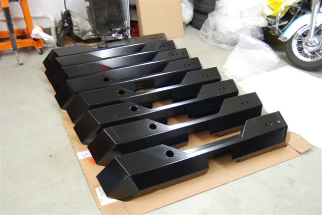

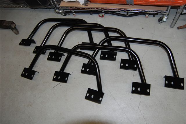

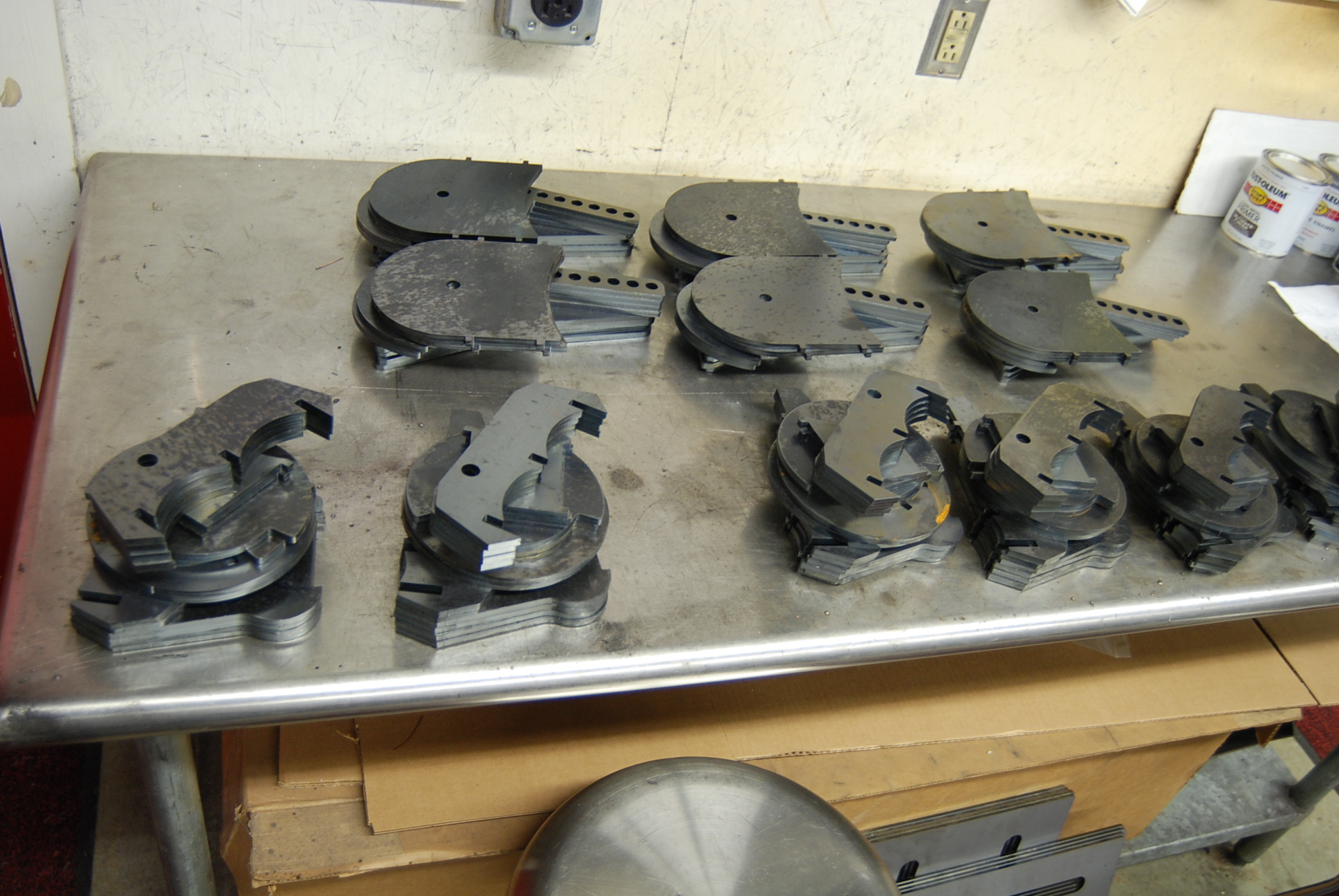

Just in time for tax-refund season! THORparts has just geared up for summer, and we have all of your favorite parts in-stock and ready to ship.
  • Front Winch Bumpers
  • SUV Rear Bumpers
  • T Rear Bumpers (supplies are very limited)
  • Skid Plates
  • UCP Beef-up Plates
  • Bull Bars
  • ABS-ready Dana 44 hubs
  • H3 to Dana 44 caliper mounts
  • SAS bracket kits
  • SAS links, custom housings, etc.
DSC_0132.JPG01-25batch-1.JPGbumpers 002.JPGskid-2.jpgbrackets 016.jpgbullbatch2.JPGTHORhubs1.JPGbrackets 014.JPGmock-up 001.JPG

06H3...Yes, for 2.75" tubes? Sitting here on a shelf with your name on em.
The Solid Axle stuff has been in my hip pocket for some time now. The parts I came up with are not top secret...and several people already have some or all of these parts, and are currently embarking on their own SA-journeys. Its difficult to put together a single "kit" to please everyone. I currently know of ten solid-axle H3's, and every one of them is different! So I plan to break the parts out into smaller sub-kits that address each particular part of the swap. That will give the builder the option to go off in more hard-core directions if he wants. Someday H3's will be cheap enough to be worthy of building a trail-bomber but, right now I need mine to be fully functional and all-purpose and that's why I chose the parts I did. My main focus has been on the Dana 44, 3-link, coil-spring rig and that's what all my SAS parts are designed to fit. Its "mild" by off-road standards but I feel its the best compromise between: budget, parts availability, ride-quality, and performance.
