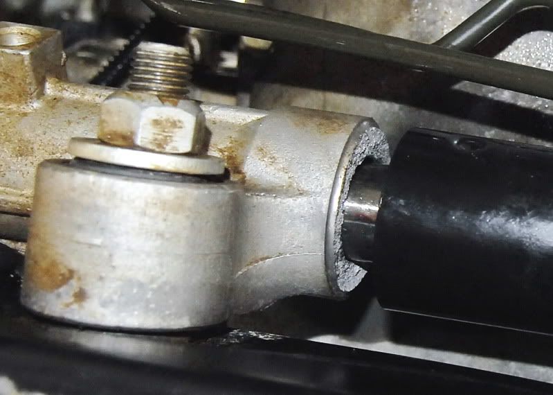

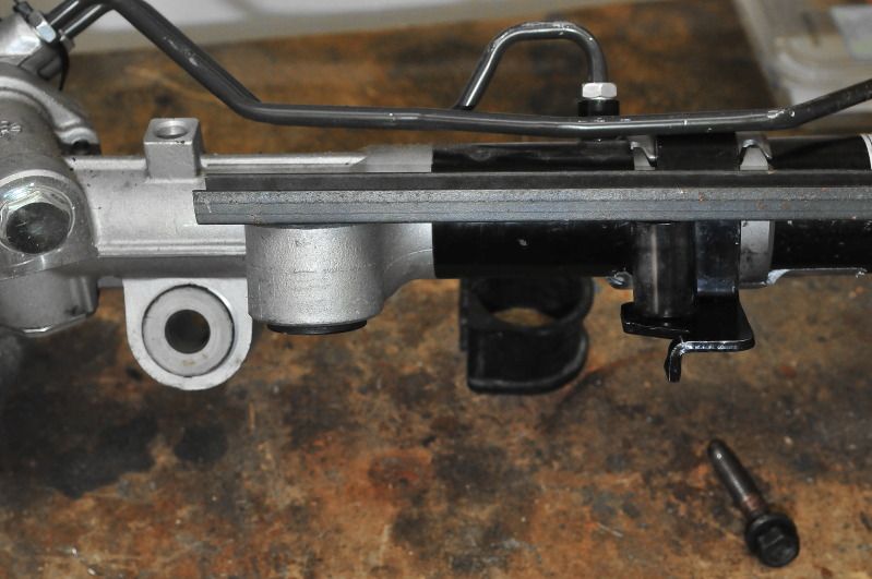

Has anyone done a post-mortem on failing steering racks to determine the failing part of the rack? Is it general wear-and-tear and are the racks repairable? I'm wondering if the racks could be repaired with better parts to improve the weak areas.
backcountryislife
858
Dumont, CO
It's the body of the rack that snaps, IMO it's not something you could "fix" you just need to set it up so it,s not stressed so that it will fail.
Sent from my A200 using Tapatalk 2
Autopsy
Maybe add a brace across there so when it does break you can steer off the trail to repair.
There are a couple of looong threads on those questions.
