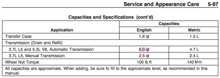

Hey guys; getting ready to drop my tranny pan and replace filter and fluid (way overdue, but...). Couple of questions: How much trans fluid should I buy? Any recommendations on gasket brand? Fluid brand?

I think any Dex 6 will do. I want to say pan drop and filter change you need 5ish quarts.

right out of the book

Mine took a little over 4.5 quarts, though I gonna check it a few times after driving to make sure I'm up to level. Old fluid actually looked pretty darn good; still mostly red, and the old gasket came off pretty easy. That surprised me, since the truck has 170,000 miles on it. After seeing the fluid, I'm thinking that it was likely changed out prior to me buying it (at 98,000 mi).
