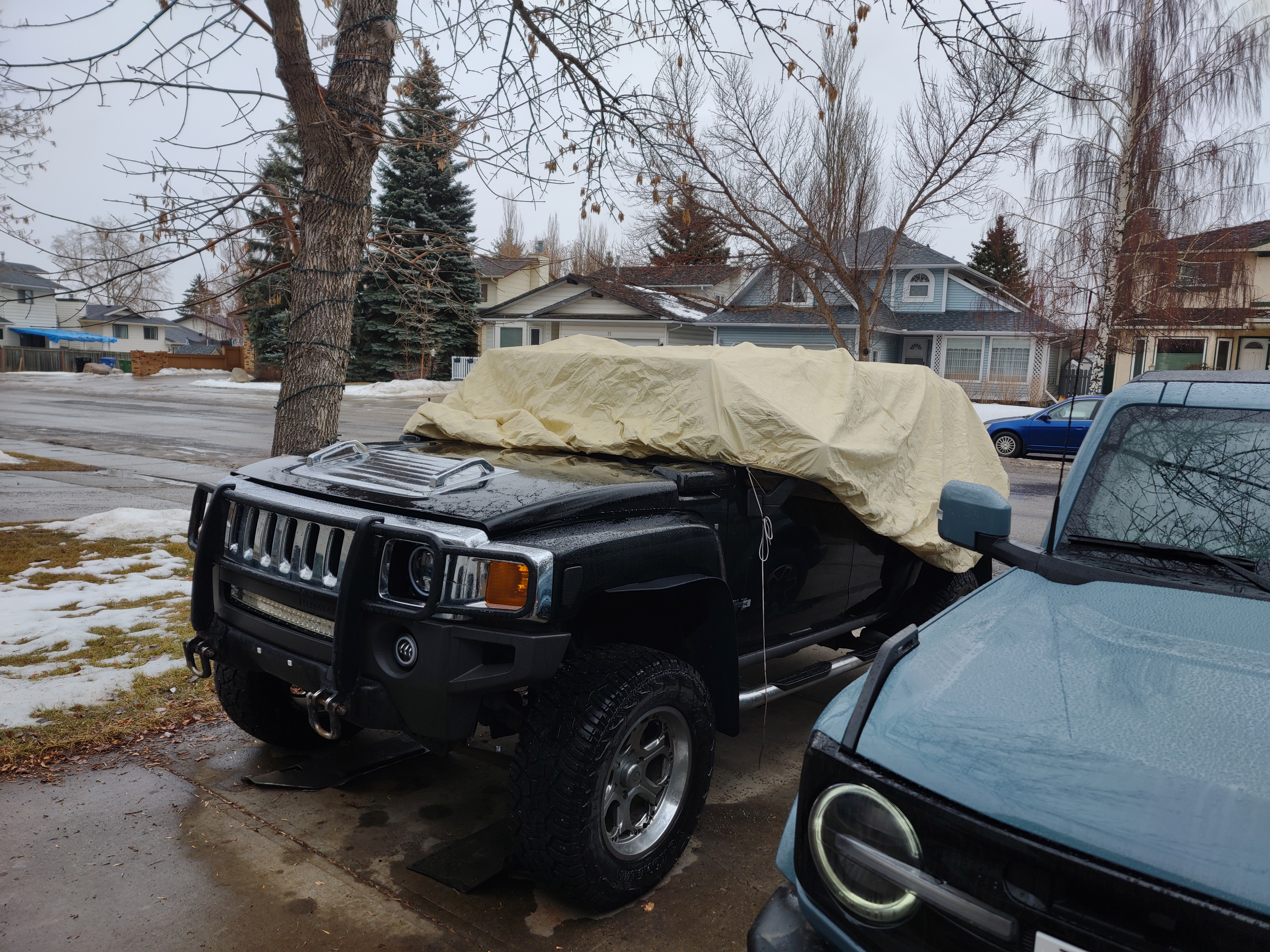

The sunroof drain tubes are completely full of years old dirt, didn't have time to completely fix before rain started.. so she gets a hat !
Poor girl's been neglected for a long time , the tubes are full right to the roof

That's normal. Even after a year you could have 1-3" of 'dirt' in it. It's not dirt, it's accumulated dust the builds up at your sunroof.
The best way to approach it IMO is to remove the sunroof completely (4-bolts), and give it some thorough maintenance it's probably never had. Completely clean the gasket with a brush and warm soapy water. Clean the entire surround area on the roof. Make sure there aren't any rock chips where water can seep through around the gasket. Then, put the sunroof back in and adjust it so it's slightly above the roof by a very small amount and water doesn't 'pool' up at the corners.
Then probably the best mod might be to run new tubes straight down inside the kick panels though the floor below ..and tie in up above somewhere. Best of luck.

that's actually a really good idea, thank you! I may as well, especially if it's never been done. one question though.. does the engine have to be running for the sunroof to open? i clicked the key to ON and the switch doesn't work... or is that more i have to fix LOL
i do like the idea of just running new lines though and even removing the sunroof altogether

IDK if the rears are that important. They don't have the fingers, and most report they don't clog up. And they go out the sides back below the rear seat belt shoulder harness.

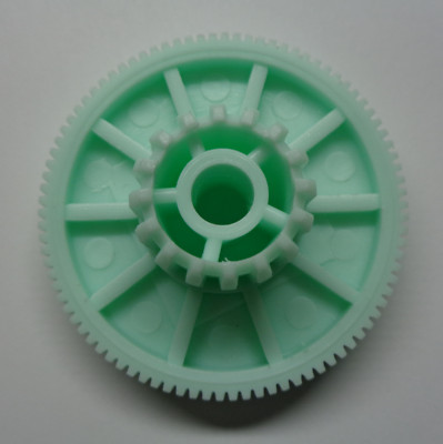

Is yours opening/closing? Mine opens/closes with the key on. One thing on the sunroof's is, there's a plastic gear that sometimes breaks for some owners. The teeth strip off. Easily replaced, and cheap. IDK it that's your truck's problem. You might whack on the switch a few times in case yours has an oxidized switch.
The ultimate reality is, the drain tubes are 'safety drains' not the main water mitigation process. That's the seal. Clean yours off real well and if it seems shrunken, maybe it's time to replace ($150 on ebay). I replaced mine a few yrs ago. But I still get water in if we get a driving rain.
