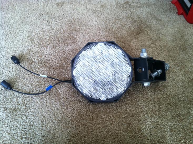

I have the led mount up anywhere type it's just like the hmmwv LEDs but there is just 2 wire and the power wire lights up all the LEDs. I'll take pictures of them latter but bracket, nuts and bolts are all there. Looks like I'll just pass them out to who ever wants to make a deal.

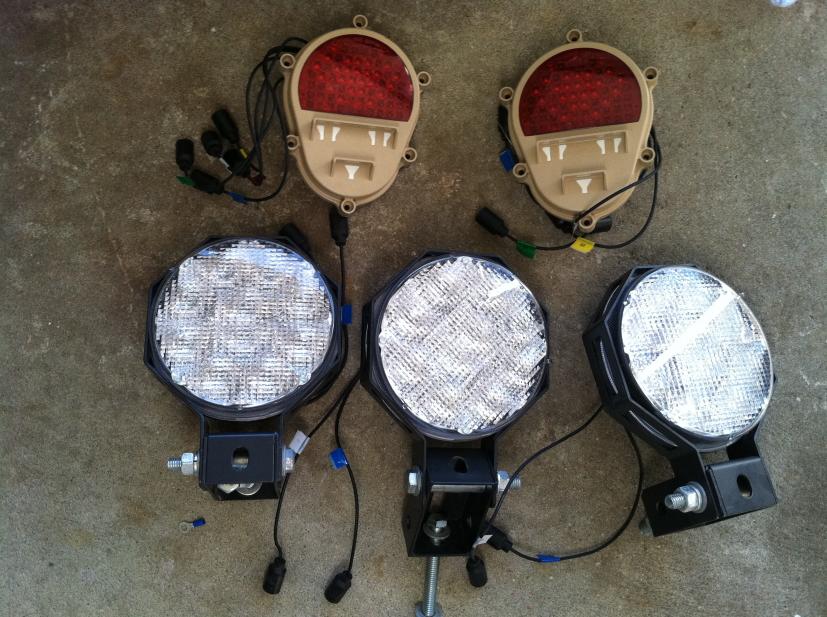

This is what I'm working with.

I'm just going to put all 3 for sell and look for the H3 roof mounted lights. But these damn lights are so bright..... I'll live and I guess I won't be using the rear hmmwv LED brake lights also.

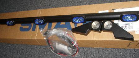

You have any pictures of it?
These are pics off of google. Since I am not home I can not get actual pics right now. I have never installed it yet. From what I understand talking to people that have them. They are brighter than the dual factory lights but not as bright as say 4 6" rounds. You also don't get the glare off the hood like the factory lights
These light bars have 4 PIAA 2100xt bulbs and were only available through the Hummer dealers. There is also a matching rear light bar the pop up on ebay every now and then. There is actually one rear on ebay right now for 350
