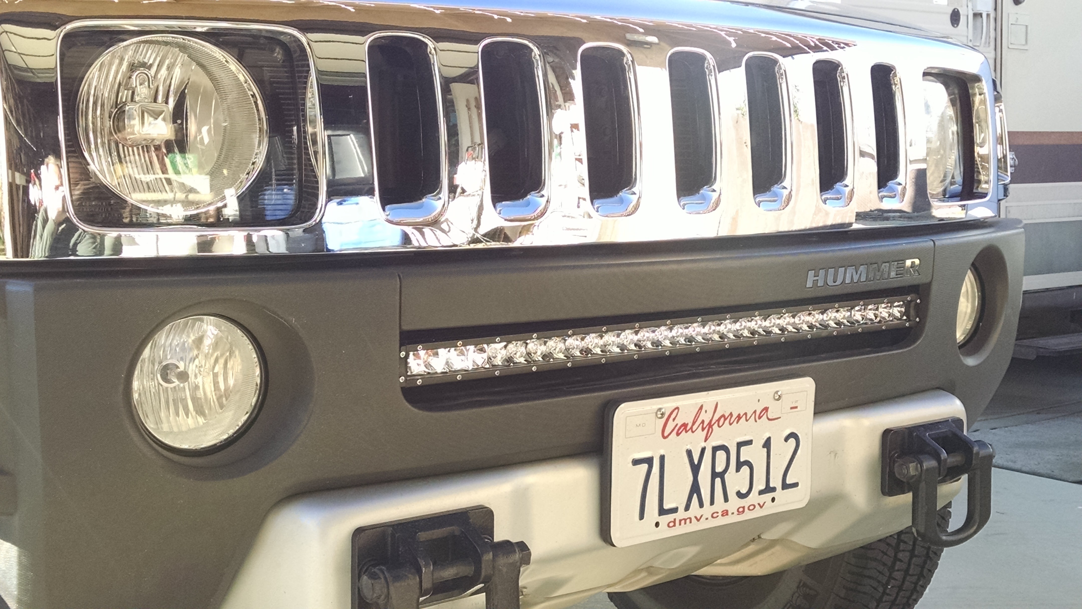

does anyone have a write up on how to mount a 30"curved led light bar in the lower grill? Do i need to take apart the the bumper and lower grill. Thank you in advance
650Hawk
547
I put a 30" straight, single row in mine. Definitely need to remove the front bumper. Don't have a write up, but once the bumper is off, it's pretty straightforward; there are braces that suffice to mount the brackets to with a bit of tweaking. Just depends on the configuration of the brackets. Again, pull the bumper; not too difficult.
