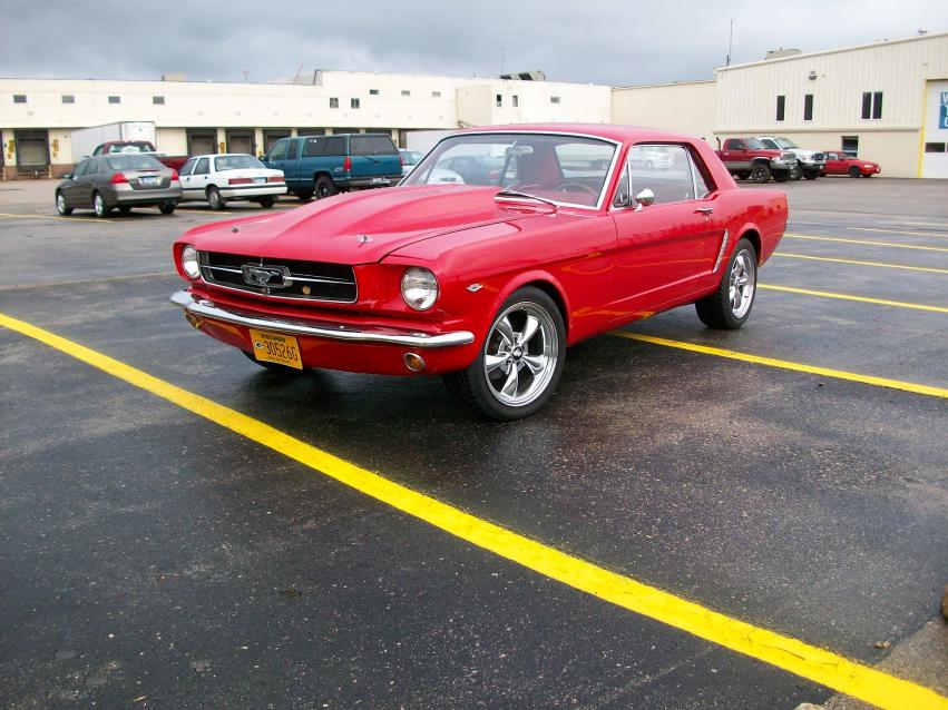

I'm just started focusing on the H2 the last couple of months. I had been busy doing a light restore to a 68 corvette that I just traded off for a 65 mustang. Now between the mustang and the H2, I'm trying to organize the projects.
Here is a pic of the mustang... it will be getting a cosmetic overhaul this winter by changing into a gt350 clone. Currently has a 351w @ 415hp/420tq
