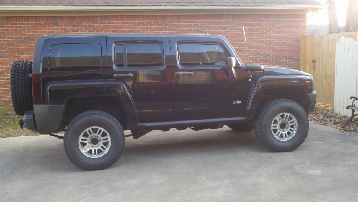

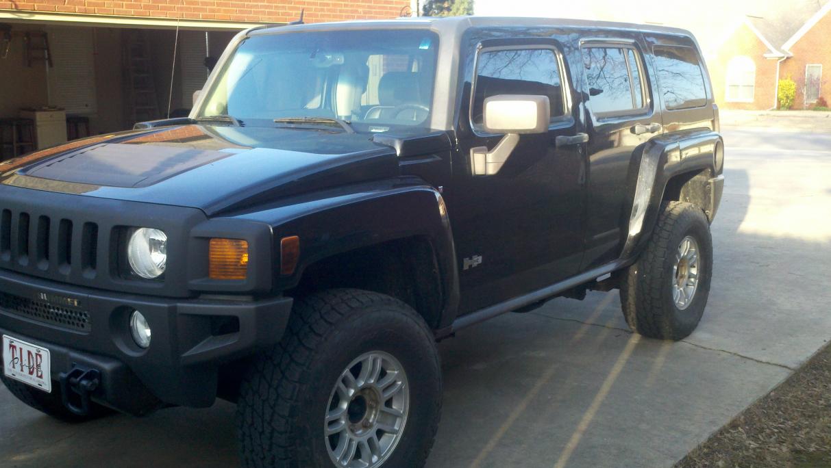

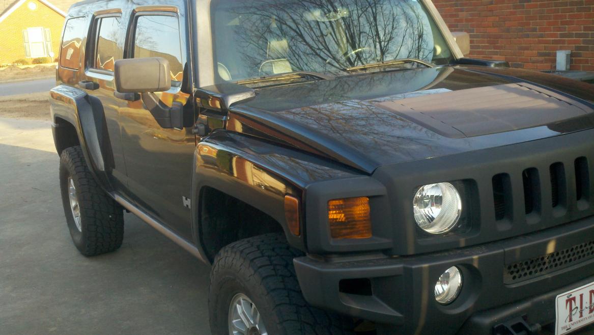

Had two CEL codes lastnight p0171 and p1174. Ask a few questions to get some ideas for this morning to try. When i got up the truck would start but not run, had another code p0300. Cleaned the MAF sensor, TB, changed the spark plugs and cleaned the air filter. All were in very bad shape. Plugs were very bad at only 60k miles gaps from 43 to 53 and anywhere in between. Changed the oil and deblinged her the rest of the way.
2012-03-01_16-49-20_719.jpg2012-03-01_16-49-45_219.jpg2012-03-01_16-50-32_883 (1).jpgby the way all codes are gone for now. Thanks Mike for the HELP!:cheers:
