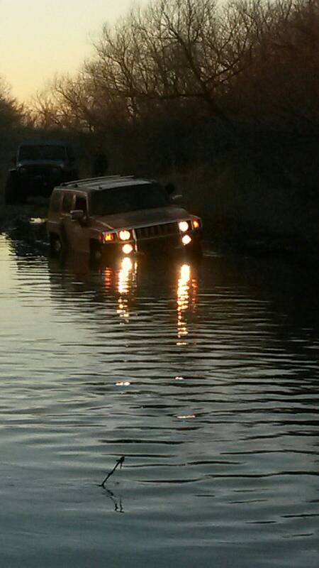

Long story short, I recently encountered a.... "problem" down in the river and my interior got flooded. Was wondering if anyone has removed the carpet and used rhino lining? Is this even possible without making it look ratty and crappy? Just worried about the center console and other plastics hanging over and looking bad. Not worried about road noise, plan on this being a full on trail rig within a year.
