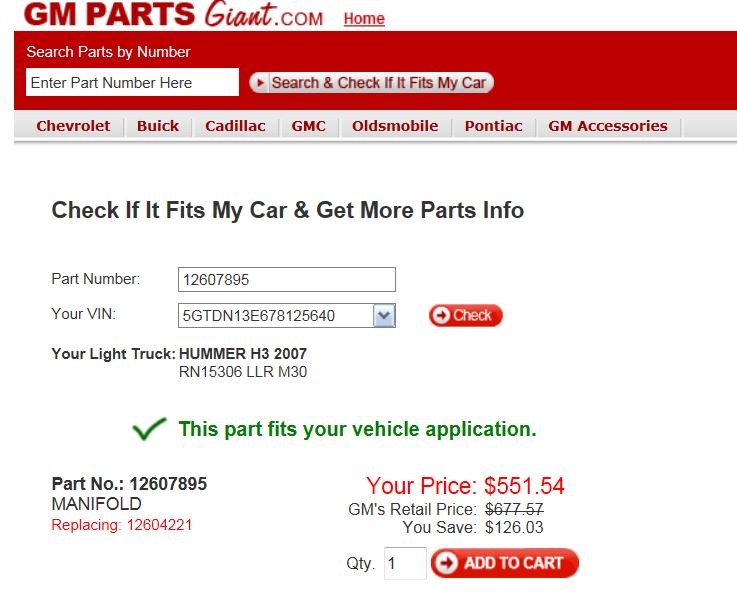

Lookslike the 2008 manifold fits a 2007. Probably a design improvement.
12607985 replaces 12604221

2008/2007 are the same basic engine and head. And GM part numbers can change at anytime for the same part. They might have a minor change you will never notice and give it a new part number. I have seen GM change part numbers when they switch suppliers just for tracking purposes. That is why, the best place for accurate part numbers is via the dealer who has electronic access to look up the latest part numbers via the GM electronic service system, which can be updated daily.
Some outside merchandiser can pay for access to GM's electronic parts catalog (or at least they used too) so they can have the latest data. Just no idea on who has it, while all dealers do have it (part of their franchise fees I believe).
