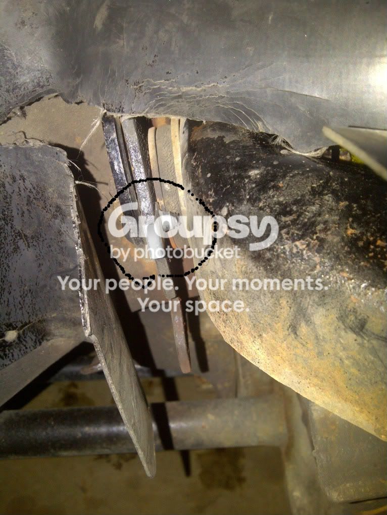

Alright guys, the name of it as per the GM dealer is the eccentric pin. I picked it up today and it seems to be doing alot better, hope it stays that way.
Here is a few pics I took with my blackberry
The left side that is still factory:
And here is the one they fixed today:
They tore up the rubber flap a little working on it but I did not say anything, I'm just happy if the problem is fixed......

Did the pin shear off? Ive never seen one broken off before.
Yes it was totally gone, the GM dealer said he had never seen one broke other than being in a front end collision. The guy at the alignment shop said he see's it every now and then, I know it was popping LOUD without that little pin being there, not sure what it does but it made a difference....
