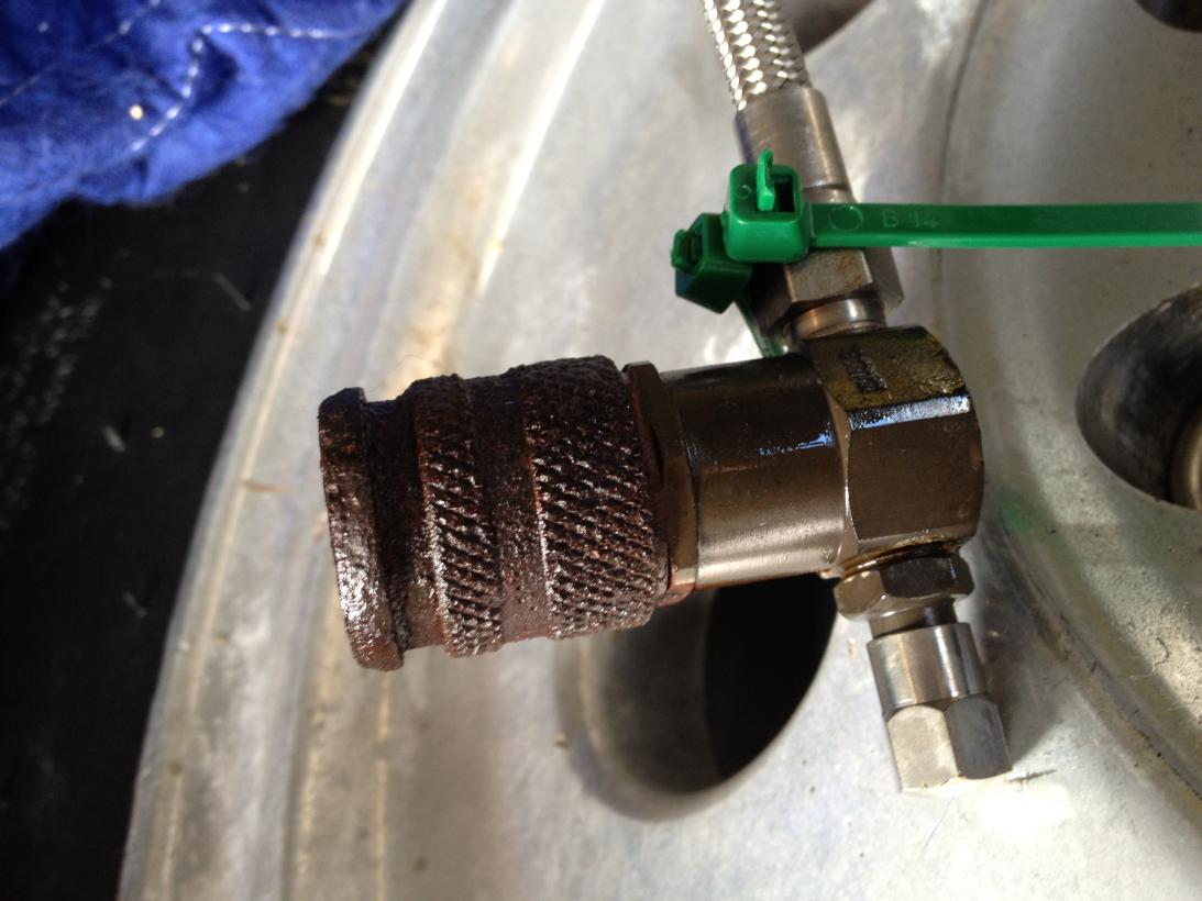

Another question guys.
Looking at the quick disconnect, it's all rusted solid. It doesn't look like the part 6005109. It looks like a quick disconnect from a air tool. Is that normal or just a different year?
The price of the 6005109 small disconnect is around $160 each!! Is there a kit or a way to put a tire fill nozzel right on the tire without using the long tube and quick disconnect? Is it possible to take a regular tire nozzel and a bushing, put together and get something to work so I can drive? I'll work on it when I get the coin.

Thanks Green 1. It going to be fun. I actually tried to isolate one of the tires by disconnecting it. The disconnect is completely different from everything I've seen anywhere. Nothing in the service manual. My disconnect looks just like a air tool disconnect. See below...
IMG_0459.jpgIT's all rusted and when I tried to get it off, they both went down quick. The seal on the rusted disconnect didn't seal at all. It looks like crap as you can see and can't be reused. Right now I will build a valve nozzle right on the wheel until I can get this fix somehow.
Does anyone know this kind of disconnect for the CTIS? I think it must be a aftermarket thing. If anyone sees a place to get these, PLEASE let me know!
