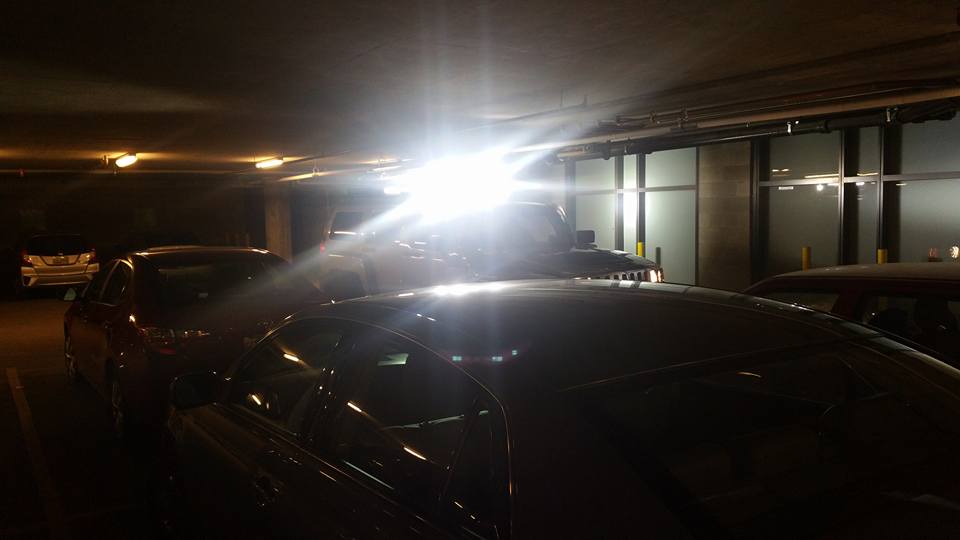

Front 32", side 13.5" and 4" corner lights up and wired.

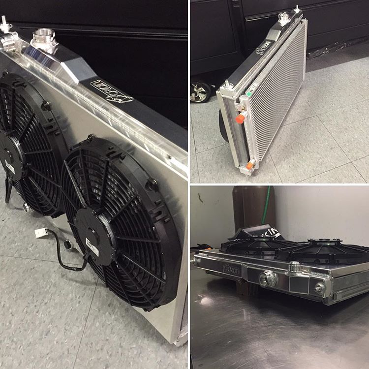

Frustrated with my cooling setup and AC still not being truly amazing I have resorted to getting professional help. 2x 12" puller fans with custom shroud, larger custom made radiator, condenser ready for a MAC truck and 2x pusher fans on the front side through a trans cooler. Attached is an idea of what it will look like. Custom cutting the front end and creating a new opening and mounts. Relocating the air bag sensors and horn out of the way.

From personal nightmare experience trying to cool a cammed ls3 in 125* weather:
1. The clutch fan pulls alot of air
2. Im running dual 12" 400 watt spal fans and they probably match the clutch fan or better (pull 60 amps together)
3. Running an aftemarket griffin rad. It leaves 4.2" gap to the engine and the fans are 4". As a result im running my setup shroudless and this isnt the optimum setup. May swap to a CSF rad that is thinner but will let me instal a shroud + will help with airflow as the griffin is 2.4" thick
4. Running a 16" spal pusher fan but its not the best in the market. Will upgrade the fan. A pusher fan if not matched to the puller will restrict airflow.
5. Truck still runs between 221 & 230* at peak temps!
Put all that aside, while doing one of the 6 setups I tried, I recal that the A/C condensor will work flawlessly with a really good pusher fan setup.
And, forget the truck sounding anything other than a jet fighter while cruising with windows down.
Good luck!

WOW!! So there is little to no hope in trying to keep the H3's cool in high temp weather?? I am pretty determined to find an ultimate solution and will post up pictures of this crazy cooling adventure I go on. The 1" body lift does open it up slightly more no? I have not installed yet the Run Cool Hood but another mate on here said he is seeing 40 deg cooler temps under hood on hot days like your using.. I would love to have some pusher fans connected to the underside of the louvers.

When I was running the 5.3, I had stock 2 pusher fans (an 11" and an 8") from the small powered spal fans. They probably give 500 cfm each bundled with the clutch fan. Highway was running 220* at 120* ambient. Sadly, I don't have more numbers as I never really monitored temps.
But the a/c was great.
The I5 I have doesn't have aux fans and apart from standing still for 15 mins un same weather the a/c is great.
GreatDaneHummer
994
Chicago
Last measurement I took was 88 degree's ambient with 51% humidity showing showing 166 degree under hood temp with 226 engine temp after 15 min of standing still in traffic. I am using the CSF radiator with a single 12" pusher fan at 2000 CFM* This is what it says, not very real I think. Maybe realistically its 1300 CFM. The AC is medium, not great but not horrible in this situation. First 2 min of driving then it starts blowing cold again, not amazing but it is cold. Factory OEM was ICE COLD. I don't just want my setup to be as good as OEM I want it to be good enough for a desert race car running a 700hp V8 at full throttle staying at factory normal temps blowing ICE cold hang meat freezer AC.
