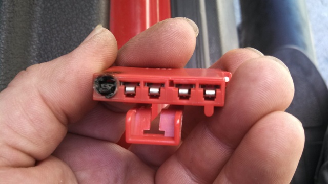

I thought I would add to this after my experience with this problem over the weekend.
Here is the location under the glove box
Here is the connector - melted and burnt out on one leg
Tools needed
Ready to crimp
Blower motor is back in business.
