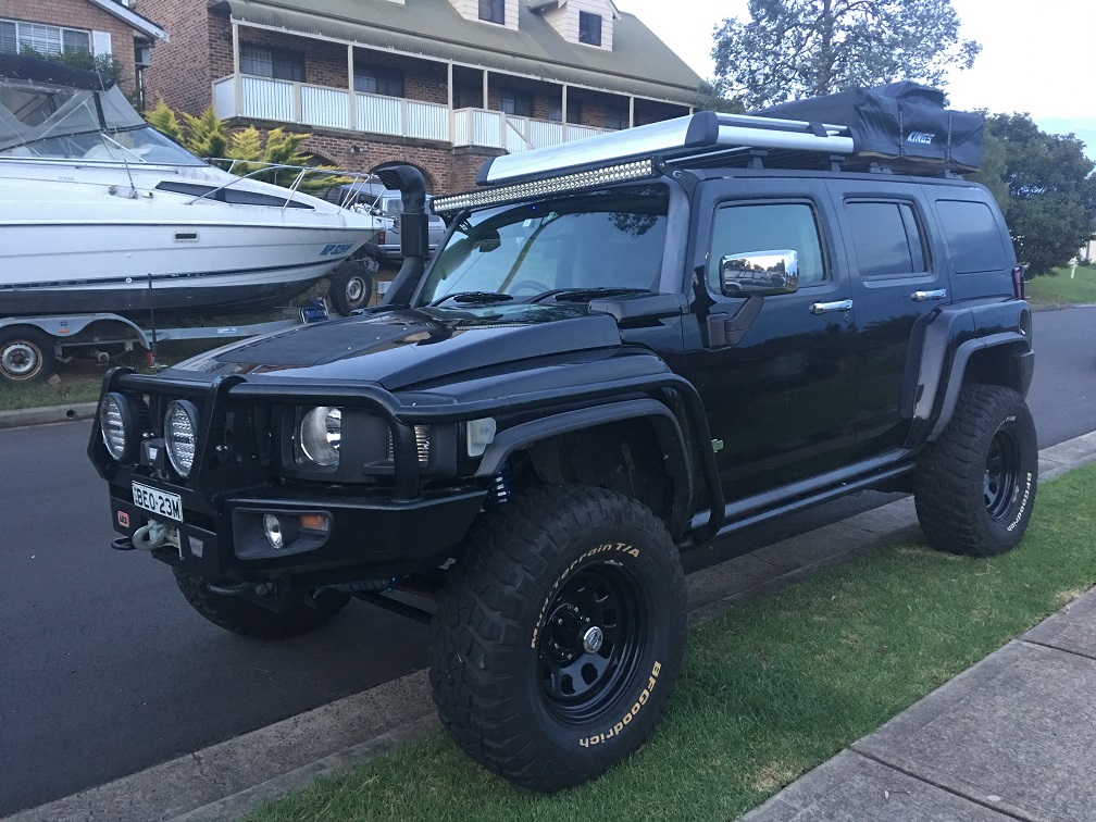

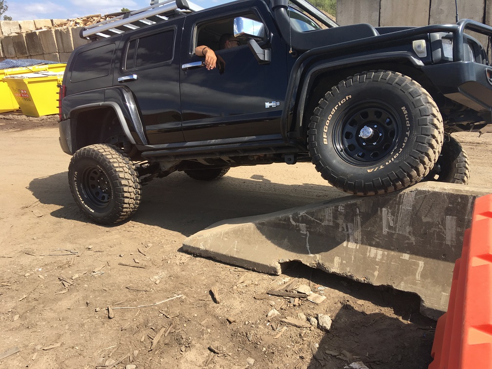

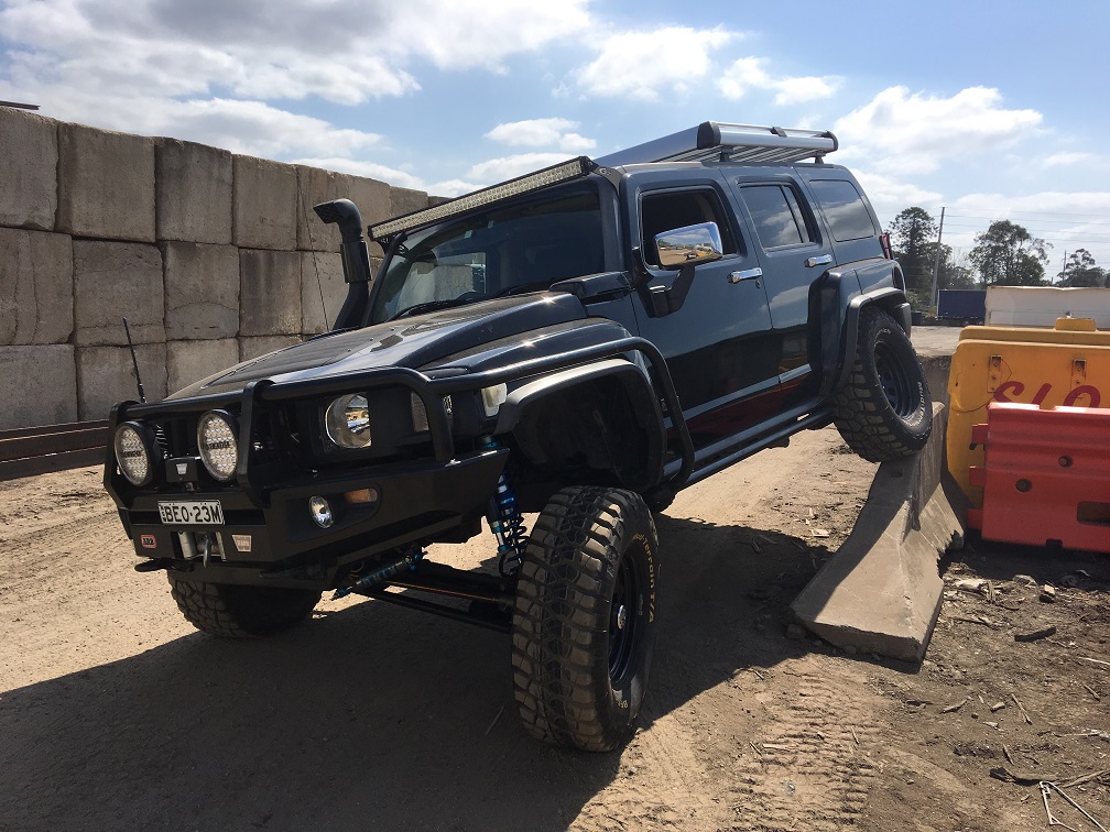

The radius arm SAS rig is up and running. Owner and builder are pretty happy with the results. Although not as flexy as a 3-link, it gets the job done. Shock & spring valving is good enough that they have decided to run without a front sway bar. The truck handles, and brakes very well but, still has enough travel to tackle most off-road obstacles they would encounter. Best of all...the front axle won't snap if you look at it wrong, and it now has gearing to work with larger tires. The 2" stretch on the front axle allows it to sit this low. This is possible in large part to using a Toyota steering box with a forward facing pitman arm. These pics are with 35" tires, and 37" are coming in the near future. The larger tires will probably require a height adjustment, so the SOA might be needed, along with a front coil-over adjustment. Here are some poser shots...
As predicted, this rig is all droop, and no up-travel. It has 5.13s, a 4:1 low, and retains all the factory traction aids. This "creeper package" more than makes up for the limited flex. Although these pics might seem extreme to the typical Hummer guy, this is a very mild build in the Jeep world. I have no idea what the KING reservoir is that is hanging down on the tie-rod in the last photo.

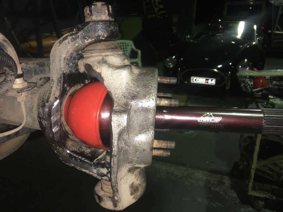

RCV shafts are anything but easy to install. Lots of cussing and grinding. (Notice this is the passenger-side knuckle and it has no steering arm...RH drive has all the steering backwards)...
Because RCV does not offer outer stubs in the stock 19-spline configuration, you must run their flanges or adapters (for Warn lock-outs)...both at additional cost...
Not bad for a low-sitting radius-arm rig. This truck still uses a spring-under rear axle. I guess that King shock is some sort of steering damper. Not sure I would put it on the drag-link but, I'm sure he has his reasons. These guys building this are NOT dumb-asses. Very nice work...

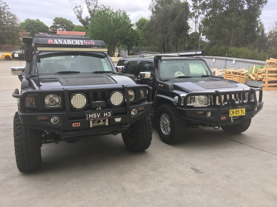

Here is a pic next to a stock-ish H3...

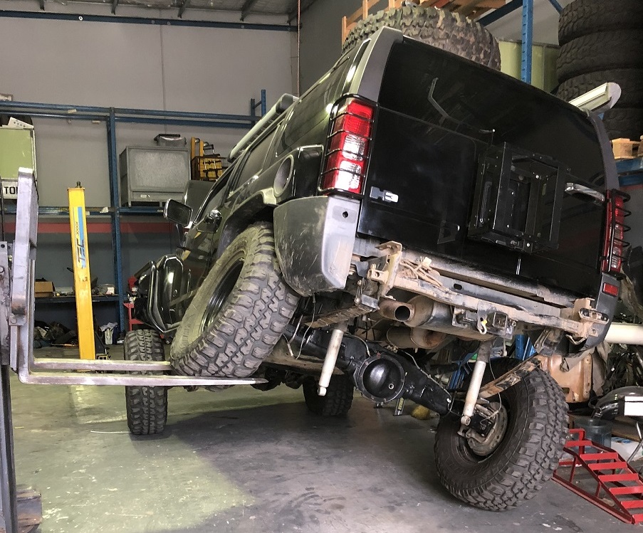

Got an email the other day from down under. The owner bent the rear axle housing which caused one of the rear axle shafts to break. This guy must really be pounding his H3!!! He ended up finding a stock replacement shaft in Australia but, I am trying to get some chromoly shafts made here in the states. Speak up if you are interested.
Because the axle housing needed repair, he decided to do the spring over and incorporate it into a truss. This will prevent any further issues. Here's a test flex photo...
