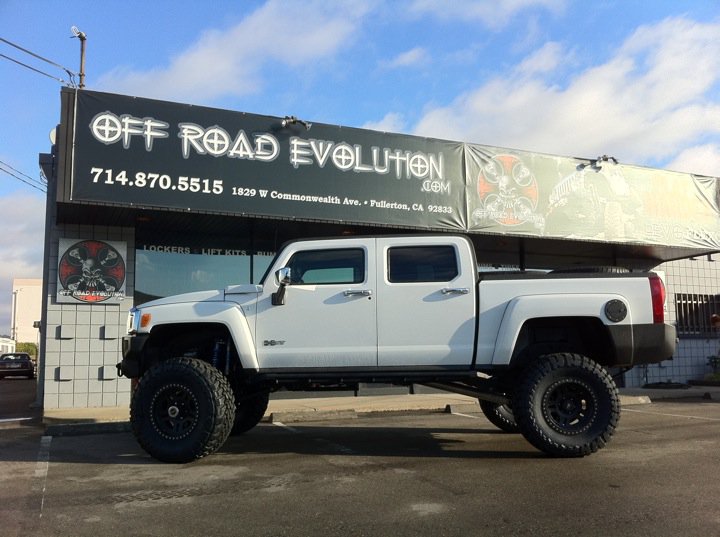

I have an '09 H3T that I have done a solid axle conversion to already.
Now it is time to beef up the rear Axle.
Because of the All wheel drive system I am told that I cannot just simply swap to a 14 bolt.

For your viewing pleasure.

I spoke with someone recently about the bigger axles and the main thing is getting a tone ring in there that matches the current axle setup and then use the factory sensor. Which can be done, it's just custom work but it still probably cheaper then dynatrac.
Could you snap some pics of the rear? I have done a spring over in the rear on mine and have a rancho lifted front and if I ever made the jump I was wondering what springs you were using or if you have the evolever setup

Those are the same guys that did Al's (ReconH3) H3. I had a picture of his H3 and that H3T getting worked on and the after.
