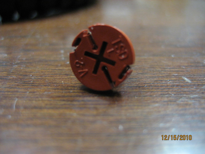

Was fortunate enough to get help from one of the hummmer enthusiasts ont there and the bulb replacement was prety straight forward.
the drivers module pulls up and out and the replacement bulbs are placed in from the back.

I can verify this is 100% correct. you need a thin screwdriver or a plastic panel remover (2 is better). There are 2 clips on the forward and back sides of the assembly. It's basically pop out. I ended up losing a clip in the door.
There's 3 little screw to open the assembly and then i gently pried it open. There are indeed 2 bulbs w/ blue rubberized kind of covers. you can easily pull the small neowedge style bulbs out out w/o solder or anything - you can just carefully twist with your fingers and pop out.
not my pic but the back looks like this:
