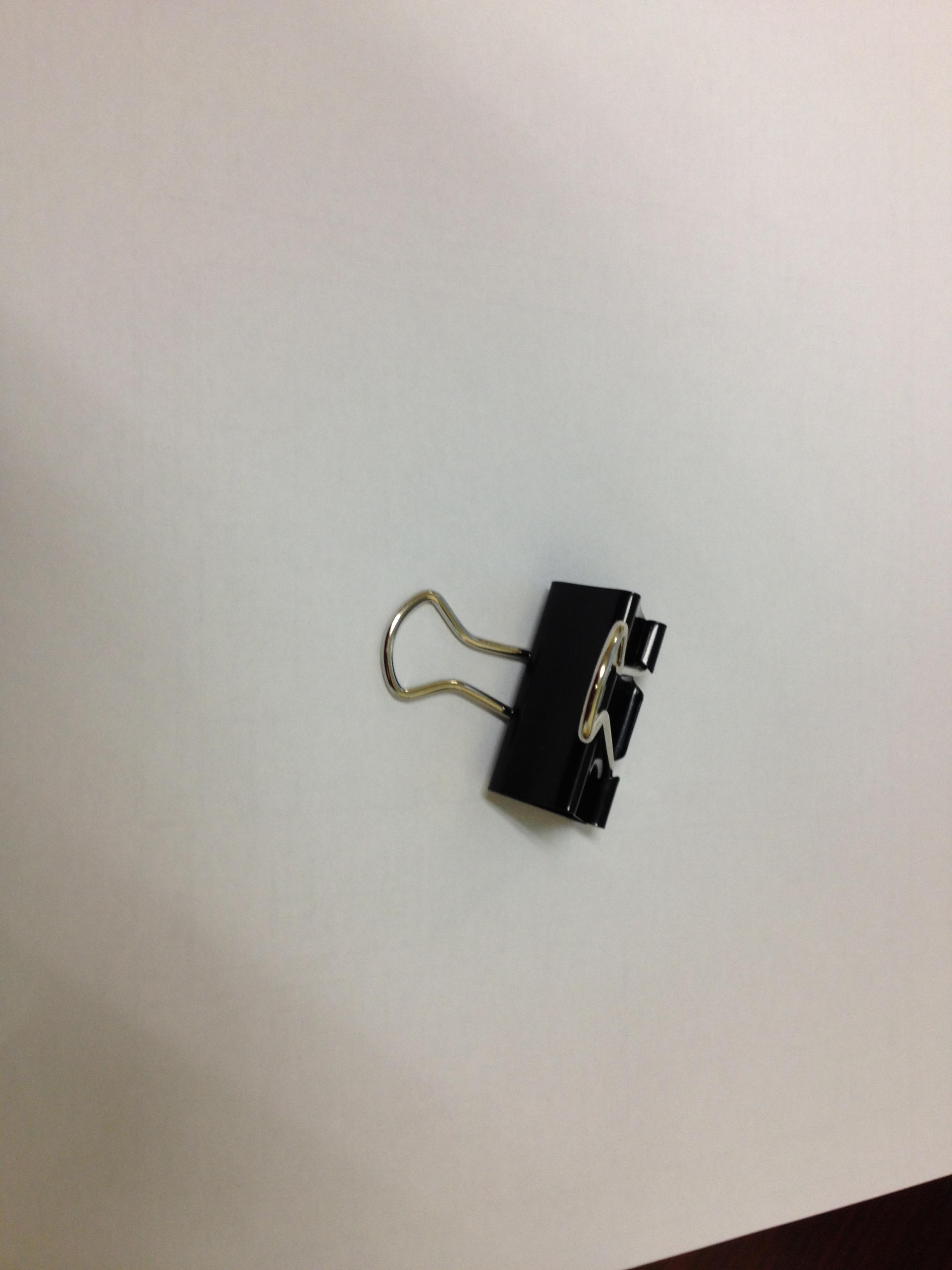

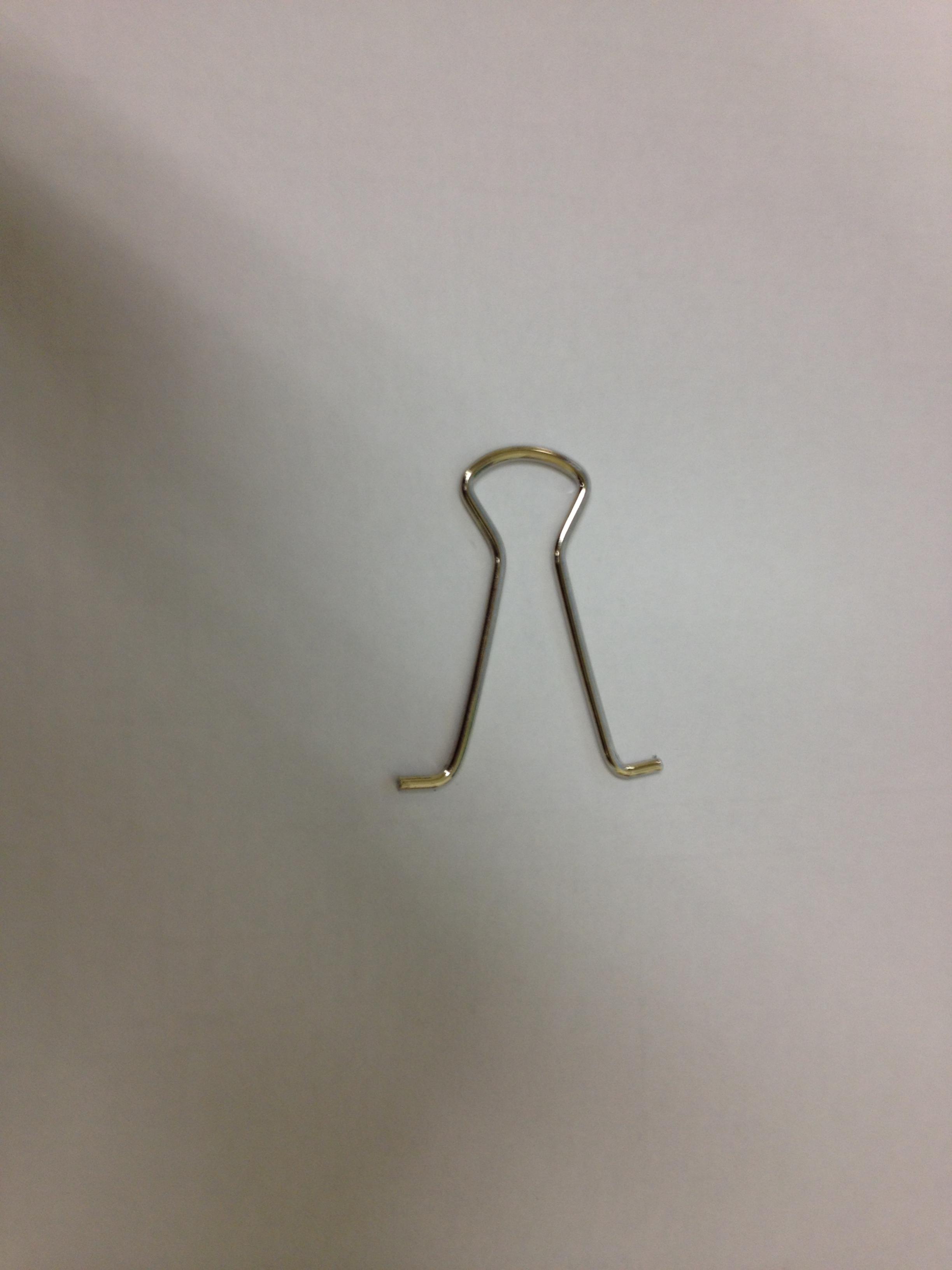

I did something a little different with mine, the shift button popped out after I was rear ended, the shop that fixed my truck gave me an 08 shift handle, which is really nice, but does not directly fit the 05, so until I could come up with a good secure solution to mount the 08 handle on the 05, I took the shift button and one of those black metal binder clips you find in an office and used the chrome part of the clip. I epoxied the clip inside the shift button and when the button is inserted into the shifter the metal clip grabs the retainer tab and holds it in place. I don't have any pictures, but this is the binder clip I used, its a size 5.
