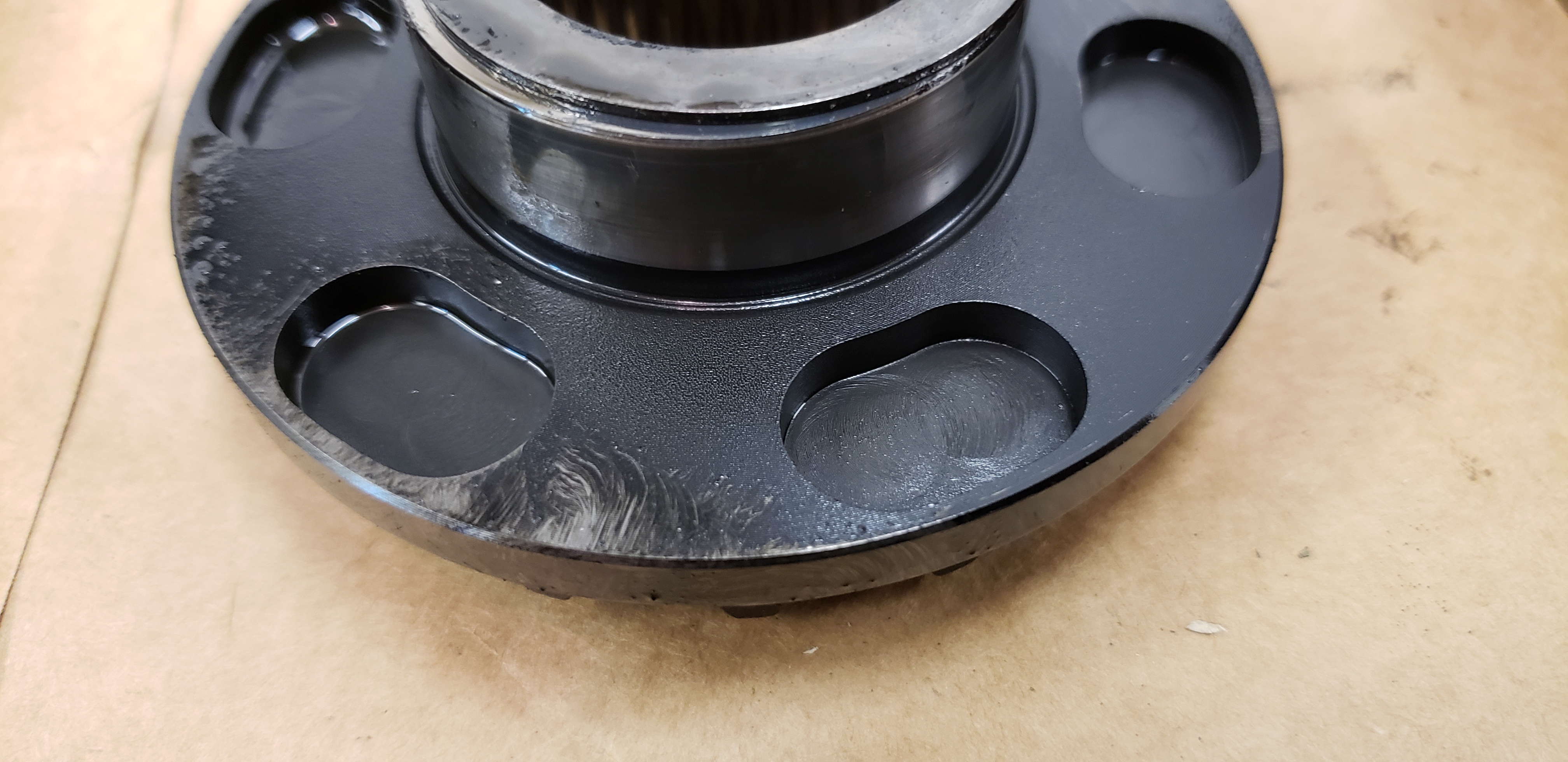

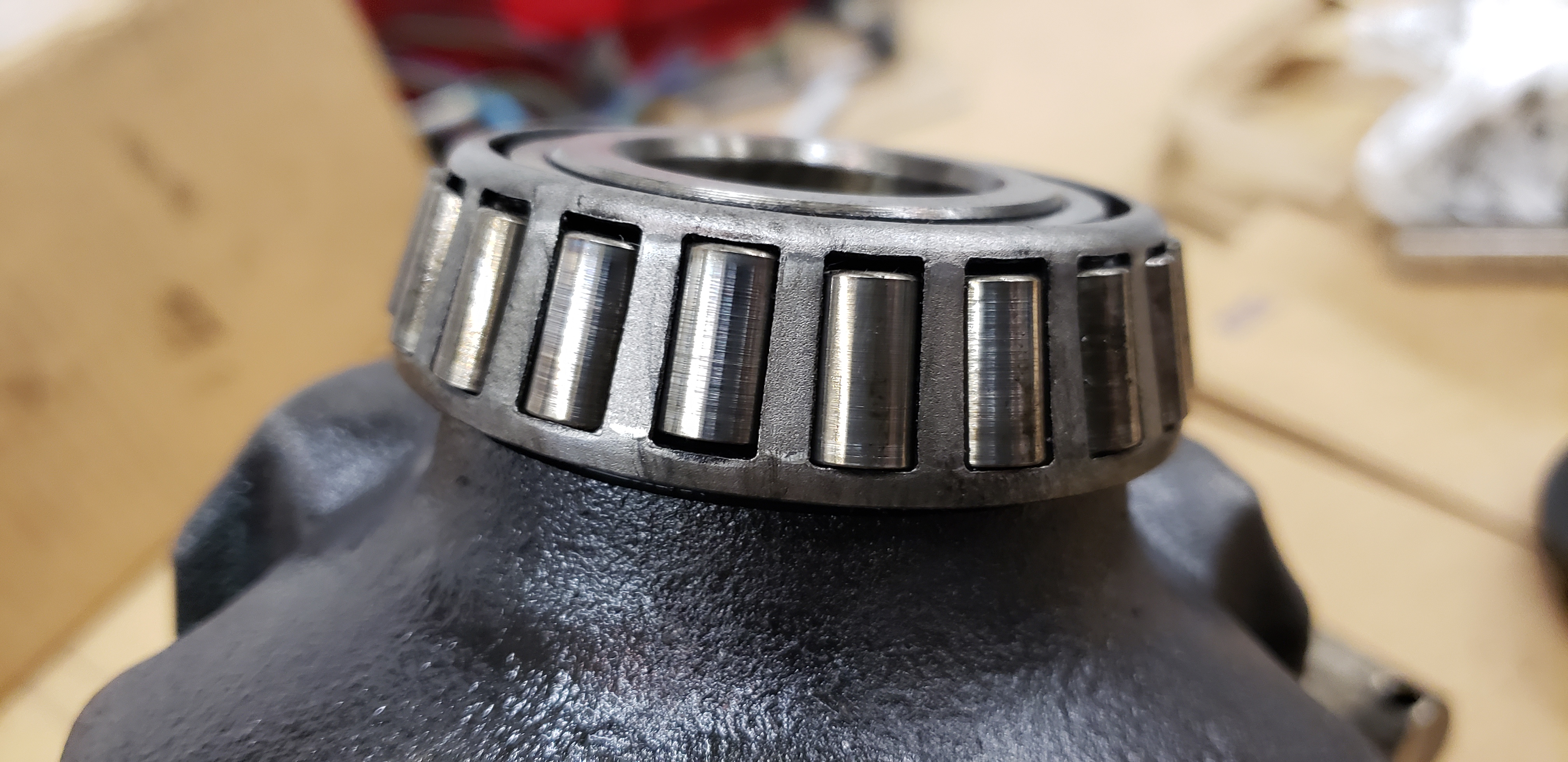

I was able to get the locker apart, looks really clean inside. I might go so far as to say that it had never been used until I tested it. You can see slight fresh marks in the oil in the slots. Gears all look good as well. I am debating on replacing the bearings before swapping it into the new housing. I am trying to minimize downtime or the opportunity for something to go wrong during the install during the summer.
Anything else I should check while I am in here? How hard is the bearing install without special tools? I have a press but no special adapters. What is a good bearing/race to use? I see timken LM603012/603049 referenced in another thread.
10,677
That's great news - those locker pieces look great. If you're going through the trouble of replacing those bearings and races (you have the correct numbers), you may want to consider the pinion bearings and the various seals. But also, if it's in good shape, do you need to replace those bearings? I would replace pinion and outer axle seals.
But please take my comments with a grain of salt. I haven't done these rebuilds myself and I'm certainly not an expert on this topic.

200k on the bearings, right? Definitely replace them since you have it out anyway. The locker itself looks like it was never used so that is good. But the bearings will have worn enough by this point to warrant replacement. They are cheap enough as well that it just makes sense to have the peace of mind. It'd suck to get it all in and then 10k down the road have one of them fail.
